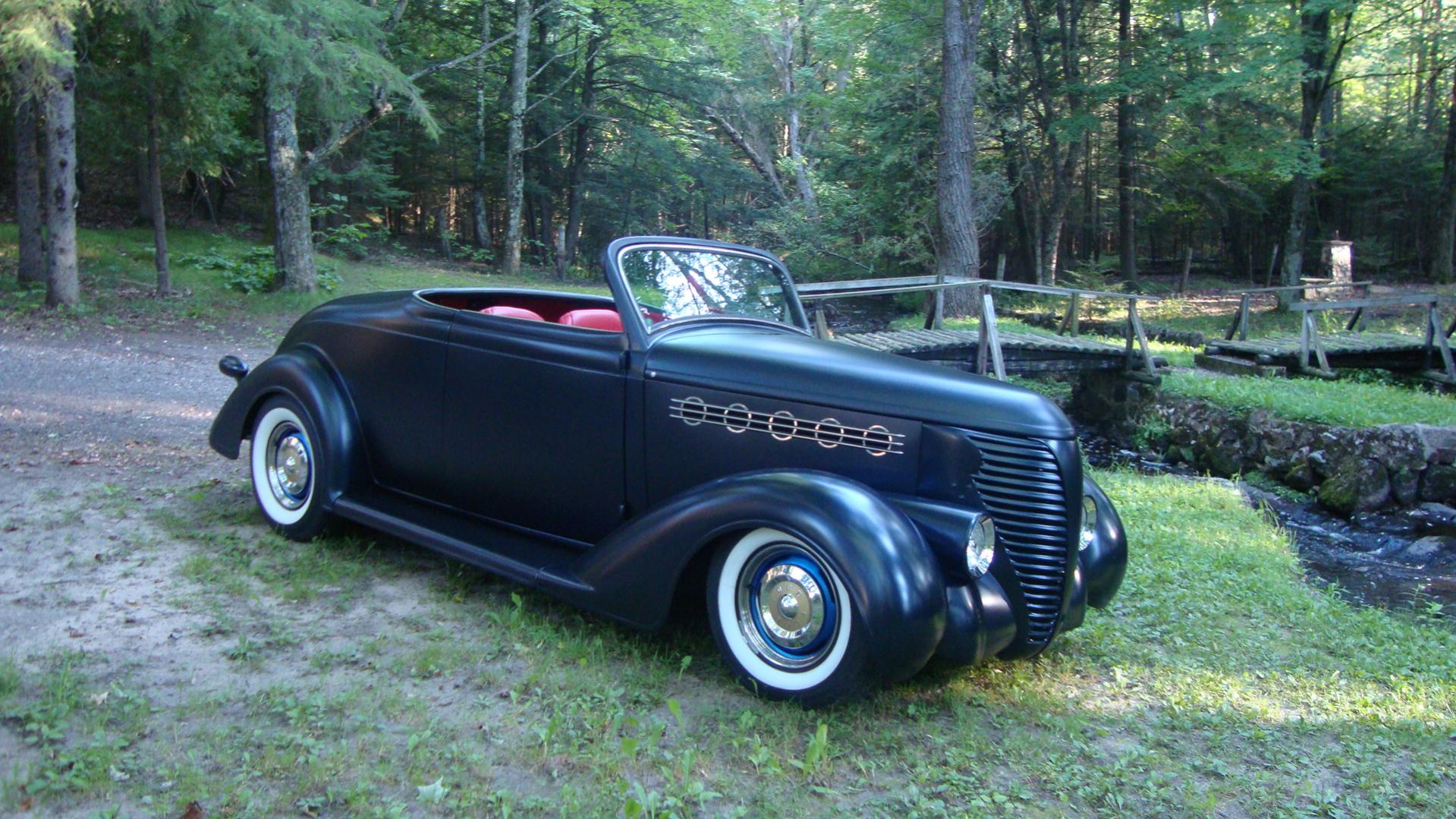

  12. Here's a newer version of suede on my plymouth:: sikens basecoat with satin clear. Looks great, easy to keep clean and won't stain...........

    Very nice - I wonder if I can get it in CA :confused:
