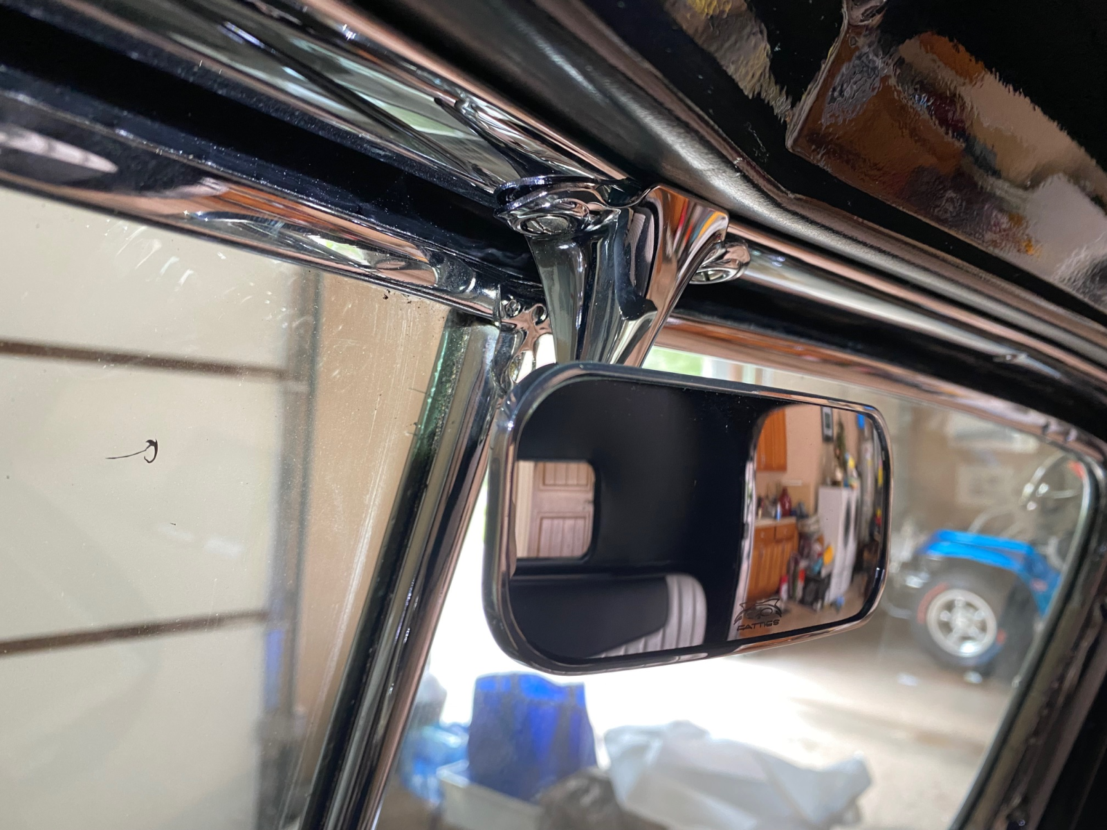

    At this point I’m contemplating these ******s :p:D
    I took the car on a 4 hour drive today and it was a mix of highway and country roads .
    you can barely see anything out of the rear view and the clip on peep mirrors are utterly useless .
    I was reading up on the swannecks and heard different lengths are better than others but no one specified what length is best .
    such a pain trying to navigate traffic , with it being a 4 door and the doors are short even turning your head only gets you a bit better view

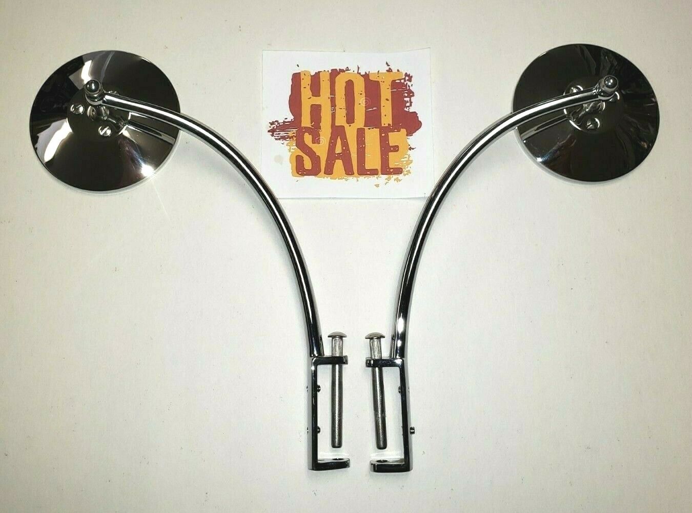

  7. The cowl mount mirrors ****. Like Fordy said, you can't even see the p***enger side and the drivers side is barely usable. I had a set on my avatar when I got it, couldn't wait to get rid of 'em. Pretty much useless. Buy a set of these...
    Amazon.com: Hot Rod 4" Polished Stainless Steel Swan Neck Mirror Set : Automotive
    Yeah, you'll have to bite the bullet and drill a couple of holes in the doors but these you can actually see in them on both sides. You won't regret it....

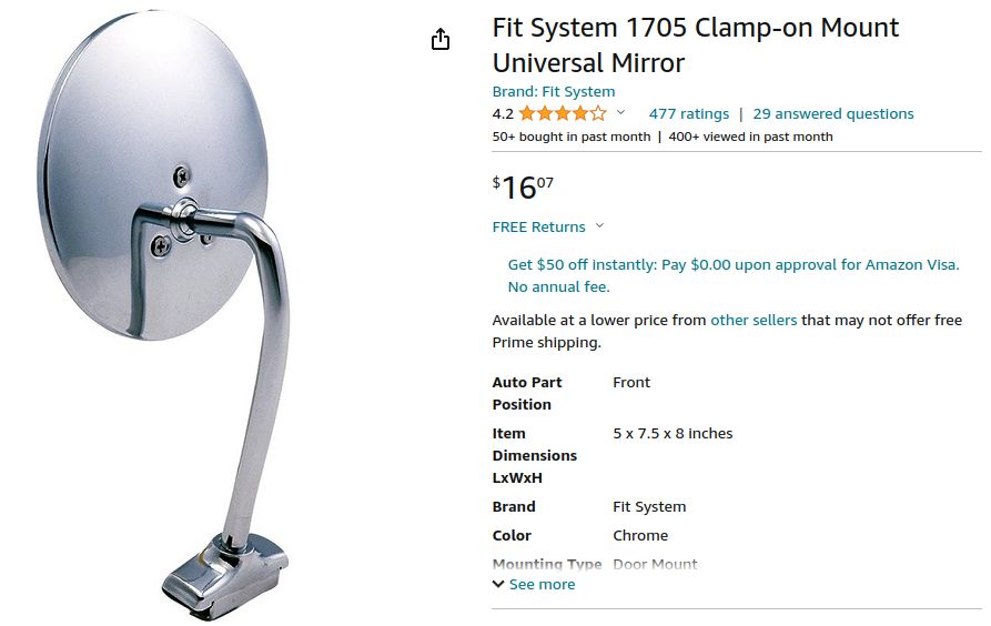

    This clamp-on style has been around a long time and works well. No holes but hold the door lip very well. Still have 2 pairs in use on my 38 ford & 300K. Originally got them from Warshawsky's for a lot less money a long time ago.

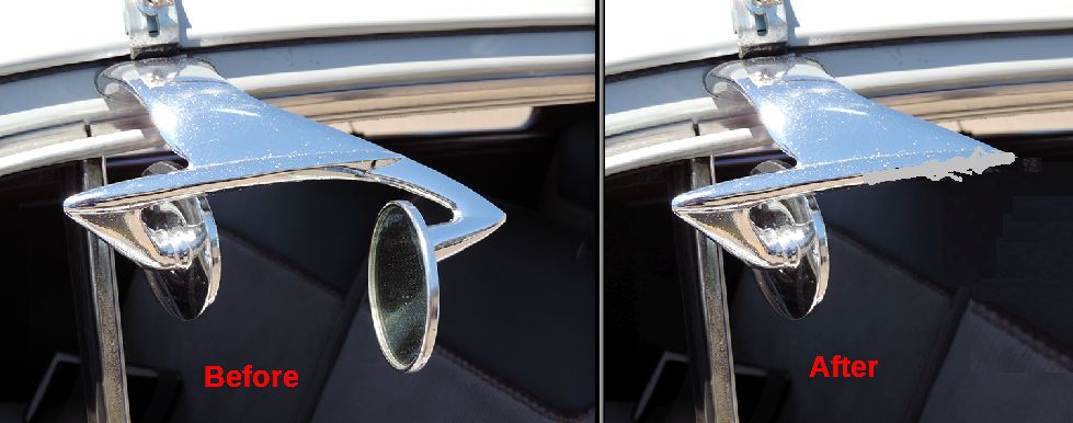

    Before & after shots of P***ingEyes on two similarly equipped vehicles p***ing each other in opposite directions on the narrow 2-lane BelvidereNJ free bridge.

  26. I feel I should mention that these are virtually the same mirrors being sold by Drake, Speedway, etc, just at a better price. When I bought mine off eBay, Drake wanted 3X the money for the exact same set. So don't be scared by the low price, these are quality items. The mirror head is polished stainless, the swan neck arm is chromed die cast with an excellent finish.
    I had more trouble tracking down the '47-specific cowl trim to fill the gap left by the removal of the cowl mounted mirrors than anything else. The Hagens look nice, but I don't see them as 5X nicer and that square mounting base looks a bit too industrial for my taste...

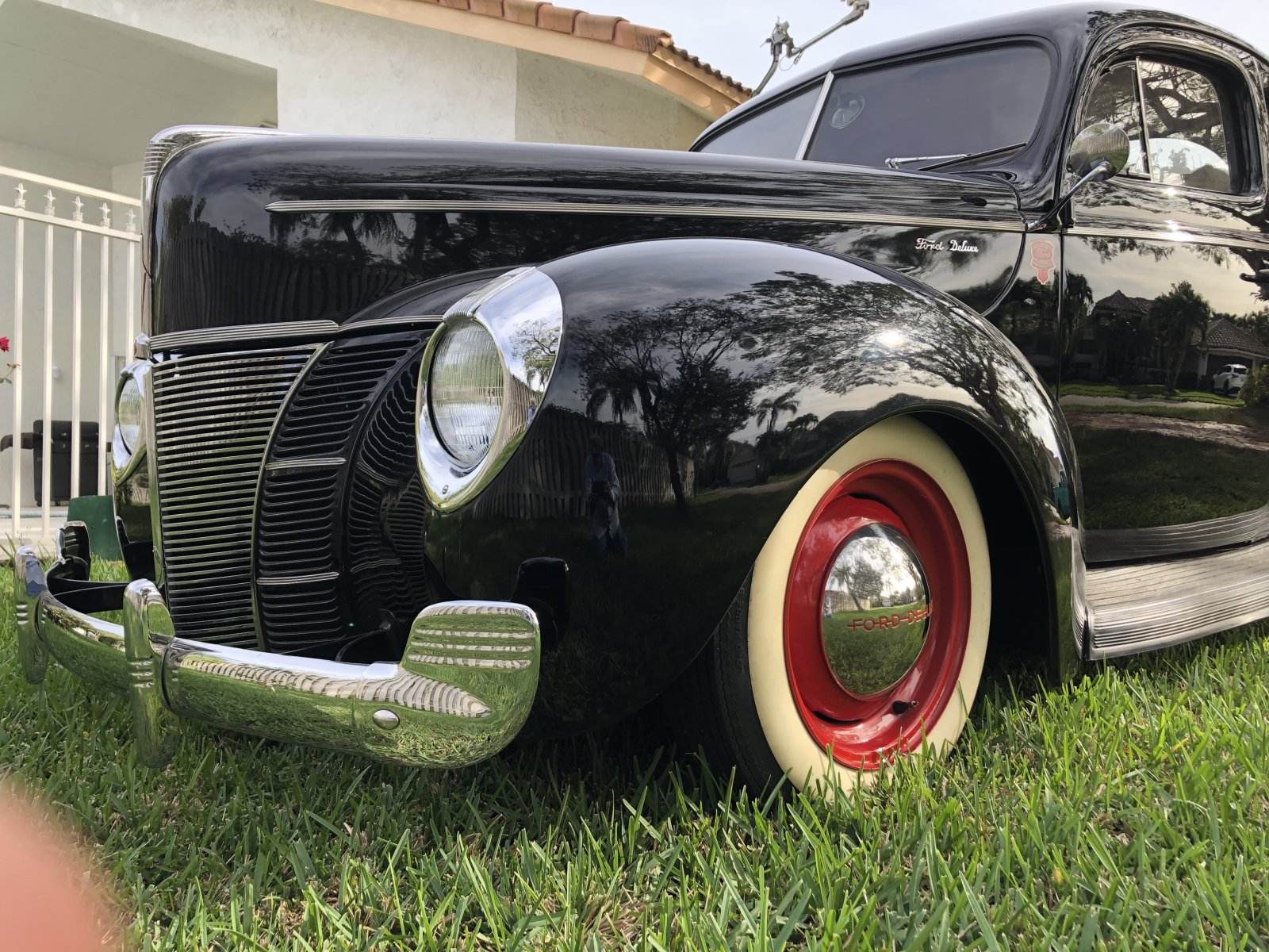

  28. Boy VP you know how to stir things up. I feel I need to point out you don’t live anywhere near the west coast. Before you do that maybe some sort of fender mount, not traditional, not beautiful, but not west coast style ugly, a new sort of ugly. These were not as bad as the tripod mounted ones. 584CAF96-B414-4BD9-A71D-9B9340B318C4.jpeg
