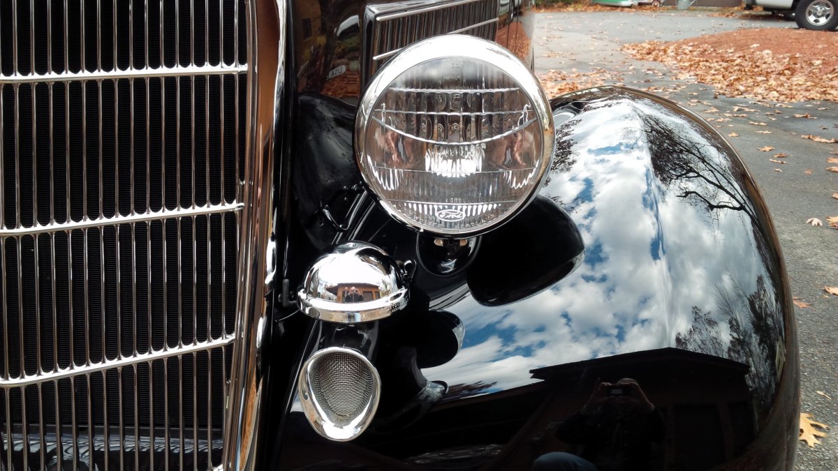

    1936 had horn grilles. 1935 had the horns exposed. My horns will be under the hood. That's a good idea though.

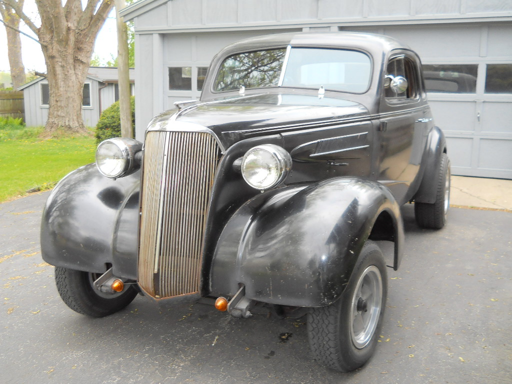

  14. ...used small truck clearance lites on my 37...
    Do it Over likes this.

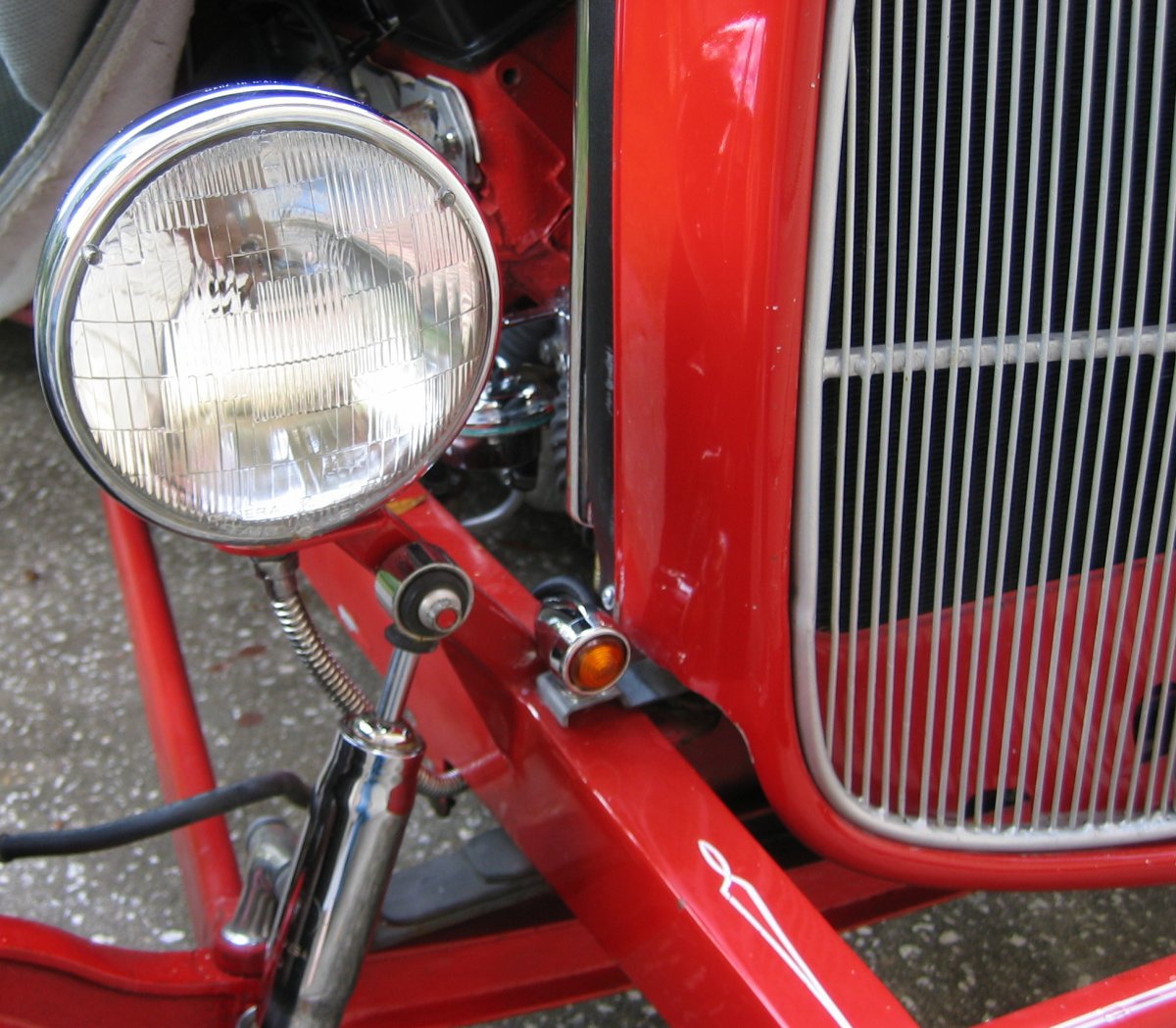

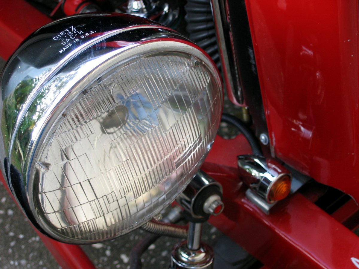

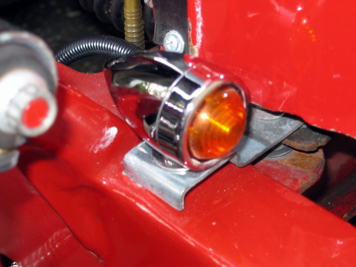

    I used these as I don't go to swap meets anymore to get the old original similar style.
    Drag Specialties accessories from a Harley shop.
    They are small, LED but don't look it and are brighter and fit the car better than the square"street rod" lights that were on it IMG_0646.JPG IMG_0645.JPG IMG_0644.JPG

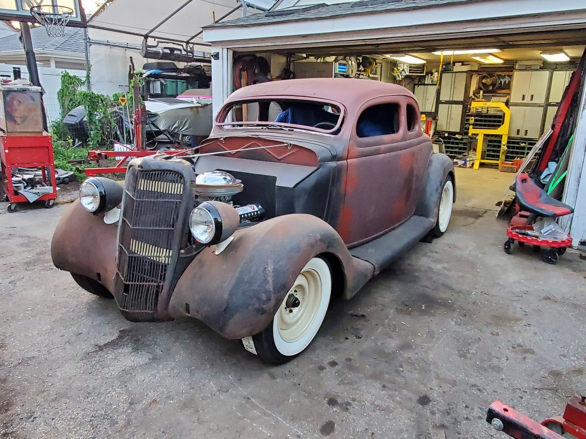

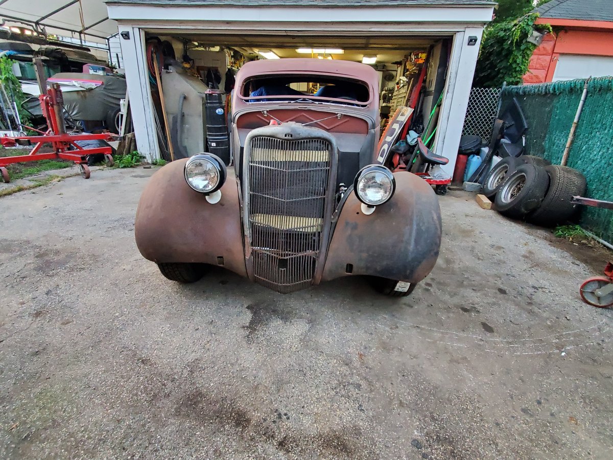

  20. How about a picture of your car (especially from the front)?

  22. Do it Over
    Joined: Dec 25, 2017
    Posts: 478
    Do it Over
    from NYC, NY
    1935streetrod and reagen like this.

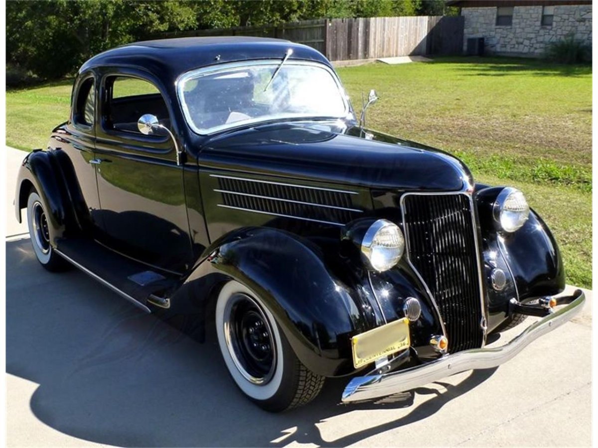

    I'd adapt the 36 horn grills or the other lights...both in this pic.
    If you won't be using bumpers, maybe lights in those bracket holes with 36 grilles? 14173938-1936-ford-coupe-std.jpg
