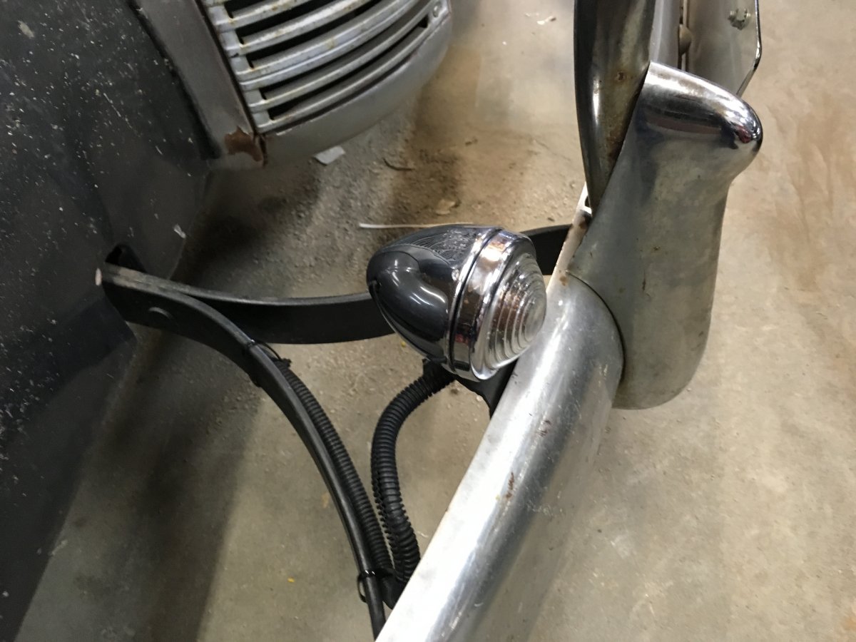

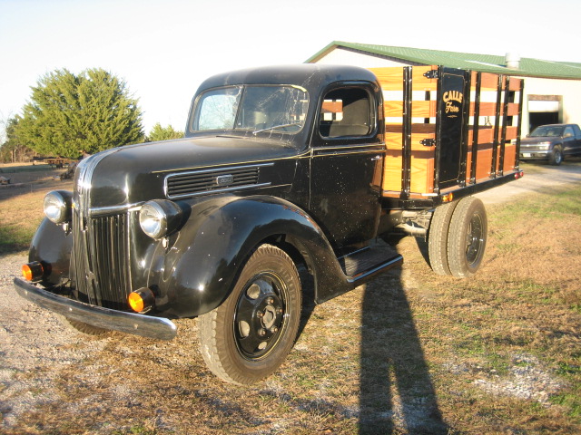

    Here are some Ford factory park lights on a 41 1.5 ton. Fit into the head light stands and we bought new ones from a supplier ( Mac's, Drake, ???). Easy to make into t/s.
    Do it Over and Jim Bouchard like this.

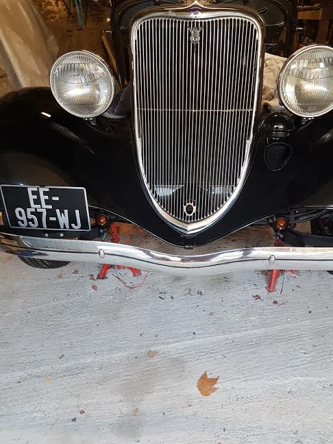

    Here is my '33 with little black ones I found on EBAY.Made brackets that attach to the bumper bkts.

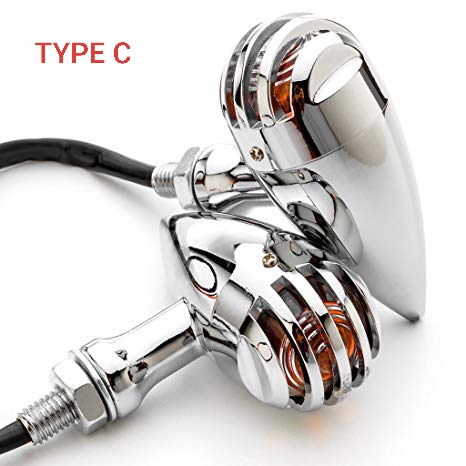

    I've been considering these three new options until I can get proper Guide B 31 lights. I'm thinking Type B .

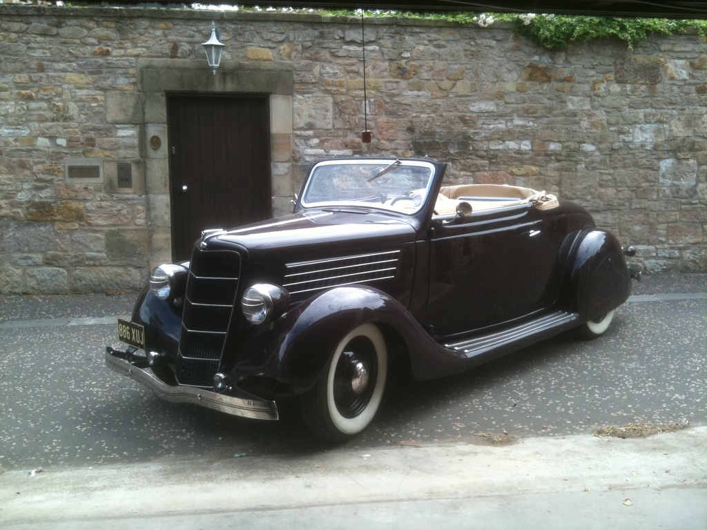

  11. I added the lens from BLC 904 lights to my stock '35 headlight buckets. I used the LED version of a #94 bulb and they are pretty bright. For the most part I worry more about the guy behind me.

    Good choice in B ,type C is plain butt ugly.

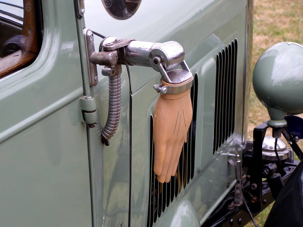

  14. Interesting ideas, I have some problems with my electrical working and use hand signals, people wave at me and have no idea what hand signals mean. I am living dangerously!

  21. Those 904 park light lens are kinda scarce; they were originally held in the headlight bucket with a steel garter spring which rusts away and the lens falls out. I made some molds of an original glass lens and cast the ones on my car out of resin.
