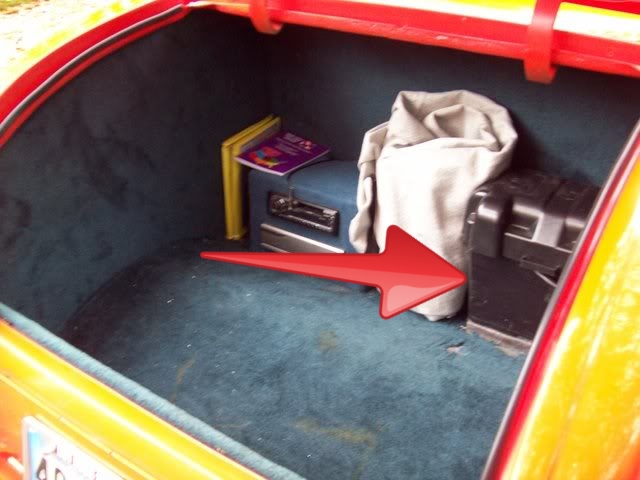

    I've had a battery in the trunk in my car for 48 years and have never had an issue. The battery is in a marine style plastic battery box. I have also placed an acid absorbing blanket under the battery inside the box in case it does leak. No acid odor or corrosion of any kind. Hope this helps.
