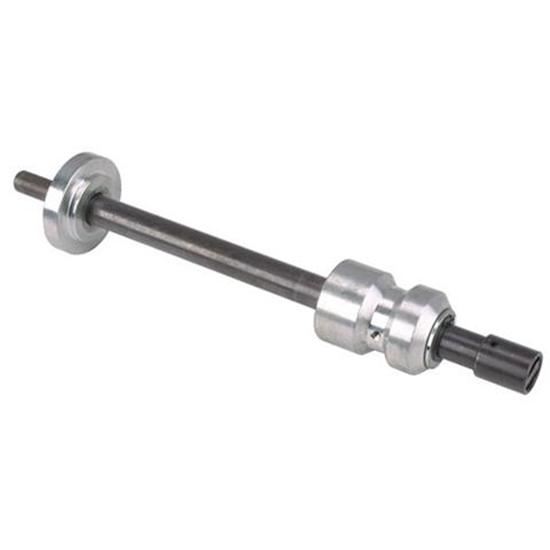

    The title pretty much says it all, don’t have an old dizzy to cut down unfortunately

    Get the one with the bushing spacer so the oil goes to the right spots

    Thanks Don, I’ve seen posts where guys have used a cheap ones and it didn’t lube both sides of the engine.

    Thanks @ wheeltramp, I guess as long as it has those collars they work properly.
    Big difference in price between Speedway brand and ARP brand, any different between them if they have the collars ?

    Tool with collar , amazon $11.99 , jegs $15 , eBay $21 , summit , basically
    &12-$50 depending on where you shop , or , what's a scrap yard get for an old distributor ?

    Thanks I’m thinking of getting the Proform 66896 about $22
    First I’ll try to find an old dizzy at a junk yard

    Any piece of steel that's over a foot long, and will fit in your drill chuck, that you can grind the end to a flat shape, will work. It won't be perfect, but it'll get oil to the bearings.

    Thanks @squirrel, my concern is without the collar one side of the engine won’t get oiled.

    one of the lifter gallerys won't get oil, but the bearings will. I used an old long screwdriver blade for years for priming engines before I made one from an old distributor.
    If you're really worried about it, get a distributor and cut it up.

    If you have a junk distributor, you can take the drive gear off of it and weld a stud to the rotor end. Chuck it up in a drill and go.
