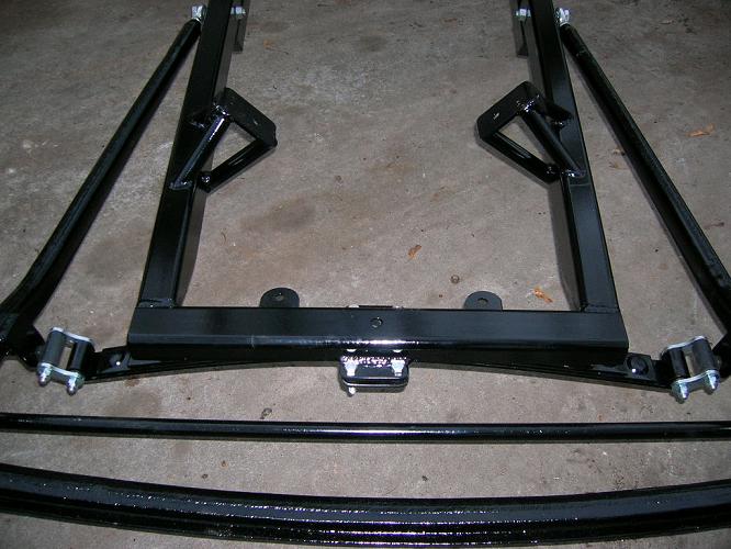

    the term suicide suspension meand that the front axle is hung out in front of the car with no frame over the top of it. If the spring of hanger breaks, your frame etc. eats pavement. The way your talking you want to do a spring behind axle setup with frame horns. I would build a flat channel front crossmember for an aftermarket reverse eye drop spring. Mount the spring hangers 3" or so behind the axle on the bottom side of the wishbone. You will have to make a relief notch in the frame horns where the axle will ride up in front of this new crossmember. Kind of like in this pic, but with the spring hangers mounted closer to the axle, and frame horns added. You will be able to heat and bend the arms so they fit below everything if needed.

    DollaBill that set up looks sweet nice engine mounts and all the speed holes kick ***.
    Rob Paul i'll probably build a setup similar to that
