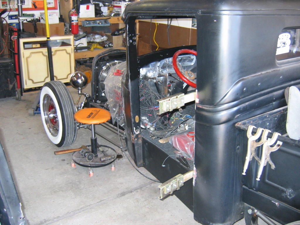

    Ya I got a reason. I have MS, my left leg and arm do not work. When I get into a vehicle with regular doors, my foot gets caught under it. I am probably the only one who suicided his doors for medical reasons, and I did it by myself with one arm!
    TheDevilsShip, Hombre and 302GMC like this.
