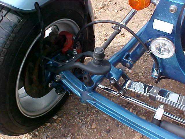

  15. alviso_jake
    Joined: Jul 24, 2007
    Posts: 9
    alviso_jake
    from nor•cal
    because no one will help him out...
    it shouldnt be this much of a conflict for someone to share a pic.
    we're all in the same scene guys. heres a shot for your i-beam request, i dont have a tube axle picture on me. sorry

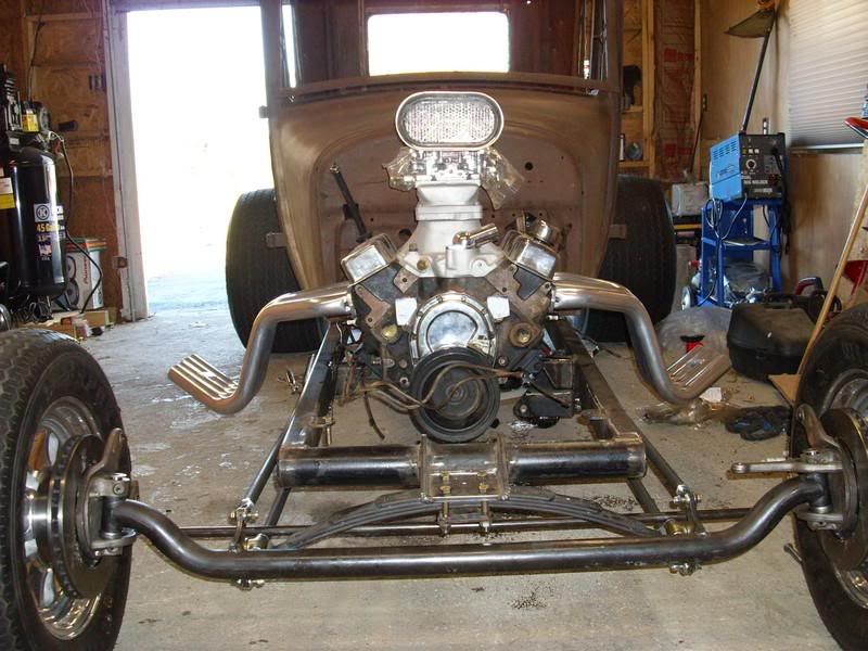

    Its not finished but its a pic. 4" drop, tierod behind, 47 split bones. more pics in my build. later [​IMG]

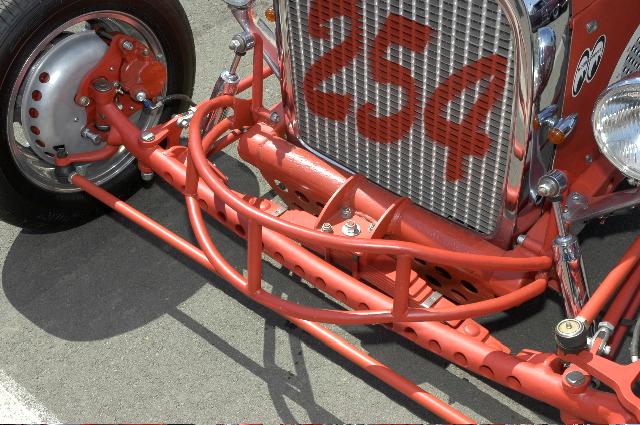

  27. Rootie Kazoootie
    Joined: Nov 27, 2006
    Posts: 8,130
    Rootie Kazoootie
    from Colorado
    Here's a couple of mine.
    Using a stock A axle and Posies 5 leaf, I have 7 in. from grd to the front tip of of the frame with 24 in. tires, the perch itself is 6" from the top of the crossmember to the top of the sprg. Made from 4 pcs. of 5/16 plate.

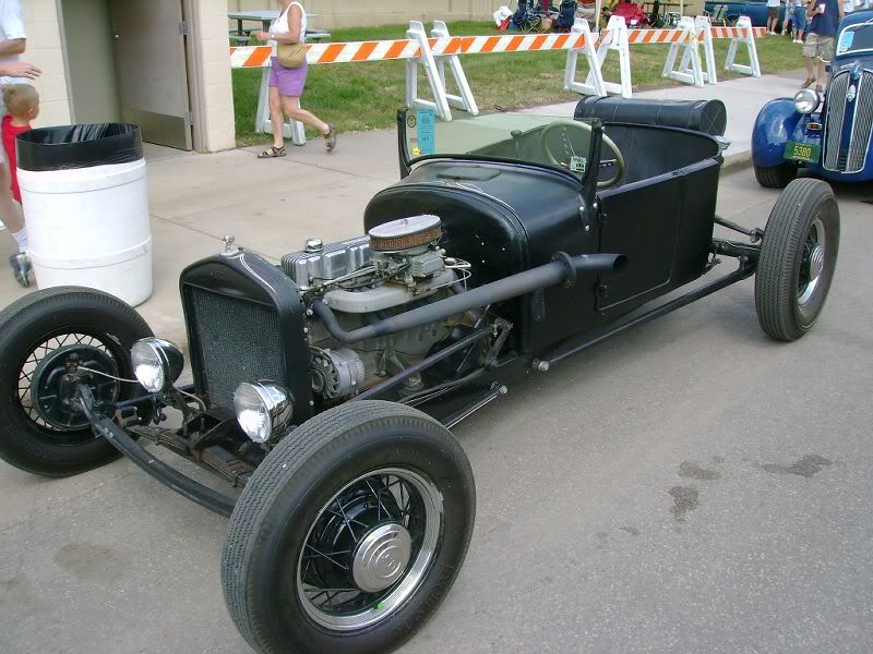

  29. Neophyte
    Joined: Mar 27, 2006
    Posts: 335
    Neophyte
    Sorry for getting a bit fired up at the guy and causing a stir. As you might have gathered I'm a bit fed up with guys who feel the need the police what questions are allowed to be asked.
    I was hoping to see pics other than the few I've collected over a period of MONTHS here on the HAMB and lost focus a bit. Here they are. Enjoy!
    These two are from a local T-Bucket:
