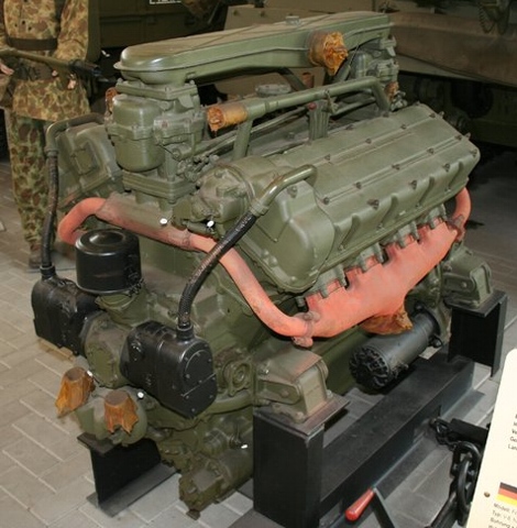

    What is a Truck Rod?
    This?
    What is a tank engine?
    This?
    This?
    or this??
