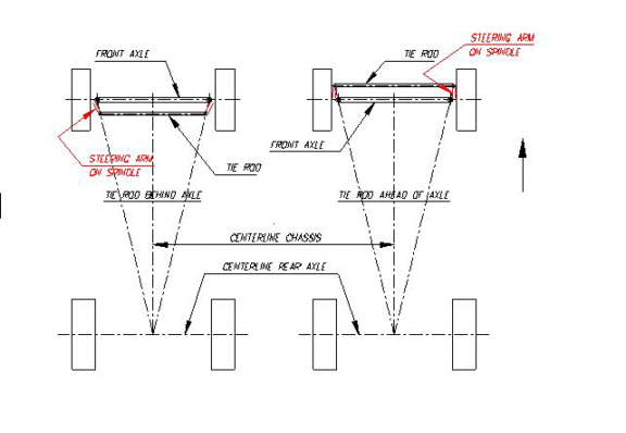

    You cannot ever get the Ackerman angle correct with a suicide setup using early Ford parts.

    I'm trying to figure out why not as long as the tie rod is behind the axle.

    Or the steering arms are bent outward to the lines if in front.

    Way before you get the arms bent to where the tie rod hole out to where it needs to be, you will have hit the backing plate.

    Probably, but I typically use disks, but I still dont understand how you say that about suicide mounts. I have built plenty of suicide mounts that ackerman was dead on.

    It can't be, or we're talking about two different things. If your tie rod is in the rear, it will work. If it is in the front, it won't. On a Model A ch***is, even with the stock wheelbase, the tie rod pivot would have to be out near the outside edge of the brake shoe to meet the specification.

    Let me try to put a stop to this. All gimpy left out was (and the tie rod in front of the axle) I can agree with that because the backing plates would be in the way of the steering arms being bent out enough.

    I always thought a suicide front end has the tie rod in front of the axel. When the tie rod is behind the axel its not a suicide front end.

    That was how I was to understand a suicide front end. Spring behind the axle. Steering arms in front of the axle look horrendous, drive horrendous and just do not work right. I know tons of T buckets have them but i cant stand them.

    I ended up doing it to avoid bending the arms and ending up with a pile of junk. It works fine, and it's not wrong, it's just different ( like guys with ear rings).
