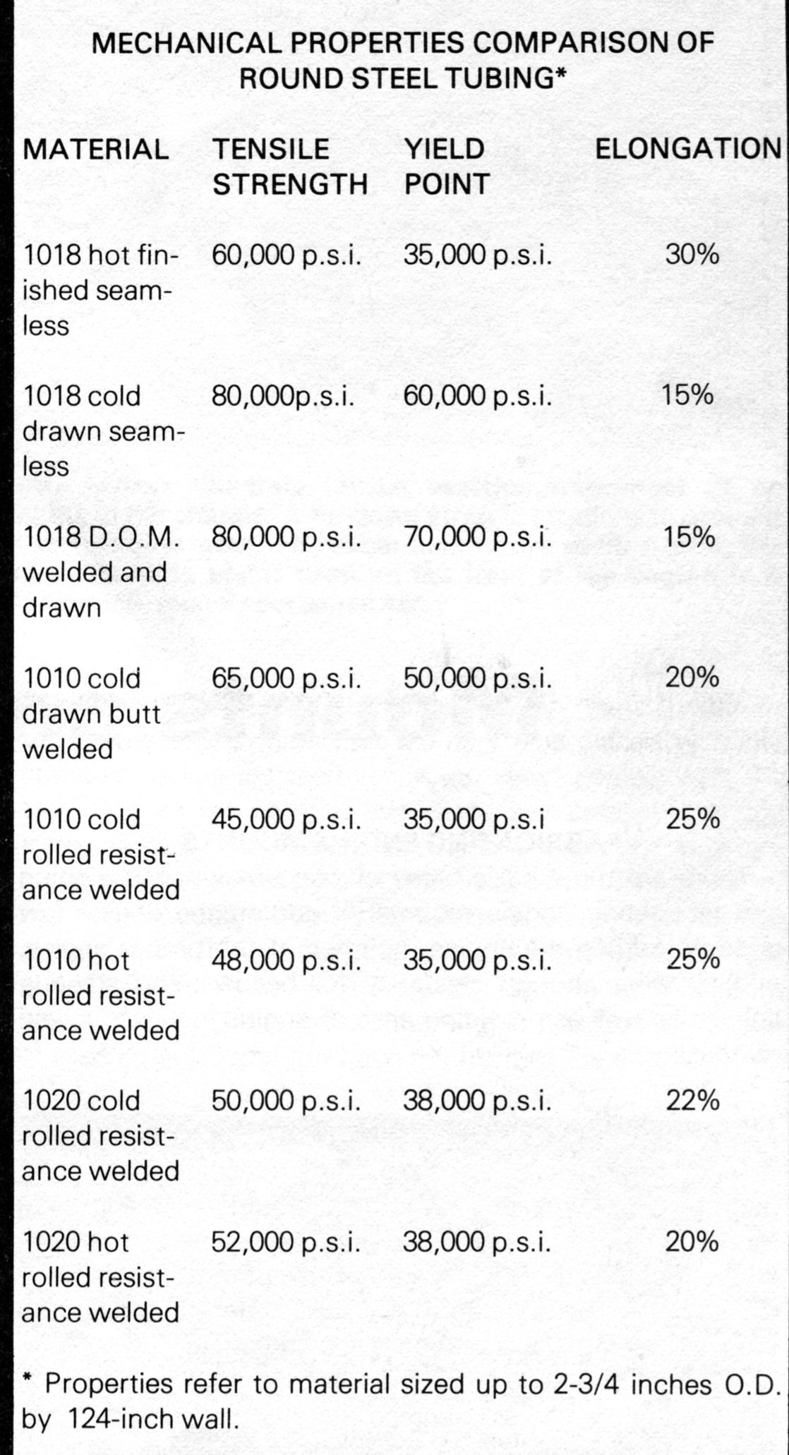

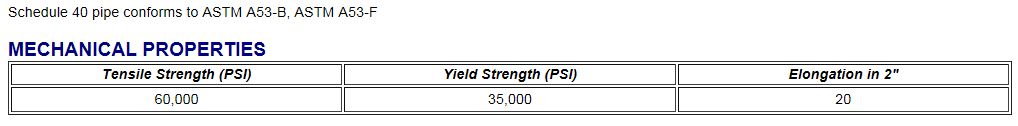

  3. gimpyshotrods
    Joined: May 20, 2009
    Posts: 24,538
    gimpyshotrods
    Okay:
    D.O.M.:
    TS: 80Kpsi
    YS: 70Kpsi
    Pipe:
    TS: 60Kpsi
    YS: 35Kpsi
    1/2 the yield strength. Enough said.

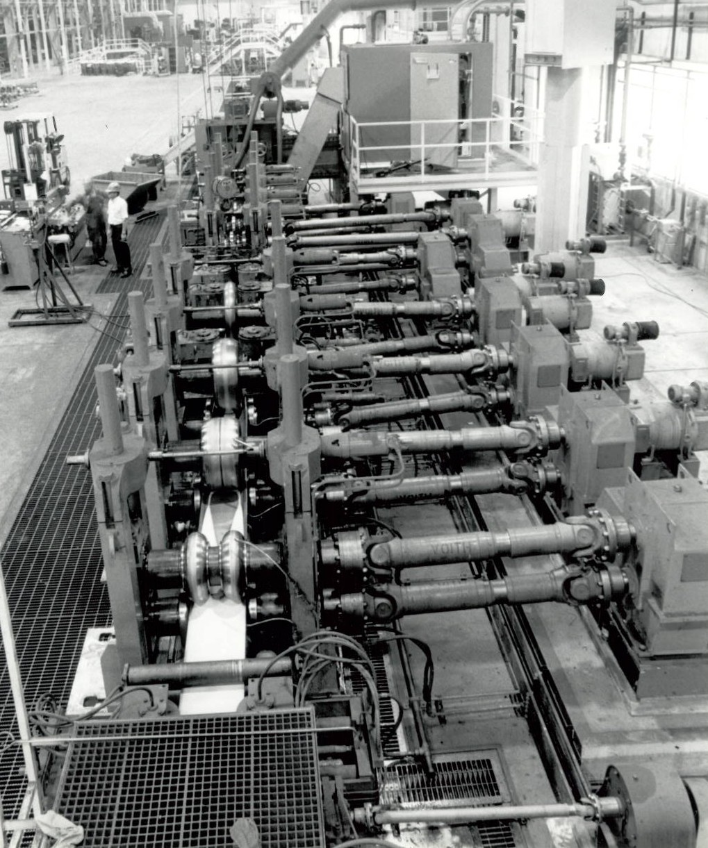

  8. Rootie Kazoootie
    Joined: Nov 27, 2006
    Posts: 8,130
    Rootie Kazoootie
    from Colorado
    FWIW- a couple more. If you've ever wondered how pipe/tube is formed, the first pic shows the decending series of rollers the flat stock goes through to turn it into a tube. The second shows how true seamless tube/pipe is made.
