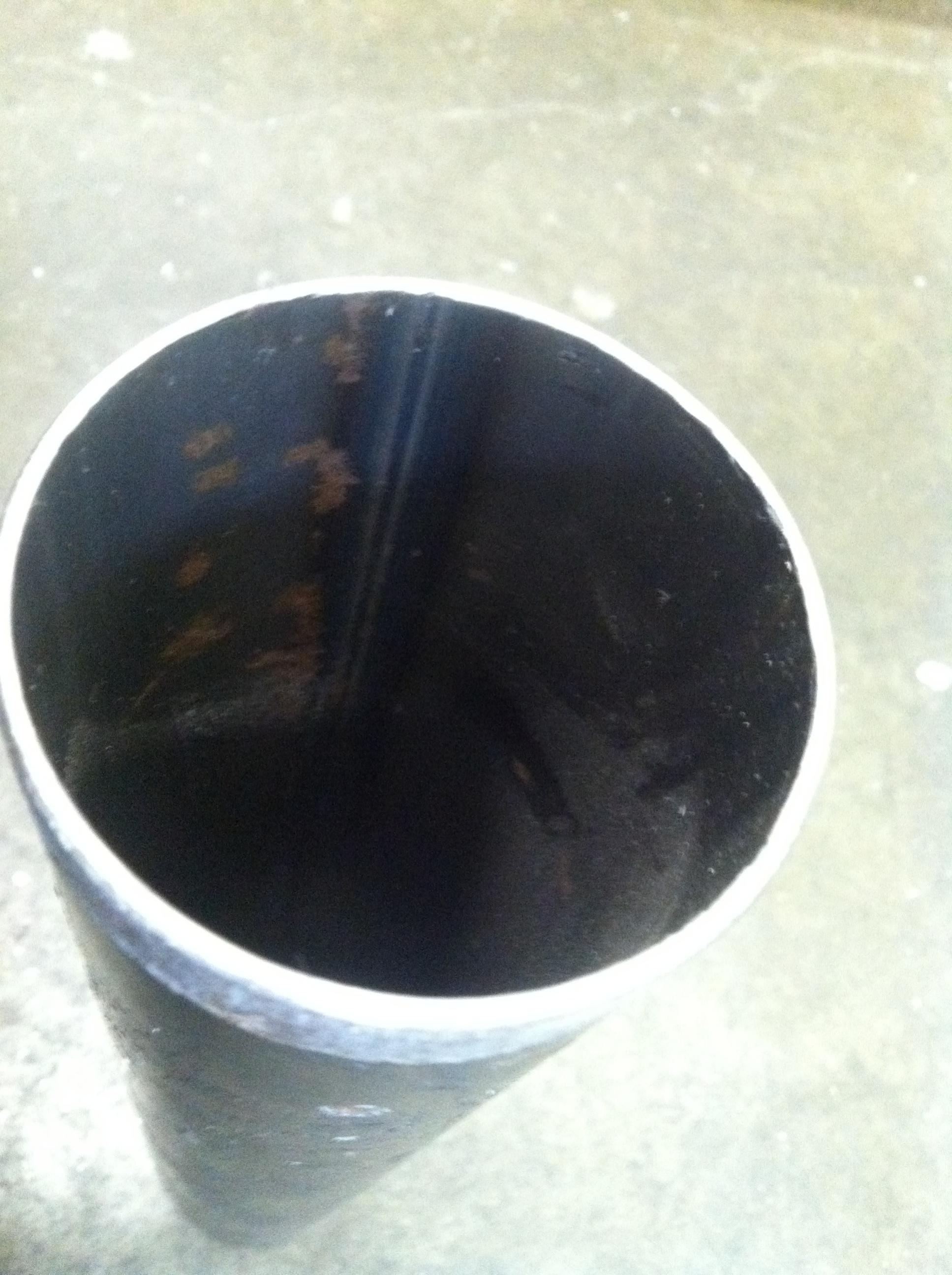

    Ok so I got the guy who I could get the pipe from to pull the inspection sheet for the batch, I was curious of the specs since the stuff is tested at 3000 psi pressure. The structural DOM tube from the site you guys gave is as follows:
    Brinell - 80; Tensile - 80,000+/-; Yield - 70,000+/-;
    The pipe (same wall thickness & diameter, tests are for the batch) I can get was actually tested to have the following:
    Brinell ~130 (HV10 hardness test converted to brinell by yours truely);
    Tensile ~ 520 mpa (so 75,400 psi converted)
    Yield ~ 350 mpa (so round 52,200 psi)
    Any thoughts?
    Thanks guys! Thus far this thread has been very informative :)

    Are you planning to MIG weld the tube to the frame and MIG weld the perch to the tube? If so, you are probably better off with the plain steel pipe. If you are planning to TIG weld it, then the DOM tube is probably the better option. From what I understand, DOM tubing should not be welded with the MIG method. The pro welders should chime in on this though.
  10. The DOM that most of us use is just mild steel and can be welded with tig or mig. Most dragster chassis are tig welded.
    DOM is nice to say when you are selling one but as I have suggested more than once just standard mechanical tubing is going to be fine for this application and costs less. The big difference when you look at the two is that mechanical tubing has the weld bead visible on the inside.
    On a side note I would not want to say that my suicide mount is attached to gas pipe when I was selling a car and I would feel compelled to be honest.

    Well, there really is no such thing as "gas pipe". It's ASTM A53 carbon steel continuously welded pipe. ;)

    This is making me crazy. Pipe is a rated steel material just like any other product. Calling it "water or gas pipe" implies that it is an inferior material. Jkeckss I admire your diligence in wanting to build a safe car. That is good for you and everybody else on the road. We build structural assemblies every day and we use various tube products as specified by an engineer. This forum has supplied lots of opinions and I can see how you might be confused. At this point I would recomend that you sit down with a structural engineer who can explain exactly what will happen when you stick all of these pieces together. The strength of the pipe is not the only factor here. Best of luck.

  14. You must learn to speak to your audience, you are not speaking to a PE or a man that has had several years as a structural fabricator. He can understand water pipe or gas pipe when he will not understand ASTM ratings.
    I have been involved in structural design for quite awhile, I cannot understand where you would find a PE that would even suggest using a conduit in place of structural iron. Less in a situation where there is going to be constant twisting and flexing not to mention ever changing moment loads like an automobile chassis.
    Maybe there is an easier way to explain it, there is a reason why most if not all race sanctioning bodies will not accept a fluid transfer conduit as a load bearing part of a chassis. While one cannot call this type of material inferior in its intended environment it is not intended to take the stress of an automotive chassis.
    I don't know that I could take the liability of suggesting that someone use a piece if iron of unknown origin to build an important piece of his suspension. He called it pipe, it was suggested that a piece of pipe intended to use for water or gas is not a good piece to use for his suicide mount.
    I respect the fact that you own a fabrication shop but you are not giving the young man sound advice.

    You're quite correct. 30+ yrs. as a weldor/fabricator I've built many structures using pipe and these were all spec'd by engineers.
    The first thing that needs to be understood is that the primary difference between pipe and tubing is sizing. For example: A "2 inch" pipe will not measure 2 inches in any way and the wall thickness will be determined by its "schedule" (40-80) nothing more or less. "2" tubing, on the other hand, will measure 2" o.d. and can have a variety wall thickness's from .0xx to .xxx. So comparing pipe to tube is kinda like comparing apples to oranges. Having said that, and for the sake of argument, a piece of pipe formed and welded in the same manner out of the same grade of steel as a piece of tubing in a near size will have a essentially the same strength. Example: a 2 inch (actual 1.900 o.d) pipe with a schedule 40 wall thickness (.145) and made from, let's say, grade 1018 or comparable steel will have a stength comparable to 2" (2.00 o.d.) .120 wall tubing. The fact that the pipe may be intended to transfer water, gas or whatever, has nothing to do with its strength. Like I said before, steel is rather dumb. It doesn't just give up and get weaker because it's going to become pipe.
    Also I keep seeing reference to racing specs. I don't think the OP is intending to build a race car. If race car specs are our benchmark then consider that USAC requires 4130 cond. N tubing and nothing less. So I guess that means nothing else is suitable for any wheeled vehicle ? ??
