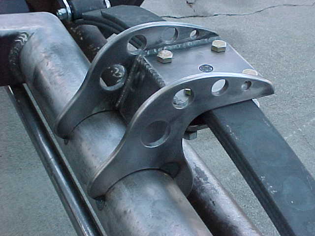

  11. Do it like this:
  12. Antibilly
    Joined: Apr 6, 2002
    Posts: 3,487
    Antibilly
    thats how mine is set up...less arch but it!! looks to be the safest approach! [​IMG]

  14. plan9
    Joined: Jun 3, 2003
    Posts: 4,101
    plan9
    looks sexy sam [​IMG]
    usually those mounts look a bit tacky!!
    is this off the BFD??
  15. NOAH324
    Joined: Jul 24, 2002
    Posts: 162
    NOAH324
    TACKY!???
    No way! They're SEXY - like a primordial clenched claw emerging from behind the axle to support everything in a single thrust of power!
    Here's mine:
