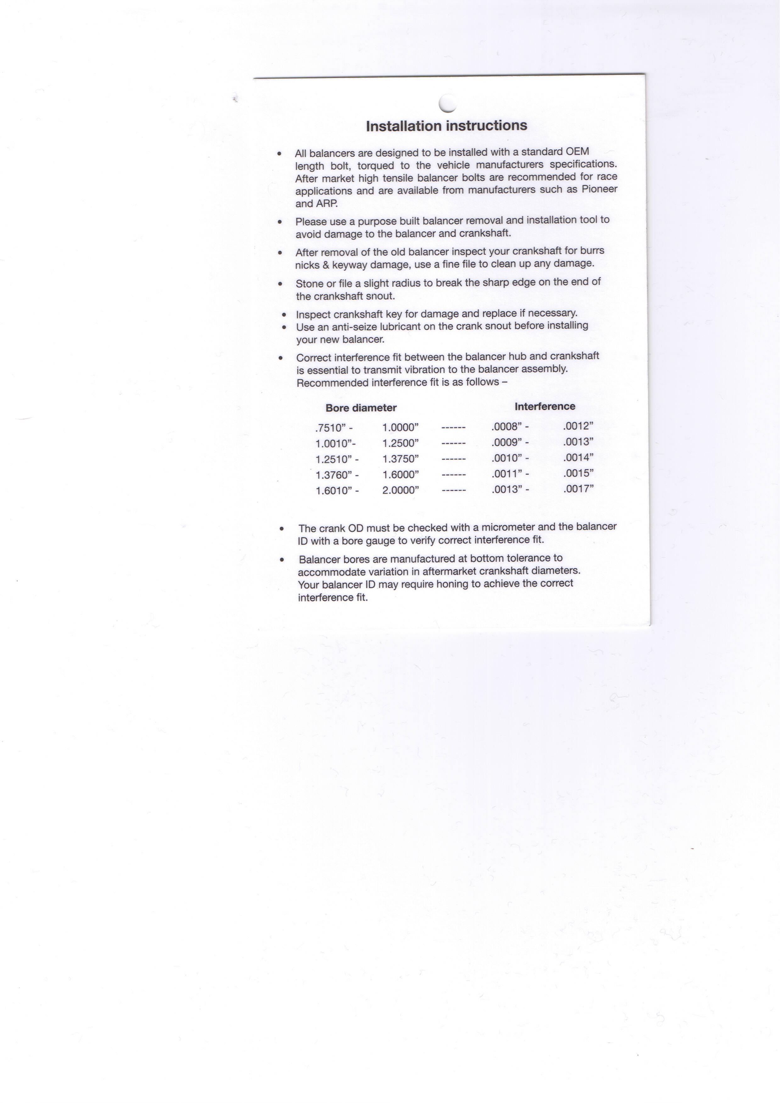

    You don't need to get it red hot, for goodness sakes!!! ONly right around or above a hot engine temperature of 250 to 300 degrees. Grease the crank snout and grease the seal and it should go right on. YOu might need to take a fine file and make sure there is a nice and small chamfer on the leading edge of your crank snout. You could also use a micrometer to be sure the parts are in spec.

    I second the micrometer if you have access to them. Heres a scan of the interference recommended with one I fitted recently.

    Imthinking you got the one that is out of spec. (on the small side)
    and you may have a crank that is on the edge of the big side spec.

    Some would say for performance use an extra tight balancer fit is important. Many of the high end balancers are hone-to-fit.

    I would think that heating it to install it may be fine but when the engine is ready for a timing chain or has a front seal leak it will be a bitch to remove it. I never install a damper without antiseze to begin with but if the installing tool wont do the job I hone it to proper fit. I would be hard pressed to use a Chinese made balancer any way and when ordering I would ask where its made. Its getting hard to buy American any more.
