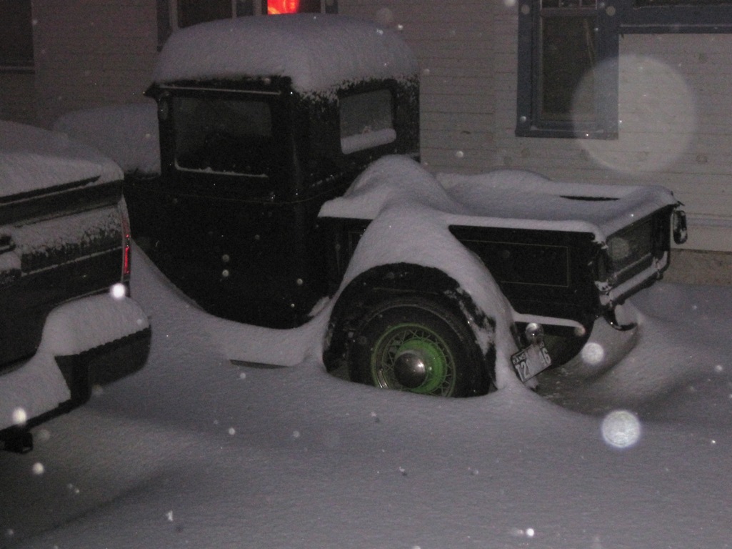

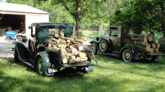

    I painted my Model A pickup with PPG Shop Line single stage in 99 and it sits outside in the weather, still looks good. As you can see it is used as a truck, the paint has held up well except I have had a problem on the tailgate with it lifting but was a new tailgate and I blame it on my prep work. The rest of the truck is still shiny and holding up great.
