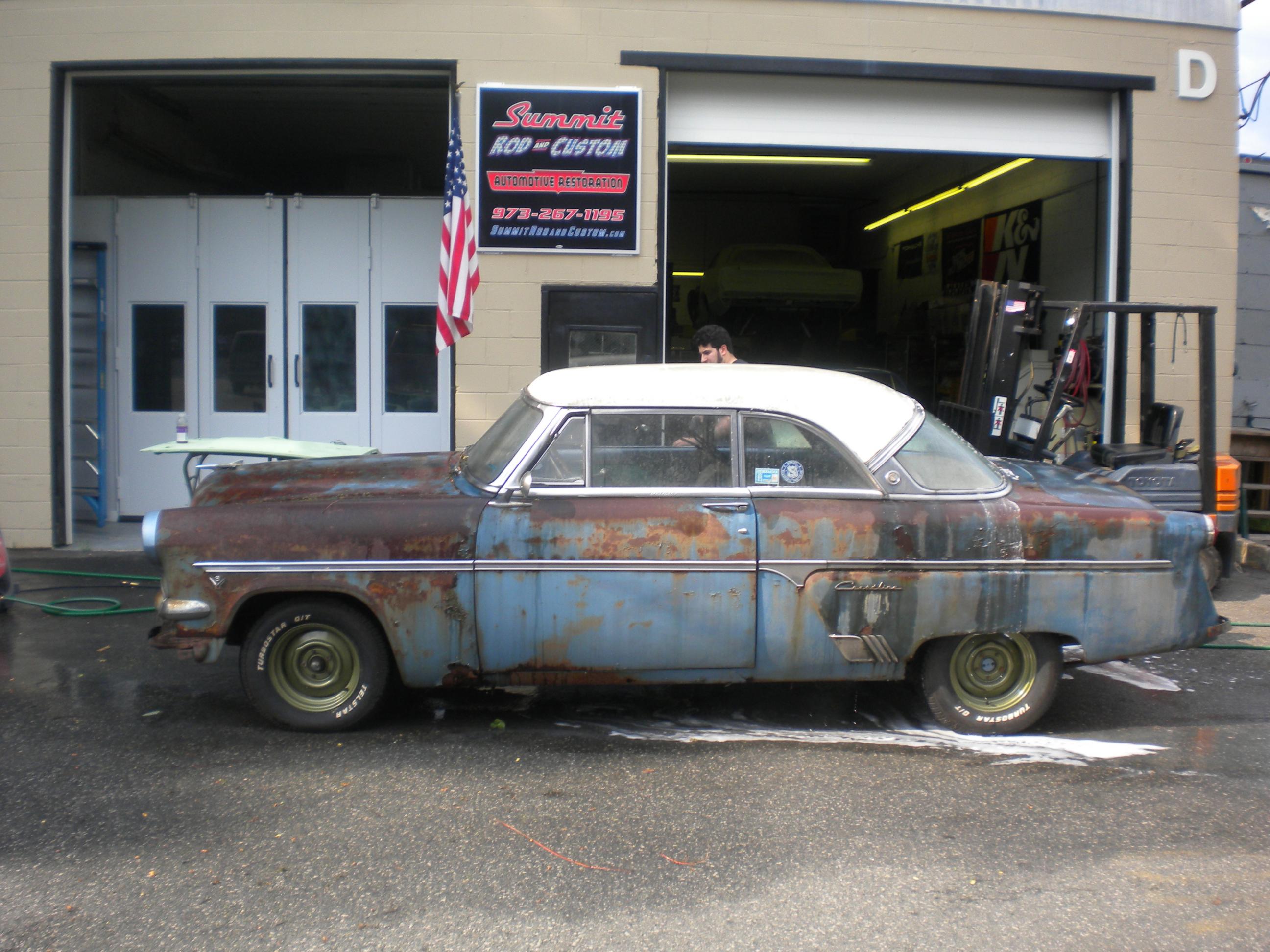

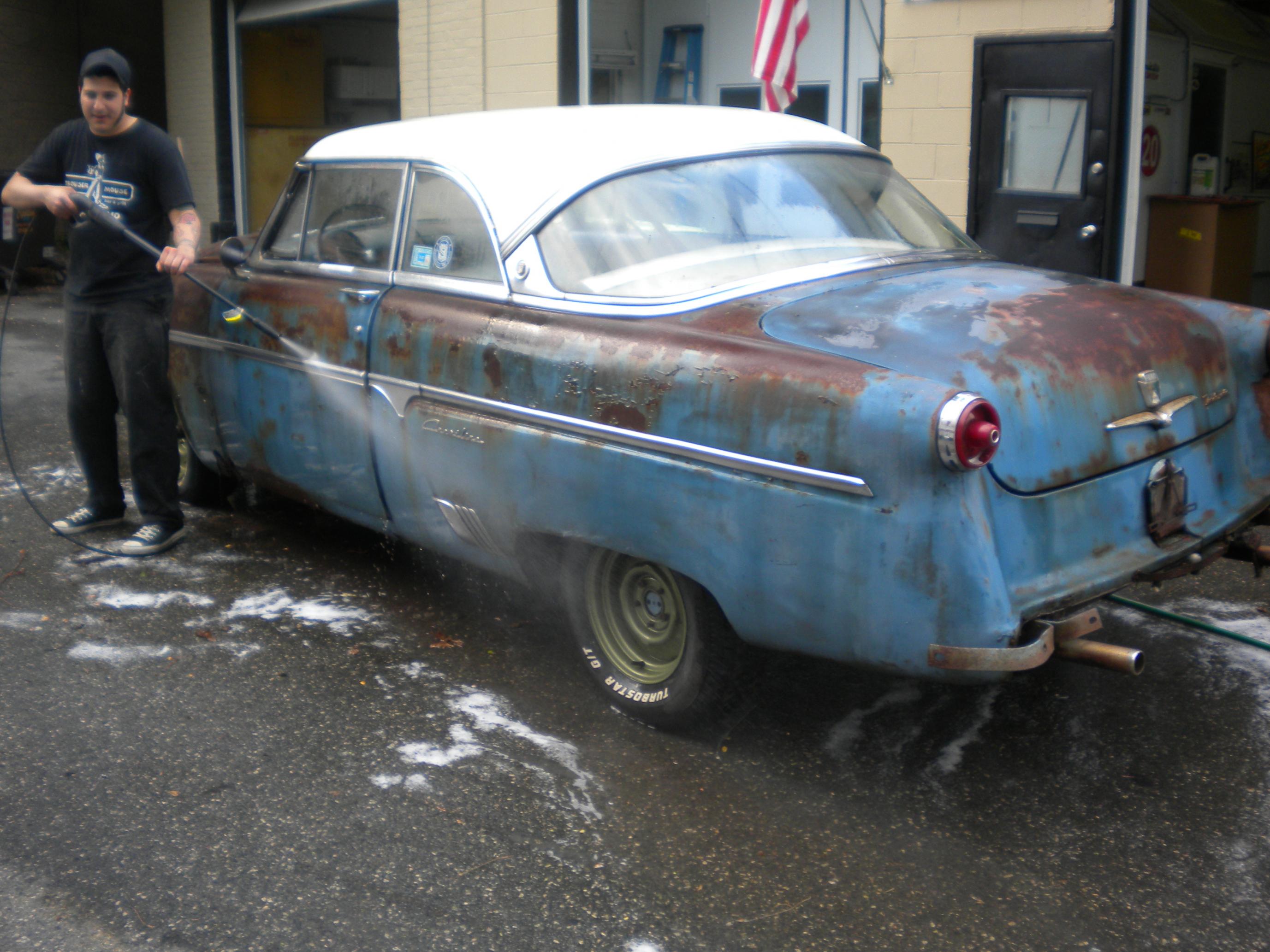

    Unearthed from the back lot with some help from the forklift; the 54 made it to pre clean and is staged in the "dirty room" for the next phase.

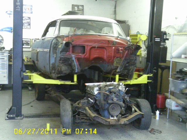

    Moved the 351 into the engine bay w/trans. No tunnel mods needed thankfully, cross member is almost a direct fit. Will be working on motor mounts and such next.

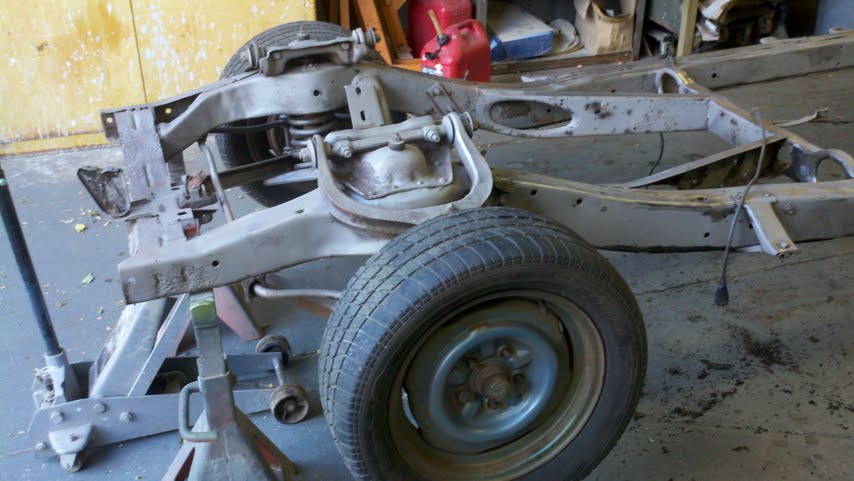

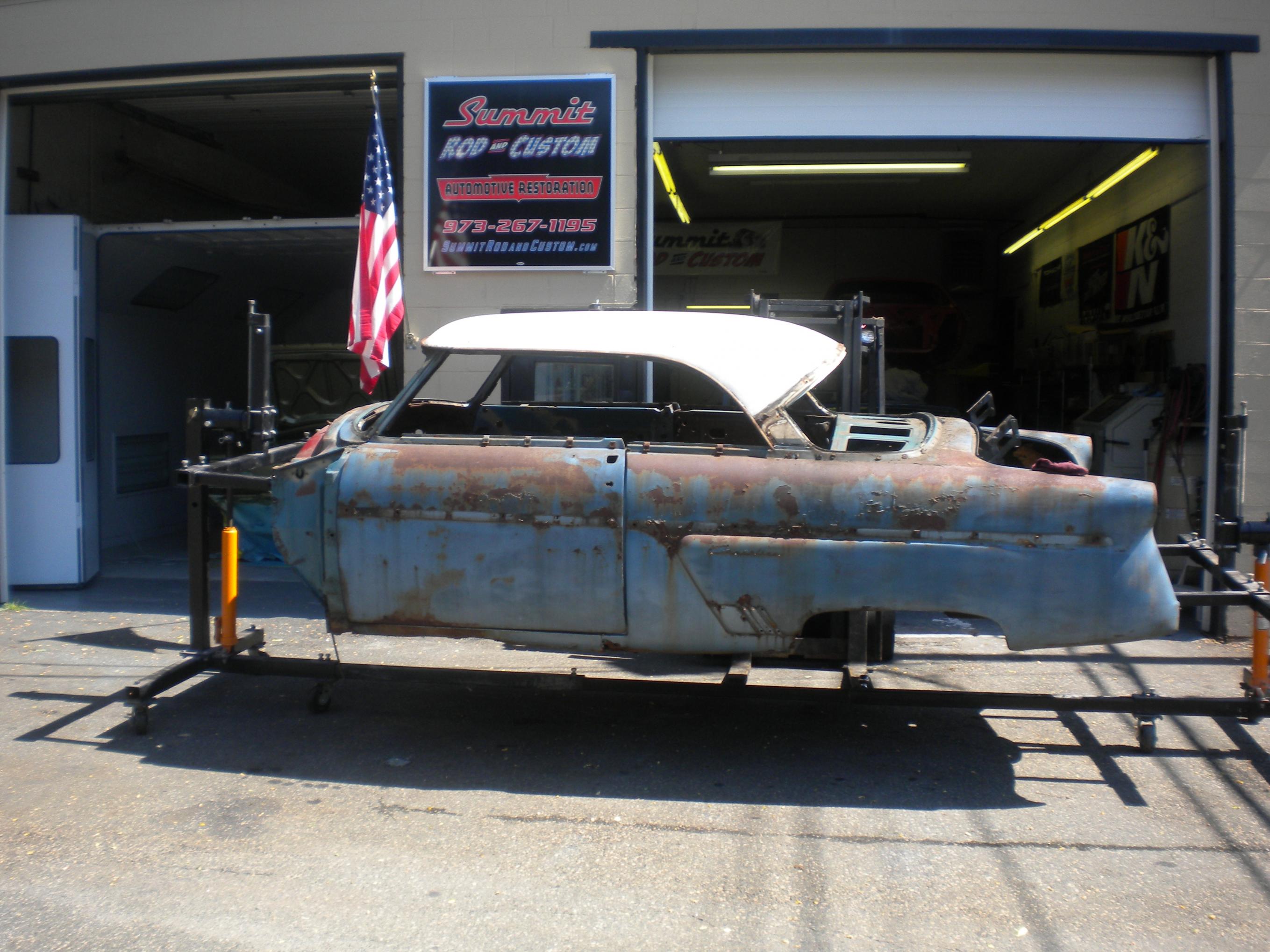

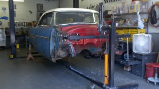

    Body and frame have been split. Completing the rotisserie set up this am. CLean up the frame here at the shop before sending it out for blasting. We found two nice fenders to use, now waiting for some time and parts. Thanks for the feedback on parts etc. its appreciated.

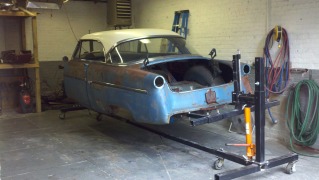

    Finished up our pieces for the rotisserie finaly got the car safely on it. the car was a little worse underneath than we originaly thought but now with it on the rotisserie it shouldnt be to hard to patch everything up. its going to need inner and outer rockers on both sides, new floor braces, new driverside front floor, new driver side toe board ( wich they dont make) and new cowl to frame mount up front. sheet metal is ordered and we are awaiting some parts and time to get rollin on more. hopefuly have another update by next week.
