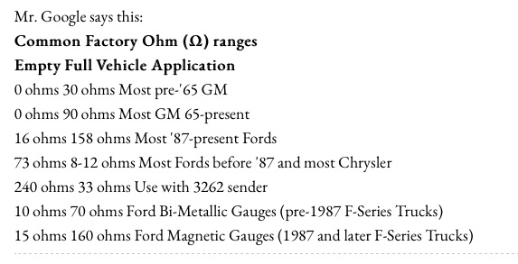

  7. BJR
    Joined: Mar 11, 2005
    Posts: 11,192
    BJR

  11. BJR
    Posts: 11,192
    BJR
    From the internet.
    A standard Sun fuel gauge sender typically has a resistance range of 240 ohms empty to 33 ohms full. This means that as the fuel level in the tank decreases, the resistance measured by the sender increases, and as the fuel level increases, the resistance decreases.
