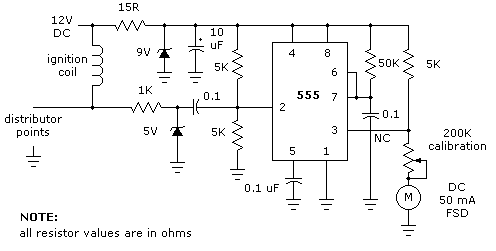

    NiCad AA batteries should work
    Here is a page with an alternative, maybe havent tried it yeat though. but it should work, and only cost max 10$
    IDEA FOR A CAR TACHOMETER
    Ive alos added an battery replacement instruction thet i lifted from Egay or someting.

    Mr 42, that is so cool! That looks like it might work, if only I understood what it said. Sorry for my ignorance of some of that more advanced electrical things, I'll try to learn more.
    It looks like the 555 timer is about the size of a postage stamp. I counted 7 resistors, 3 capacitors, 2 diodes, a timer, and a few other oddball parts. I guess you could put all this in a gutted transmitter box and be done with it. That's probably all the conversion places do. I'm not sure if I want to attempt it myself just yet.
    Any disgruntled williamson's employees out there want to spill the beans? LOL

    You know, this is so crazy it just might work. I'm still not quite clear on what the 50mA meter is, I'm thinking it's something that would have to be installed in the tach head? and the 200K calibration potentometer is something you can buy? Might as well be a flux capacitor to me!
    I'd sure hate to have this thing burn up my tach or something. I wish I could varify that it is sun tach safe.

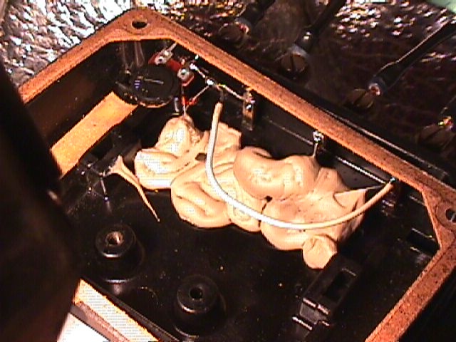

    Ok, I went against all of my good judgement and took apart pop's transmitter. Yep, the one in his Abone that I had to sware I wouldn't touch, that's the one. He was worried I would break it. No worry there...
    To my suprize, I took the cover off only to find... NOTHING! I mean, i was expecting a modern circuit board and all kinds of diodes and resistors, and what is there? A decal that says "williamsons" with the date it was done. The rest was mostly a big empty space with a few wires soldered to the terminals, and one thing that wasn't stock, a dohicky with a dial on it, I guess this would be what that diagram calls the potentometer. I know williamsons did something to the head too, but I didn't dare take that apart, er, yet.
    Here you can see what looks like a big wad of bubble gum that some of the wires go to. On the left is the black resistor (???) knob.
  16. ray
    Joined: Jun 25, 2001
    Posts: 3,798
    ray
    from colorado
    you MUST scrape that goo off, there's something under there, they are trying to hide how ridiculously simple the conversion is! c'mon, there's probably five bucks of components, and an hours labor to thw whole thing.

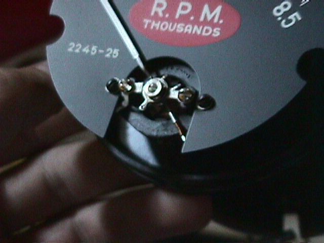

    Ok, heres another update. I took pop's tach head apart, and I also took mine apart again. I didn't notice anything major different, except where the needle attatches to the meter in there behind the face. On his it looks like it's got a black plastic center, and mine looks to be all metal, but it looks like the same thing, so I don't know if they replaced the movement with a new one or if it was just different to begin with. This first pic is his with the 8.5k scale, look where the needle attaches on this one that was converted...

    And here is mine, hasn't been converted. Notice the metal part where the needle attaches, different from dad's. I don't know if it needs to be changed or not. His looks identical to me, except that it's platic. I didn't take either face off.

  22. Mr 42
    Joined: Mar 27, 2003
    Posts: 1,215
    Mr 42
    from Sweden
    The Sun tachometer head is nothing more than a millamp meter measuring gauge. By the way all tachometer heads with a needle is that as far as i understand.
    The possible problem here is that the measuring range may not be compatible with what the 555 circuit put out.
    I.e if the Tacho head needs100 Millamp to show 8000rpm. and the 555 circuit only put out 50 milliamp at the same rpm the head will only show 4000 rpm. But i guess the adjustable potentiometer will supply some adjustment
    Ive been planing to do som meassuring on a tacho head, but it havent happended yet.
    This is the only thing that can go wrong with this version.
    You must take care not putting to much current thru the head sinc eit will fry it.
  23. Mr 42
    Posts: 1,215
    Mr 42
    from Sweden
    Ive been reading the post some more after my last reply.
    so i ramble on abit more.
    The original sending unit and head works something like this.In the sending unit there is a relay that is connectéd over the car breakers, making it open and close at the same rate as the breaker, on the other side there is the cadmium batteries and two capacitors that will be charged when the secondary circuit is pulsed by the relay. And the level of the charge is depending on how many pulses it gets (Engine RPM).
    Then the resistance (load) in the tachometer head drains of the charge from the capacitors, and emptying them in that way. And as far as the engine is running pulsing the relay the capacitors will be charged,and the head will try to empty the charge, and the level of the charge is what is showed by the tachometer needle.
    The thing marked 50m is the tachometer head. and if you show the circuit to your Radioshack guy , he will put together a small package with all the parts for you. And if you ask him nice he can probably put it together, or give you a tip on some that can. its a 15 minute job.
    Now we only need to have one hamber to verify the circuit. and we can start saving hundreds of dollars [​IMG]
    Im guessing abit here but
    The difference between 6volt and 12 volt, can be the relay so it wont fry when connecting to the higher voltage.
    A resistor in series may take care of that though.
    And the difference between 4 and 8 cylinder must be the value of the capacitors, since 4 cylinder only gets half that pulses the from a 8 cylinder. And remember the head is the same and the batteries are the same, so the only thing that can be cahnged is the value of the capacitors.
