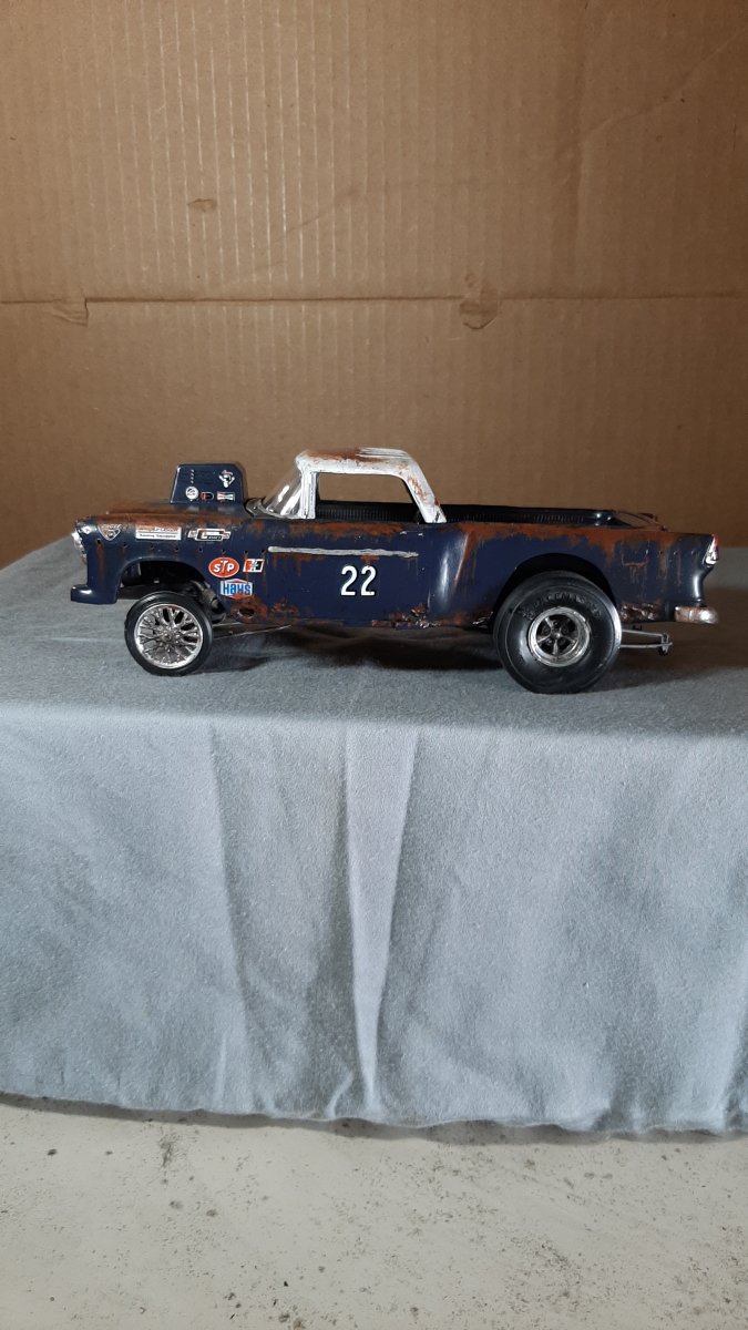

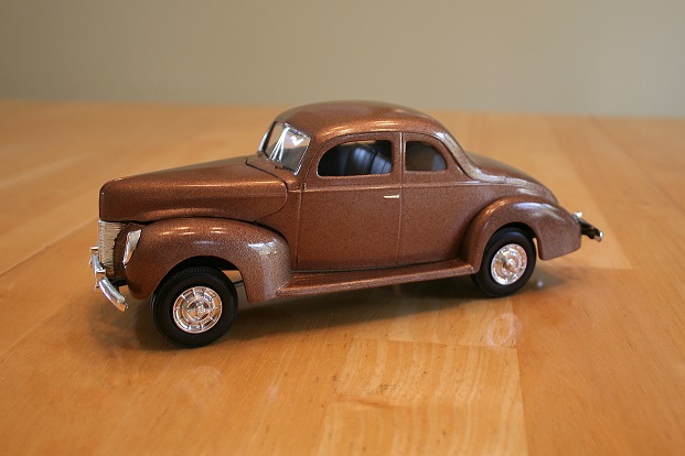

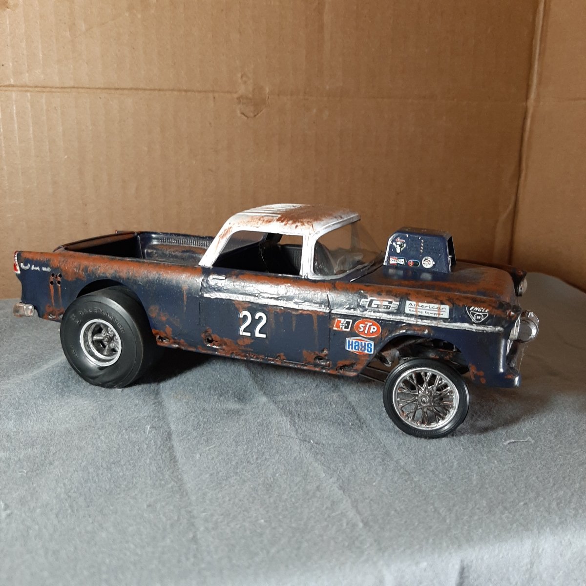

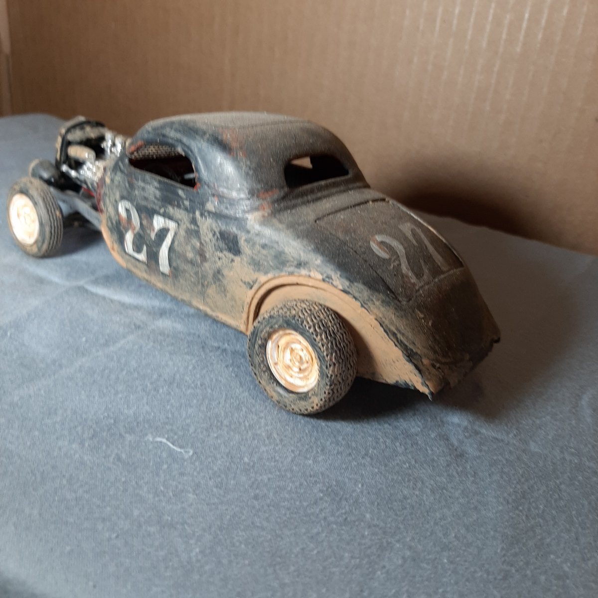

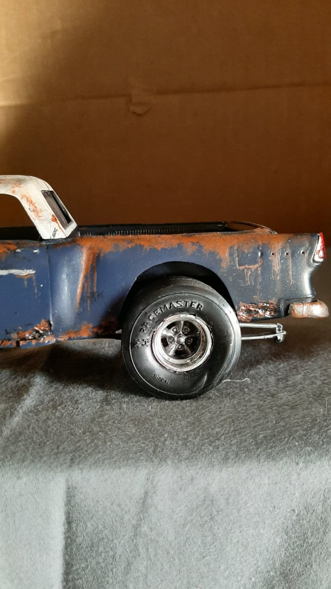

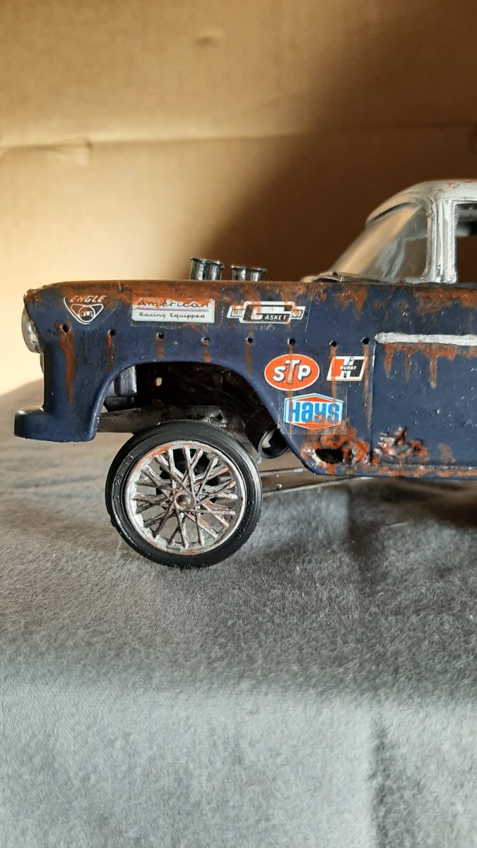

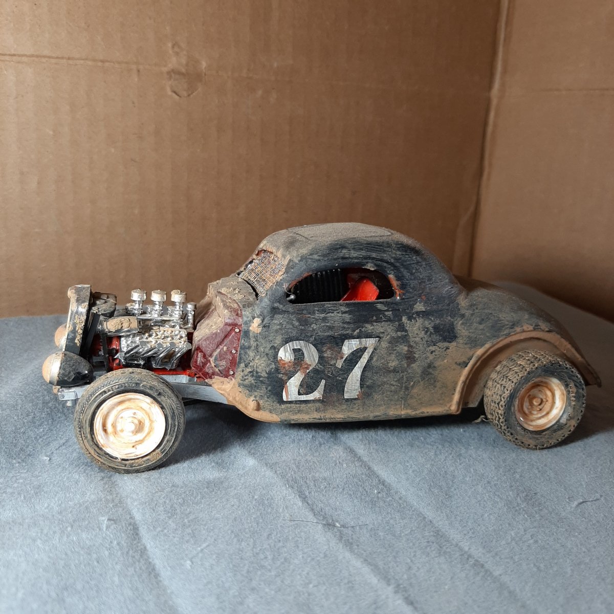

    ^^ I'd be scared to take #22 down the strip at full speed. You definitely
    weathered that one. As for #27, someone in the "full size" discussion recently
    bemoaned all the '30s coupes that were led to their slaughter as circle track
    racers. Your model really captures that look.

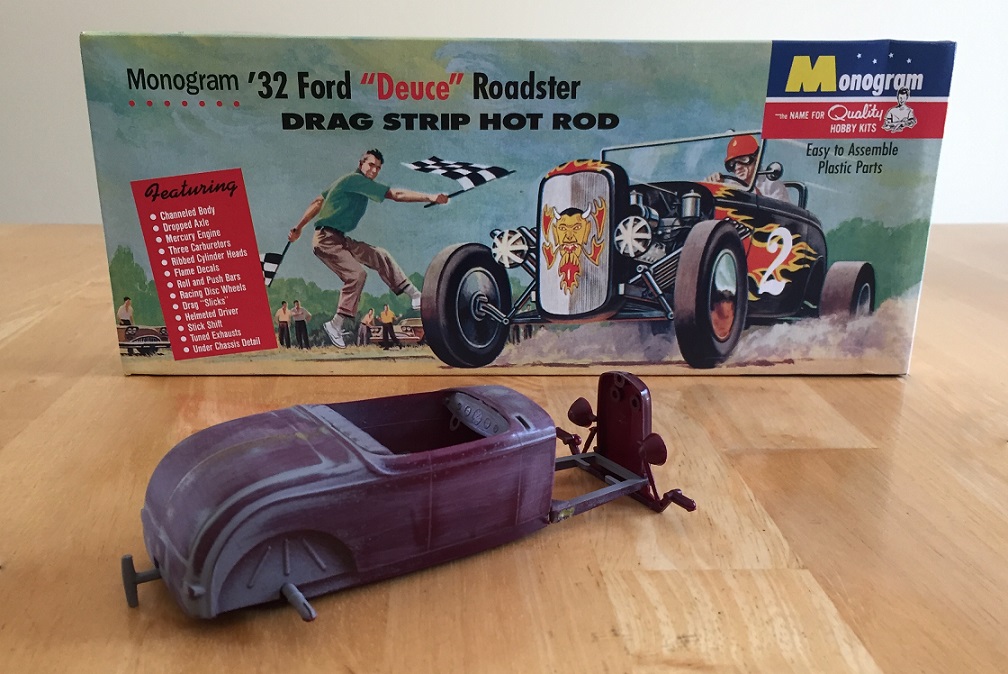

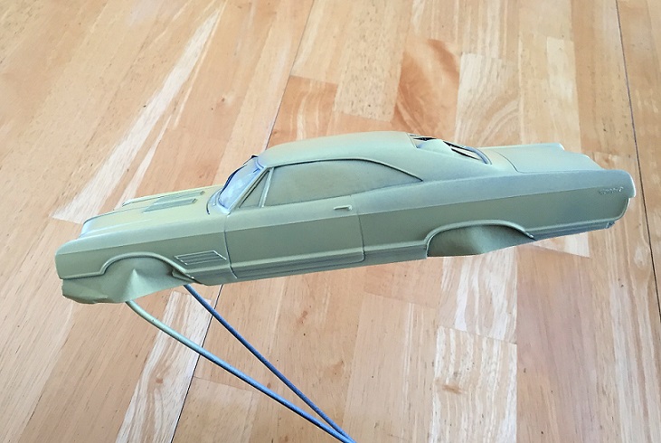

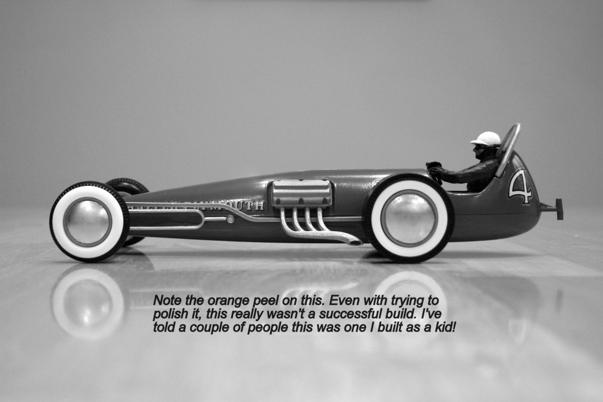

    Painting plastic has now become a major pain in the rear for me. When I
    got back into modeling I was working at a new car dealer and one of the body
    shop painters took on the job of doing my painting and he was very good at it.
    After a while I stopped building and really only recently started up again. I don't
    have an air brush and compressor, I also don't have a spot to build and set up a
    spray booth, so I depend on spray cans and a cardboard box when I want to whip
    something out. The thing is, I don't want to just whip something out, I want my
    models to be presentable and something kool to look at. If I left everything in primer
    I'd be golden but color, orange peel and crazing are making me crazy. I won't let a
    model car defeat me so I do what I can to rectify the situation. There are no kits that
    I want to leave unpainted, and if I run across a rebuildable beater at a garage sale it
    has to be painted.
    Can any of you fellows (or gals) that spray with cans offer any solid tips? I've stayed
    with regular everyday hardware department primers and paints mainly because of
    the costs, but they've been biting me on the **** too often. If I could afford (or justify)
    buying only cl***ic AMT screw bottom kits I'd could leave the bodies alone, ***embling
    them the way I did as a kid, but there's not a plastic model car in the world worth $100
    and more just to fill my nostalgia jones. Right now I've got an older AMT '63 Galaxie
    kit that most likely won't get ***embled because I'm not going to h***le with paint...
    plain white paint. Yeah, I guess I'm a quitter.

  4. I built number 27 as a nod to my grandfather, he raced jalopies at a dirt track in Watts Flats, Ny in from 1956 to 1960 when the track closed down.

    I feel your pain.
    I' am finding time to build models again and even with 42 years of professional painting experience the painting aspect of model building is a challenge. I'm going for perfection and i'm not there yet.
    I suggest relying on hardware store lacquer like Krylon for color only as sprayed and figure out which clear non lacquer is compatible for acceptable smoothness and gloss as sprayed.
    Different primer colors in thin coats may help achieving color with few thin coats. Try to then achieve the finished smoothness and gloss you want with non lacquer clear as sprayed. You may have to use an expensive clear on the less expensive colors.
    I could easily spray flawless high gloss smooth urethane enamel with my spray gun but all the seams and small details would be buried in clear even with a thin coat.
    I really don't want to get into a hand polishing routine but it might not be as troublesome as I imagine.

    I agree that Krylon might best for you. It goes on great and usually requires very little rubbing out, and even the lacquer clearcoats will work on it. Downside is the lack of cool colors.
    Tamiya cans are also another great alternative. They spray 10 times better than Testors and Model Master sprays. Downside there is the cost of them.

    John Worden...I've been trying my best with Krylon because of some of the colors
    available. My main problem is with the paint crazing on me. The first light coat of
    color over primer is no problem, after that all bets are off, anything can happen. No
    one on YouTube seems to be addressing the problems I'm having. You hit on the
    non-lacquer clear subject. That's my other main sticky point, find an enamel clear.
    Of course, if I can get a nice finish coat of enamel color down I wouldn't even bother
    with the clear. I appreciate your comments, thanks.
    NHRANUT...As mentioned above, I'm hip to Krylon and have gotten some good finishes,
    they're just not consistent. The colors Krylon offer work for me, so I'm good there. I
    wondered about Testors and Model Master, which you touched on. I haven't used them
    in quite some time and wondered about ease of application and any drawbacks. That's
    why I posted my questions. Someone's buying and using those products, they've been in
    business for a hell of a long time. Thanks for your thoughts and comments.

    Testors and MM spray way too heavy, as has been said. Decanting and airbrushing is the way to go with them. The lacquers are a little better because they dry faster, but even with them the paint always ends up too heavy in places, and too thin in others.
    Not sure why you're having trouble with the second coat. The only thing I might suggest is letting the first coat dry a couple days, and then lightly wet sand the paint just enough to knock off the gloss before a second coat.
    And if you get a good finish, you don't have to clear coat it, IMHO.
    Those models you posted look pretty good to me. :)

    quick85.... Describe your crazing in detail. What are the physical characteristics if it?
    I would say that a trouble free first coat rules out product compatibility issues. If you tend to spray heavy than an overnight dry of the first coat is a good idea. Some colors cover better than others with few coats. A short test spray will give you an idea of how well a color hides and a clue to how much will be required.
    Remember too that because lacquer dries so fast it can trap moisture and blush in humid conditions.
    Luck. John
    NHRANUT likes this.
  12. quick85
    Joined: Feb 23, 2014
    Posts: 3,046
    quick85
    John, simply put, the paint rises and bunches together. Never on the model as a whole,
    but in strips or sections, and it's never a case of spraying lacquer over enamel, that's
    what grabs
    me. I've tried to vary my spraying techniques...too light and it looks like the
    paint's too dry...too heavy and the runs appear. Since I know what I want the finished
    model to look like I try to take my time and not get heavy handed, I'll have to try harder.
    Again, thanks. You guys have given me things to consider (or reconsider).
