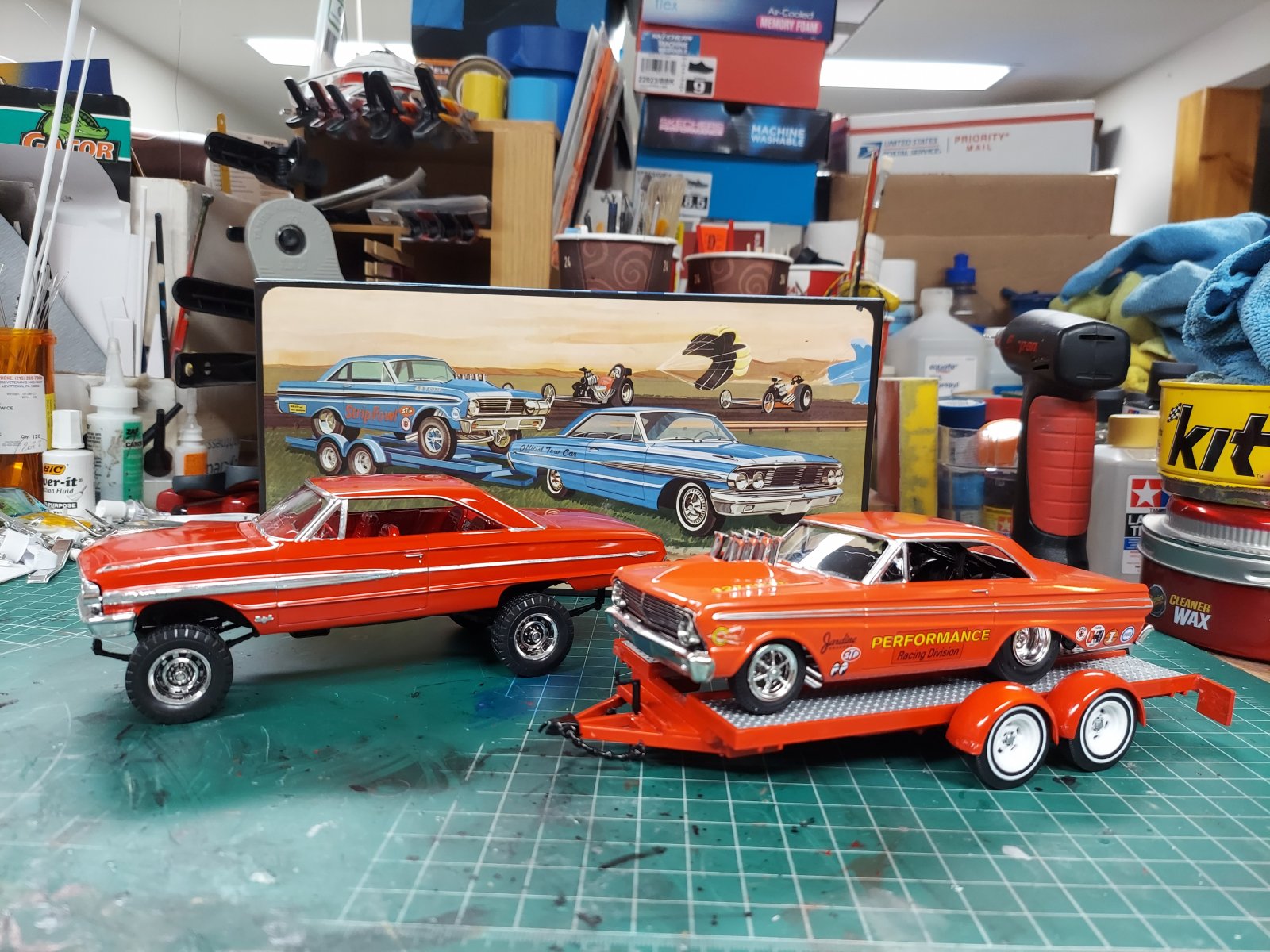

    finally talked wife into photographing some of my many models
    hope they turn out OK
    this is a trail run

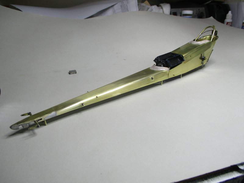

    UPDATE: All sub-***emblies are completed, so it's time for the body. Oh boy!
    I like using 0.25 mm br*** sheet. Not too thick, bendable yet sturdy enough to span voids. I made the tub body extra strong knowing that I'd have to do here and there some serious adapting....forcing the stuff to make the bends! If annealed, then it really bends, but will also dent easily. I annealed the sides up at the cowl, things got wicked there, so had to make sure the stuff does as it's told.

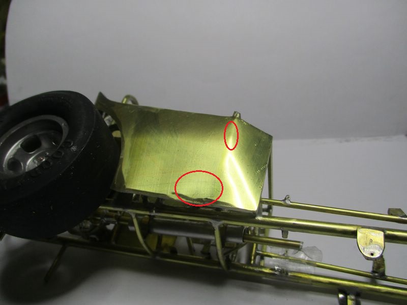

    First off the right side panel,
    OK. At the rear, another annealing was needed. Also, had to add some height to the panels on both sides back there at the bend.
    Marked are two areas that will need attention, some fill and sanding later on. Happy though, so far OK.
    On to the right side, same procedure. Better watch out though, it wants to crease up at the cowl sides...You can see where some height was added, more up-swept now. I like it.
    I was able to smooth out the "almost crease", the same areas as the other side will need body work. I like it though, am satisfied.
    A brace was added for more cross support at the rear, the upcoming firewall will make the front very sturdy and rigid.
    Firewall and motor plate. Spacing is good between plate and firewall, like the real car.
    Now things get real tricky. The short little cowl is full of nasty areas! The firewall is bowed and this leads to a concave area running up to the windshield. This 2nd area also has a bow to it, so multiple radii here. I decided to make my life easier by making the cowl plate in two pieces!
    Sitting nicely now. I'm real happy with it so far. The extra bracing for the tub paid off, now on to the
    rear deck. Later...
    Mike..

  8. Mike-model
    Joined: Jul 15, 2019
    Posts: 232
    Mike-model
    Hi Terry, well first off, thin cardboard templates were cut to size, cereal box variety. Then the sized up strips of br*** cut off the larger sheet. The actual placing of the panels, maybe 2 hrs. per side, with soldering them on and shaping up the perimeter.
    I don't rush anything, just want to do it once. I was kind of surprised this body deal went so well. Experience with more simple FED bodies helped a lot, wouldn't have wanted to do this body without having any experience, nor would I suggest it. To be honest, don't want to do it again that soon either.
    The next project is already planned, the ch***is is drawn up and new br*** just arrived today. This time, using a 3d printed, resin body. The PACERS has been exactly 5 months in the making, the car is finished, just waiting for decals. Projects more in the 3 month range are a preference.
    I ain't showing it yet, either! lol.
    I sure appreciate your and others' interest!
    Mike..

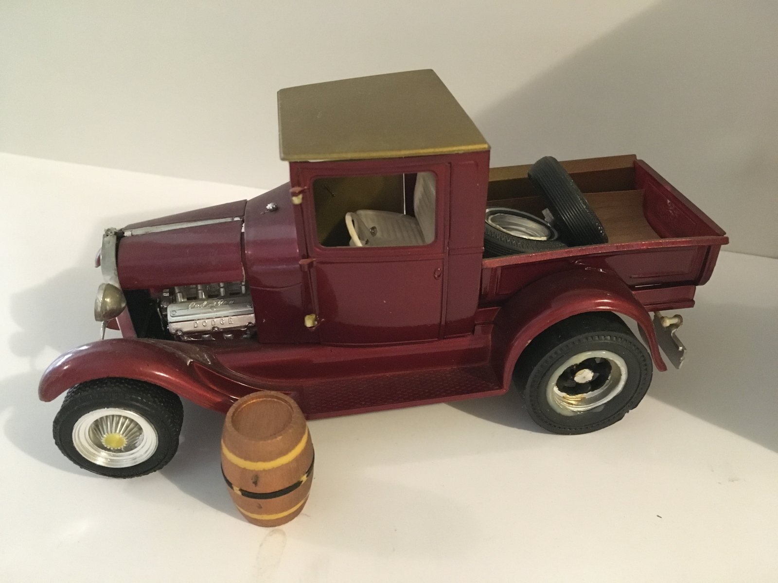

    any models I post in future were put together maybe 50 years ago
    enjoy

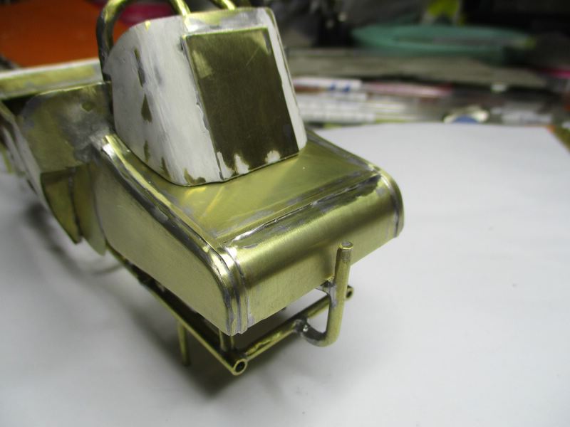

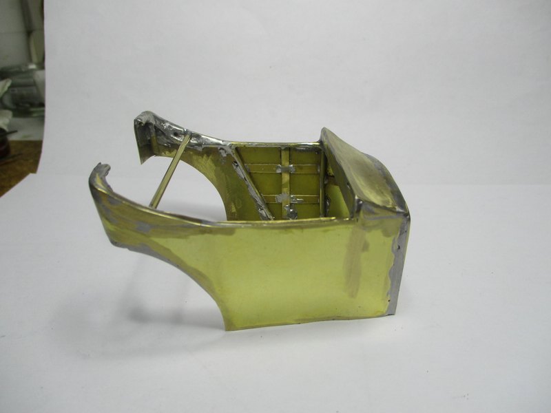

    Further with the body....The trunk.
    First the side panels,
    Two placed together to make sure they match...
    Right side, tape works great to hold things.
    Used thick br*** sheet for cross bracing, again this needed to be sturdy. The deck top will need lots of pressure to adapt it to the sides. Also, you can see a thick tube was soldered on to top of each side running along the length. The round tube helps define the roundness of the edge, sides to top.
    Done. The back area of the deck top was annealed to make the bend downward. soldered up and smoothed out here;
    Rollbar cutouts prepped so the trunk fits right up against the rollbar.
    Here the unique chute pack molding;
    The door lines caused me headaches, trying to find the best way to make them. Half-round br*** strips would've been great, just they don't exist. Then there's the problem of getting them on there. I didn't want to have to sand too much between the strips, on the doors, hard to get at properly.
    So, thin br*** strips were cut, soldered laid down on one side and on they went. Luckily not much had to be smoothed out.
    Here the door molding;
    ...and trim lines on the trunk;
    Now some filling and sanding, more of the same, till it's right. Getting the chute pack molding flush with the deck and body was a bear. Tiny areas to sand smooth, finally got it.
    The car has a Tonneau cover. But first a support was soldered on to keep my thumbs from pressing dents into the cover. First off the rough, 1st covering;
    Now the good one, soldered on all the way around. Later on, real Naugahyde will cover this;
    Last thing now, the lower body moldings. I chose not to attach to the body, rather attach them to the ch***is. They push on and off nicely, each side has two rods soldered on that slide into thicker tubes on the ch***is. They sit nice and firm and don't move.
    At this stage I could already see an end here. Full mockups showed everything sits right, no surprises lurking anywhere. More sanding, finally with 1500 grit, then primer. It was exciting not to see the br*** anymore.
    The House of Kolors paint I was sure would be fun, rarely does anything unexpected happen with HofK, I'm really nuts about the products. Ivory colored primer, white base, with white pearl enhancer.
    Next up is the buildup, ch***is, interior and that crazy front suspension.
    Mike..

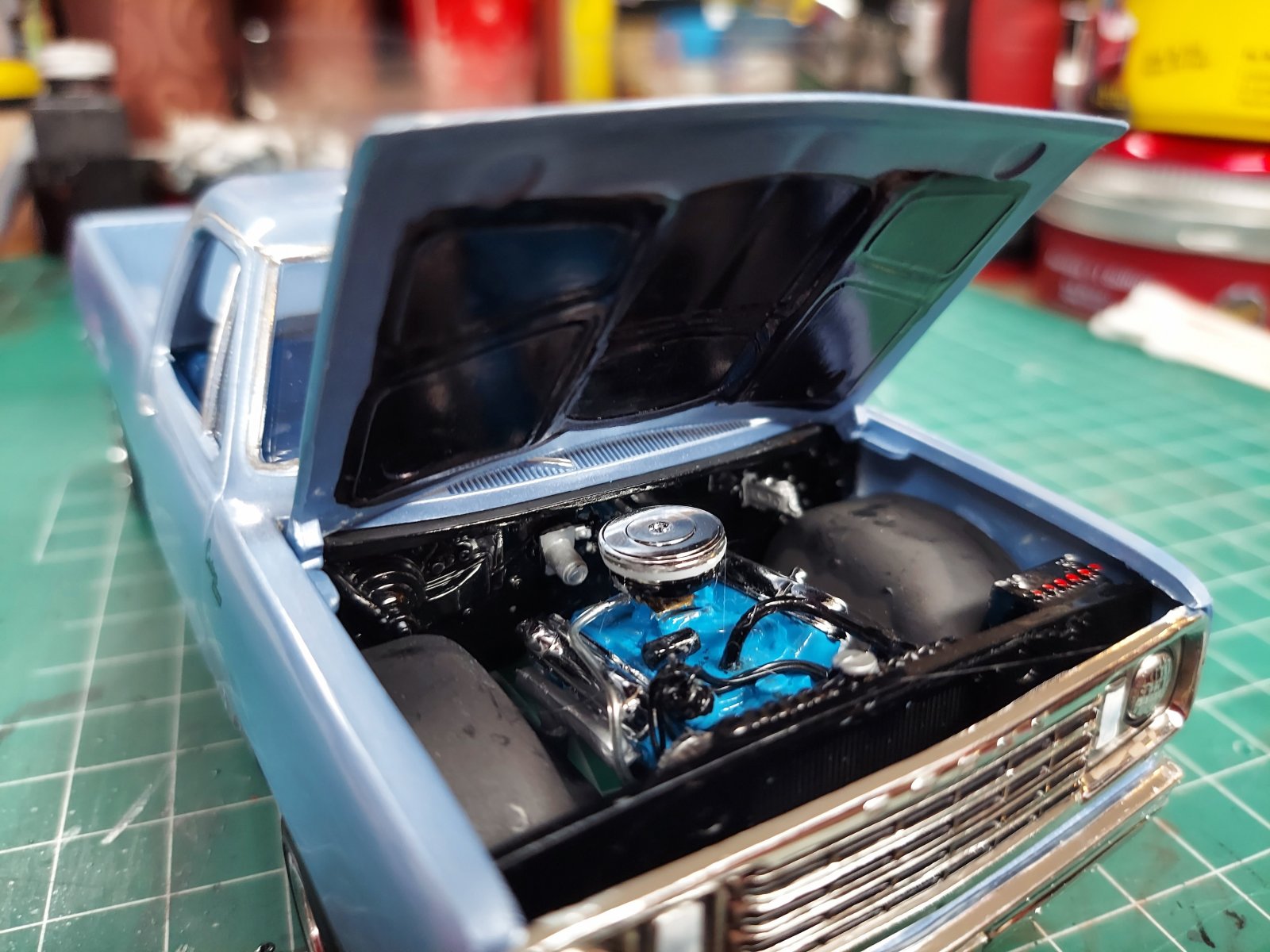

    rudestude
    Still moving forward on the no top drag nova project.
    After deciding what body to go with , each one having different issues , actually parts from both I now have one .
    Now I have been collecting parts, trial fitting parts , cleaning old glue bombed parts, going through all these parts reminds me of the days digging through the piles at the wrecking yards to find hot rod parts.
    Dug out a engine to go with then started looking through my engine parts , then had to decide do I want fuel injection or super charged? Then there's the header section, roll bar section....then do I want a windshield....found a chopped down frame less type, it was in bad shape ,but I managed to clean it up and after looking at it mocked up on the body I think Im going to use it.
    I will get back to it ...its about build time now.

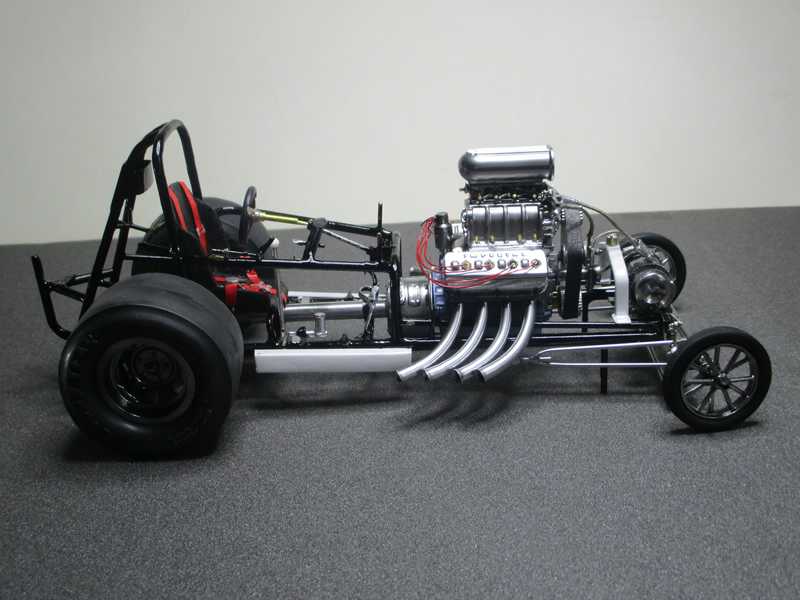

    ...dragster....sorry, I thought you meant a recent rail job.
    This fuel altered car is 1:16. Larger scale is out of the question, my opinion, 1:16 has a perfect balance, not too large but a lot different than the usual and tiny 1:25. Detailing and realism is easier in 1:16, to me, that's what it's all about. I feel they can make 95% replicas.
    I do love front engined dragsters from mid to late 60s!! Here one from earlier this year, full br*** body and ch***is....
    -IMG_3804.jpg -IMG_3995.jpg -IMG_4003.jpg -IMG_4004.jpg -IMG_4007d.jpg -IMG_4007e.jpg -IMG_4005.jpg
    Thanks for your interest.

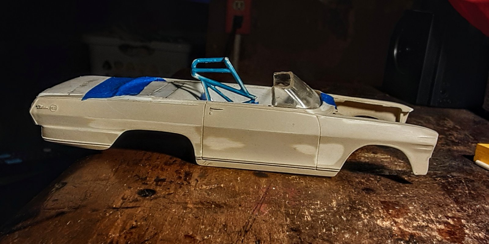

    A pre-dawn session yielded some progress this morning. Since my last update, the hood & cowl framework has been completed. This morning I got the cowl framework wrapped in it's styrene skin.
    Next up will be the louvered hood sides and one piece hood top. Unless I decide to do the remaining framework to rough in the rear of the tub, that is...
    No doors on my modified roadster, just contiguous step-over side panels.
