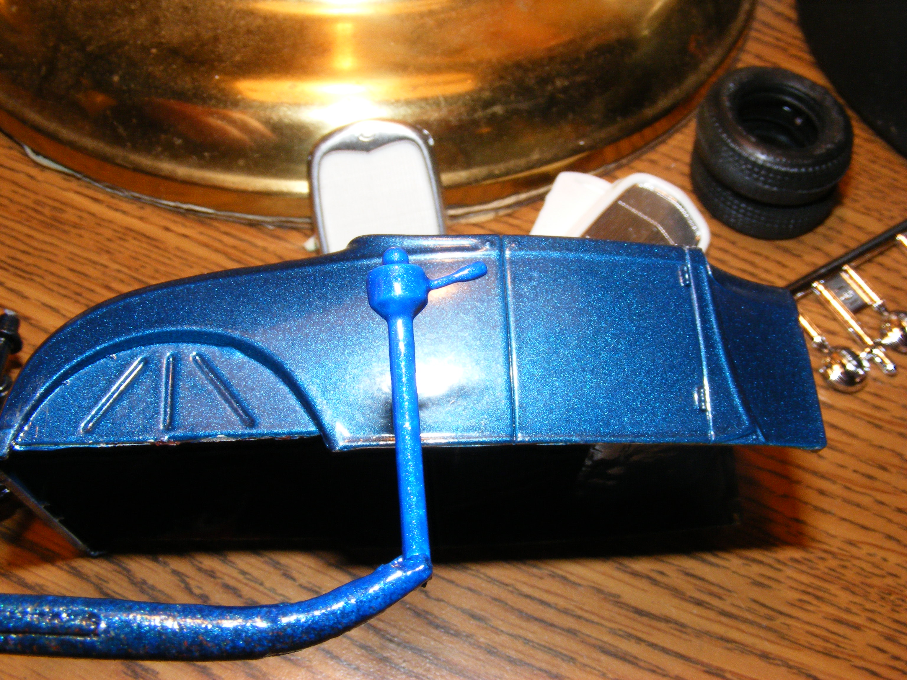

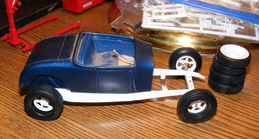

    DSCF8030.JPG Think this may be my next project. AMT '29 on Revell '32 frame. Paint on the body is 28yrs. old. Would like to save paint. Matching could be a problem...

    Doesn't look like I'll be able to match the paint. Got one more thing to try unless someone can tell me what the modern equivilant of Testors Saphire Blue Metallic is. DSCF8057.JPG DSCF8058.JPG

    Do you remember what primer you used on the original? Primer color can really affect what is sprayed over it. In the 2nd pic it looks looks the tweezers match the body pretty well. :D

    Thanx wojojo. I hadn't noticed the tweezers. The body was painted with Testors white enamel ( back when it would cover ) with Testors Saphire Blue Metallic enamel. Been trying different bases with Blue Pearl. No luck. The tweezers/clamp is that brownish color ya get with paint build up..... Brown may be next! Thanks again.
