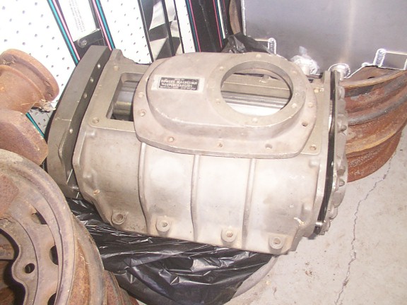

    heres' a pic of an old bowers that i'm sending out for refresh. It is an old 2 lobe beauty, teflon striped and magnesium.
