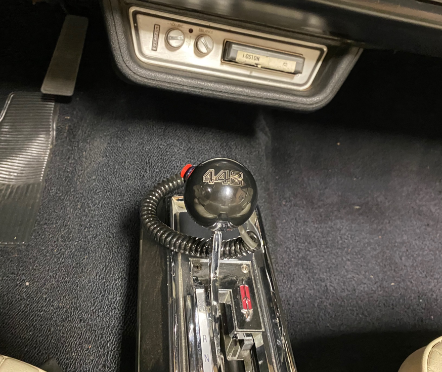

    I used a piece of radar detector coily cord to wire my lin-locs to the ****on in shift knob on my dual gate shifter in the Olds. The other end has a guitar plug and receiver in the console for removing the shift knob for servicing the console plate.
    It isn't exactly what you are asking but the point is there are a lot of electrical testers, multi testers, phone chargers, telephone cords, etc that have flexible wiring. Heck, you might have something in your tool box right now that will work. That is where this lin-loc cord came from over 20 years ago.

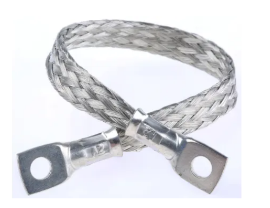

    Google "Braided Ground Strap"

    I'm thinking that a number of rigs use something similar to the strap Kerrynzl showed in post 13.

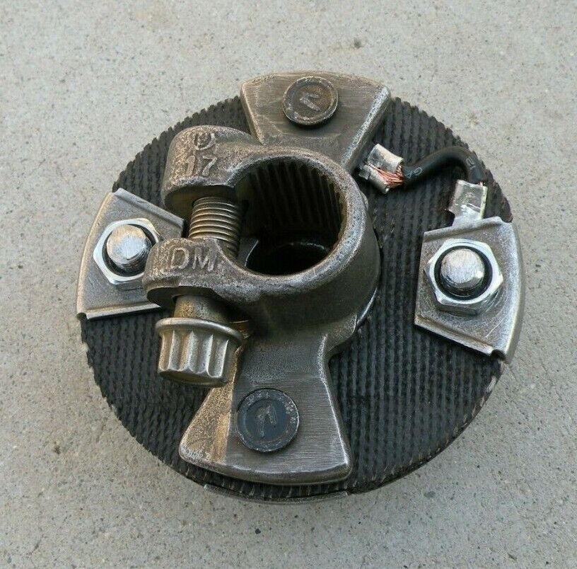

    This one from a rebuilder sure doesn't get fancy on the wire. T bird rag joint.jpg
    Bandit Billy and indyjps like this.

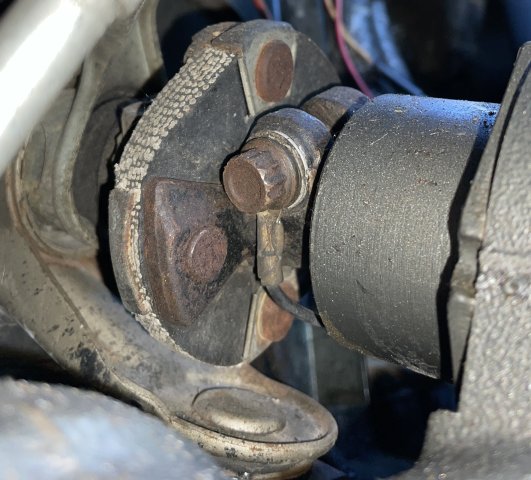

  17. I think this is the factory setup.

    On my first try, I emulated the rebuilt one pictured in Post #16. For the current one, I emulated the one in Post #17. I don't think a ground strap will work, because the ID of the eyelets for the connections need to be quite large, and I don't think I'll be able to get a small ground strap with a large eyelet. Anyway, I'm going to try the 180* loop with the test wire.
    Oh, the car does have a swing away wheel, but I don't know if that affects how the horn is grounded.

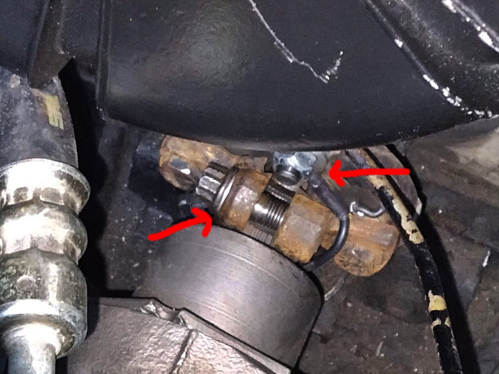

    Here's how it came out...I used silicone test wire and shrink wrap with adhesive on both ends. I looped the wire around the rag joint to give it a more natural bend, so I think it will hold up for a long time; plus, I learned a little about making a good wire in a situation like this. Thanks for the help, everyone. rag joint.jpg

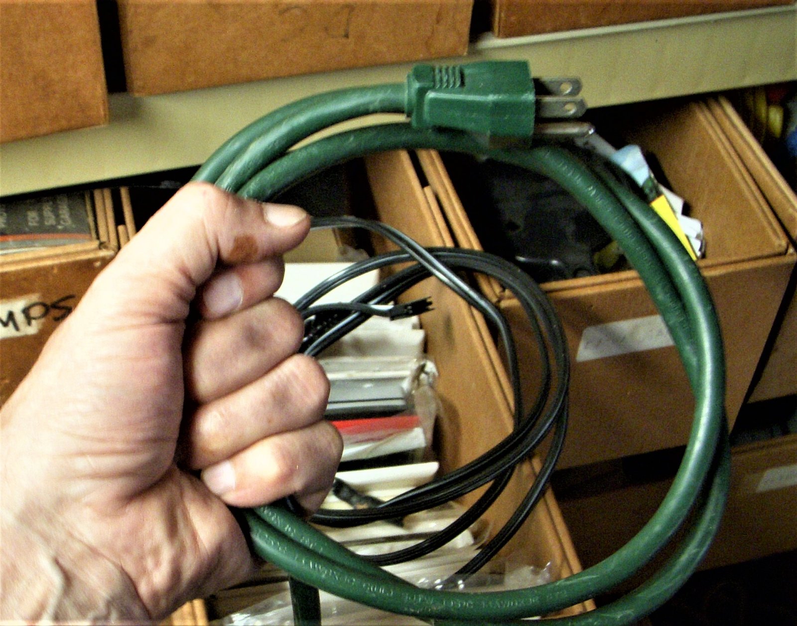

  26. Just about anything that temporarily plugs into a wall outlet, lamps, appliances, power tools, damaged extension cords, etc, has to have "flexible" stranded wire. I must have a little bit of hoarder blood in me because I tend to save the wire pigtails along with a handful of fasteners, grommets, etc. before I throw something in the trash.
