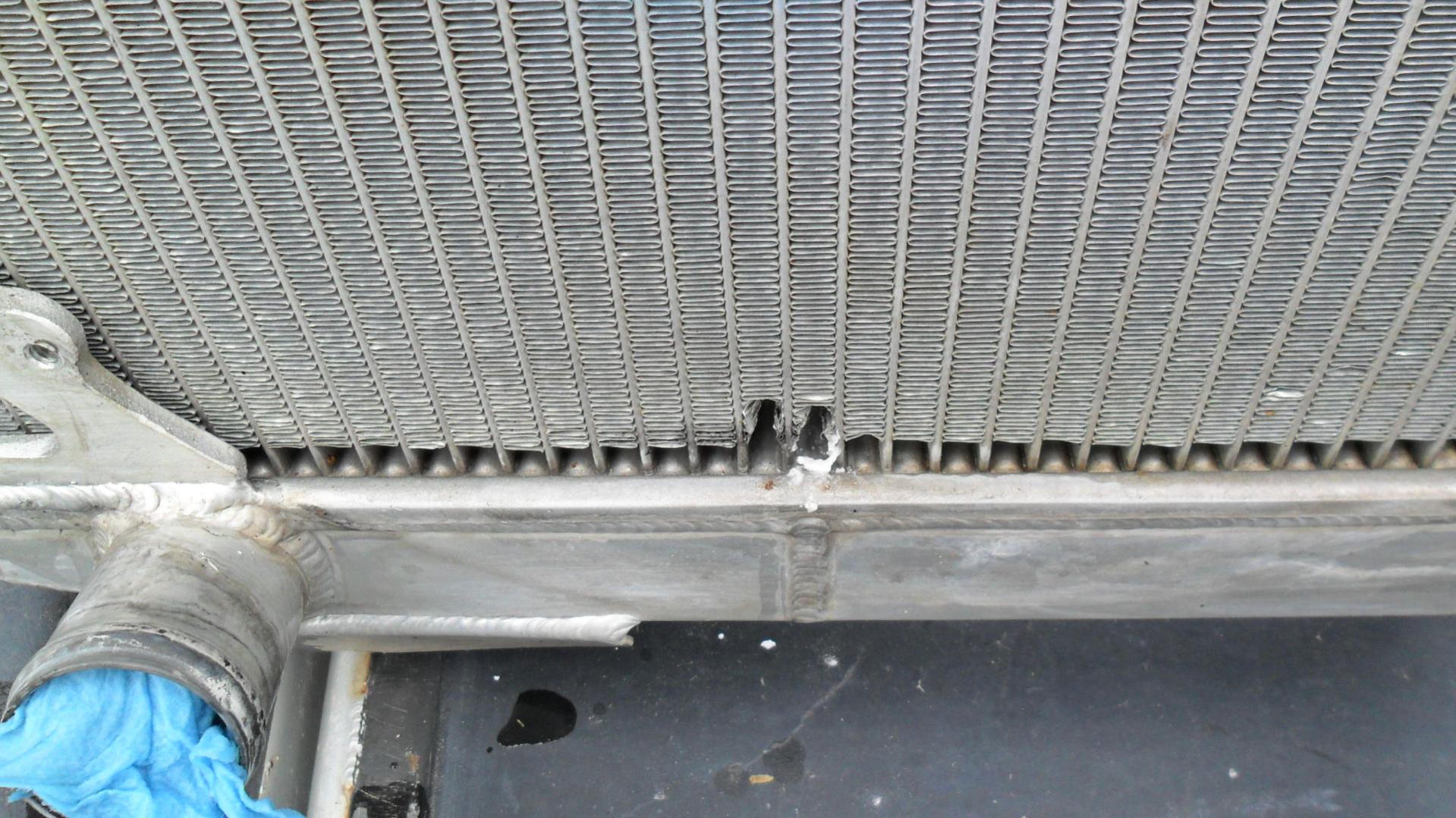

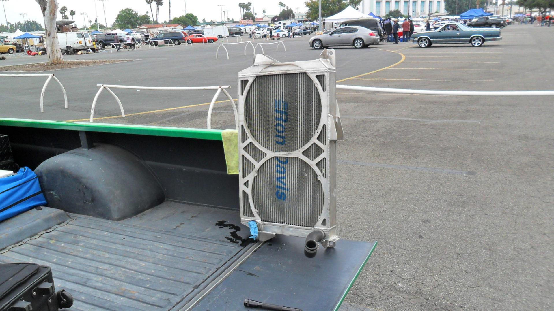

    Okay, I use this too for wound care. The idea to hold a ch***is bracket while tacking is a great idea!
    But the true test of this stuff came at L.A Roadster show in Elpolacko's green twin turbo truck. We pulled into the prefered parking on sunday and were greeted with the smell of anti-freeze. The header had let go and a crack about an inch long was doing it's best to make life hard. We walked the swap and racked our brains as to what to fix this mess with so we could make the 360 mile 100 degree + ride home that day. As we p***ed the guy in the super glue booth showing the Baking Soda fillet trick, my model airplane days clicked and a decision was made! Right in the H.A.M.B. camp in the parking lot we pulled the radiator out of the truck and made the repairs with a bit of baking soda and the super glue. How did it work? Not only did it give us no problems on the way home, But Steve bought a new radiator from Ron Davis about six months ago and still to my knowledge hasn't installed it! Errr, probably time to that before we head out to L.A next month for this years show!

    I found the pictures of Elpolacko's and my super glue adventure at H.A.M.B. camp at LARS last year...
