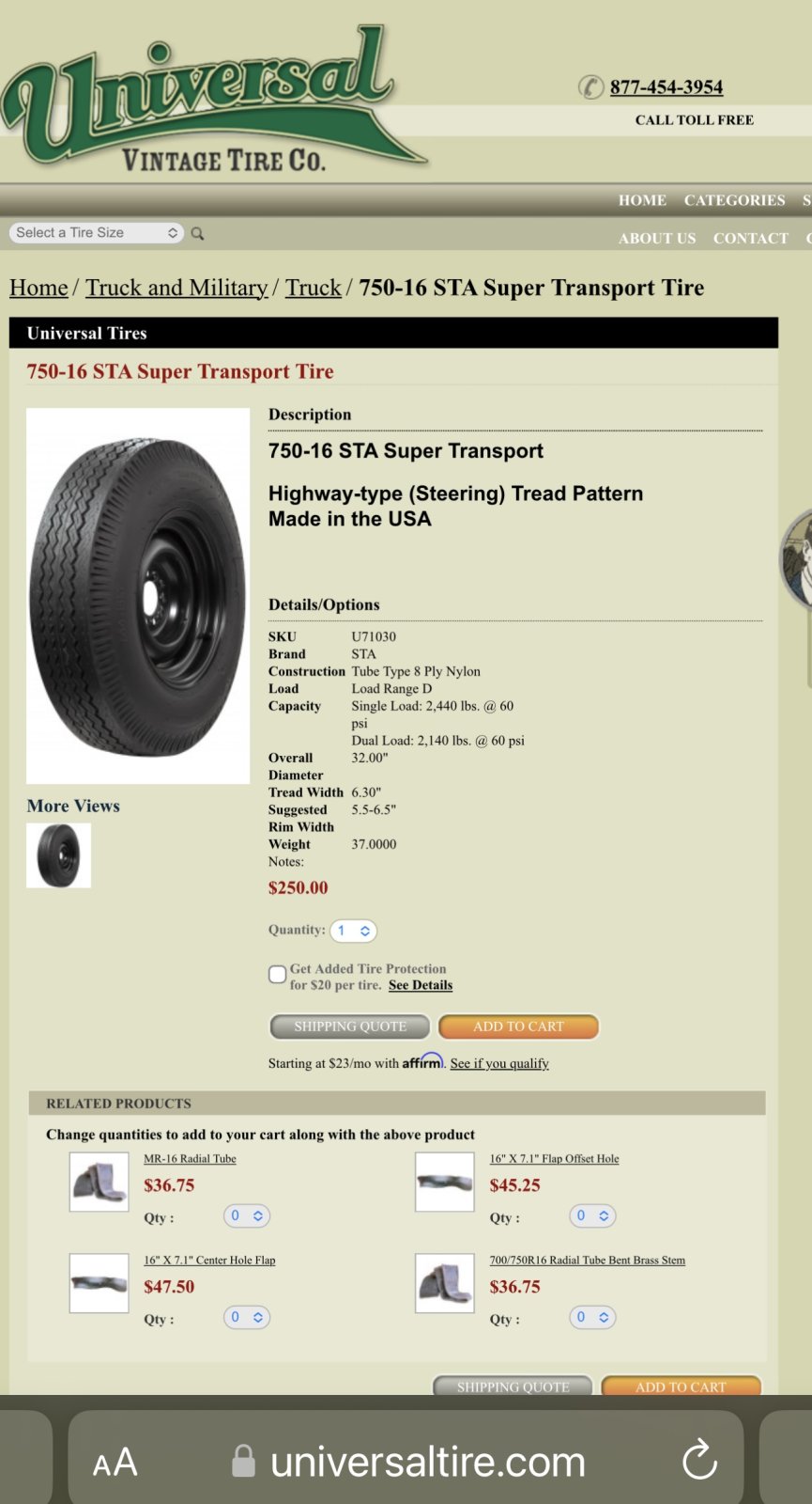

    Anyone tried these on the back of their Hotrod yet? Just curious

    60#'s of air pressure for a Load Range D tire? Lower the air pressure to anything close to getting a decent ride and the sidewalls are flexing to the point of overheating and failure. $250 per tire plus more than $80 each for tubes and liners, plus shipping?
    All the above except for the E Load Range and it's cheaper by $80 per tire. With this tire, you probably wouldn't even need air, the sidewalls would be so thick they would hold the weight of the car alone.
    Hope your health plan has a good allowance for chiropractic care.

  15. I’ve got that same tire on my 1950 3100 in the 6.50-16 size. They handle ok, I have them on all four corners. I can’t comment on the ride, because it rides like a truck. I believe mine say 60 psi on them as well, but I run 45 and they don’t seem to overheat. STA stands for Specialty Tires of America.

    Thanks for the input guys. It’s kinda what I thought but always looking for different options for a 6.5” wide wheel. The Firestone 750-16 I have are on 4” wide 5 wheels and I had Wheelsmith make me pair 6.5” wide, I’m afraid the Firestone tires will look like **** with the narrow tread pattern on the wider wheels.

    That tire is made for use on 2 piece wheels. That it is a tube type and uses a flap is the proof. The contour of the bead seat area of a single piece wheel is different from a 2 piece, so tires made for one don't fit properly on the other.
