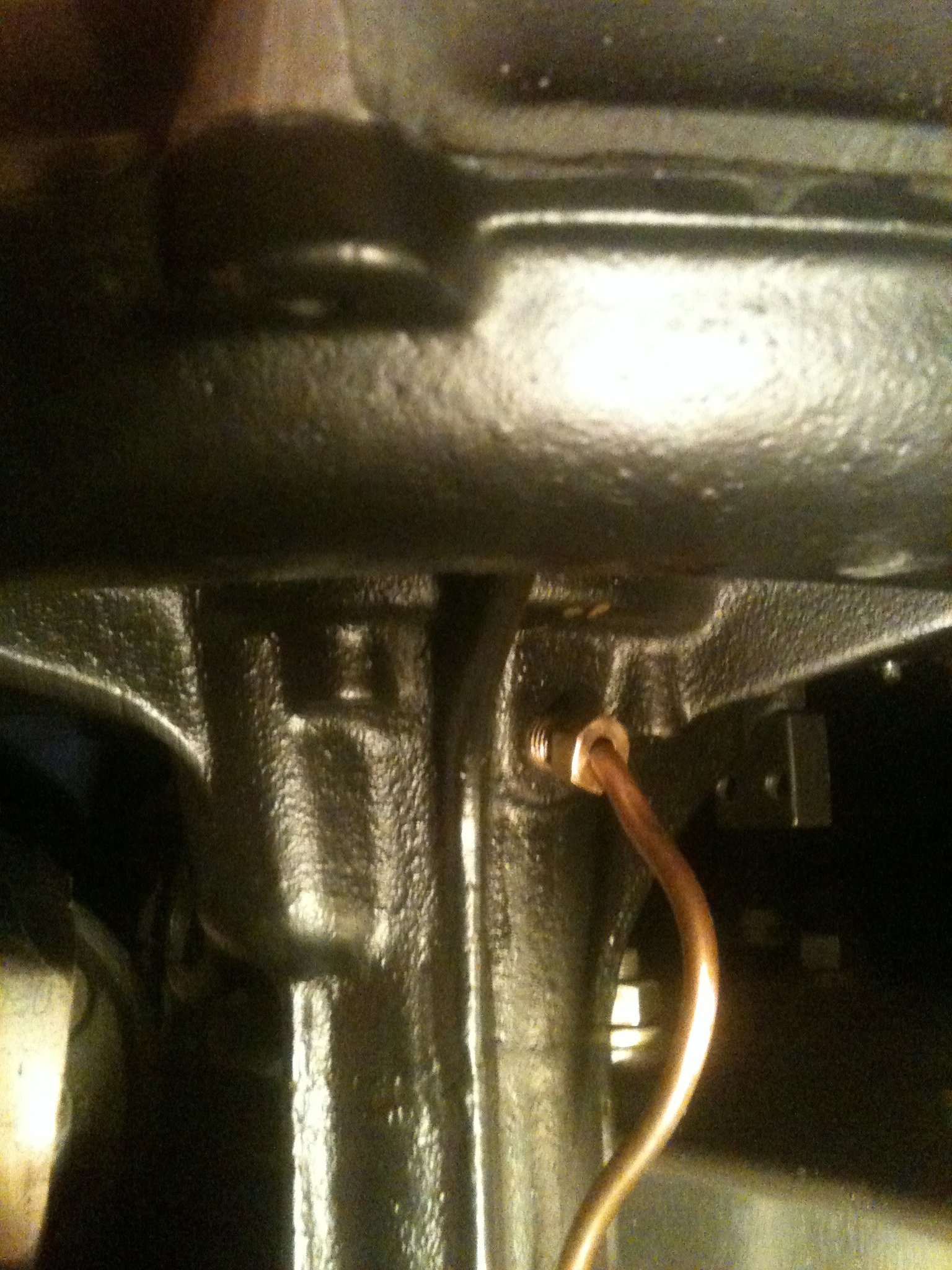

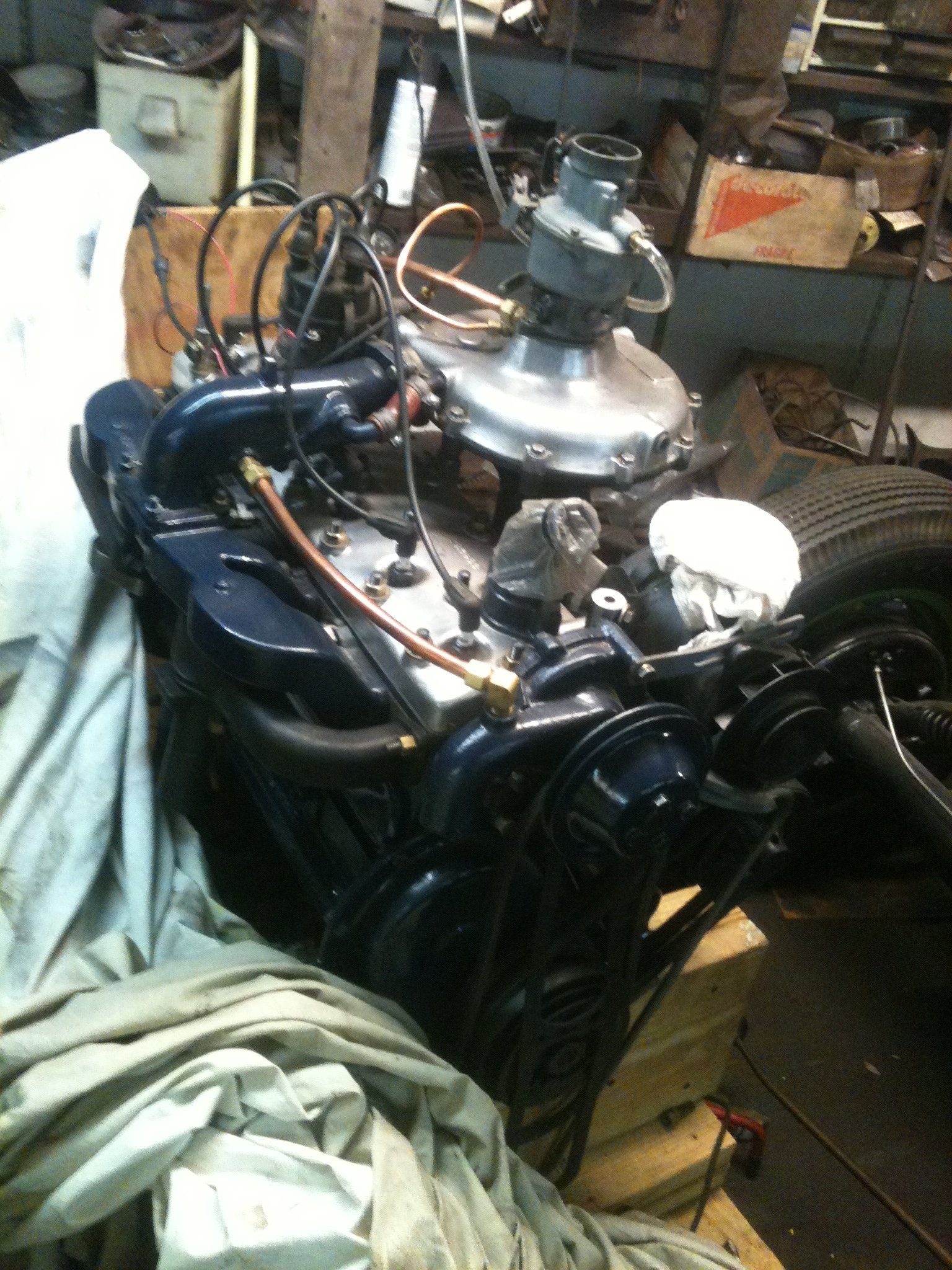

  25. Grahamsc
    Joined: May 13, 2014
    Posts: 466
    Grahamsc
    from Colorado
    image.jpg Love what you are doing here is the original 6 going in my 27 t roadster
    Dannerr and volvobrynk like this.

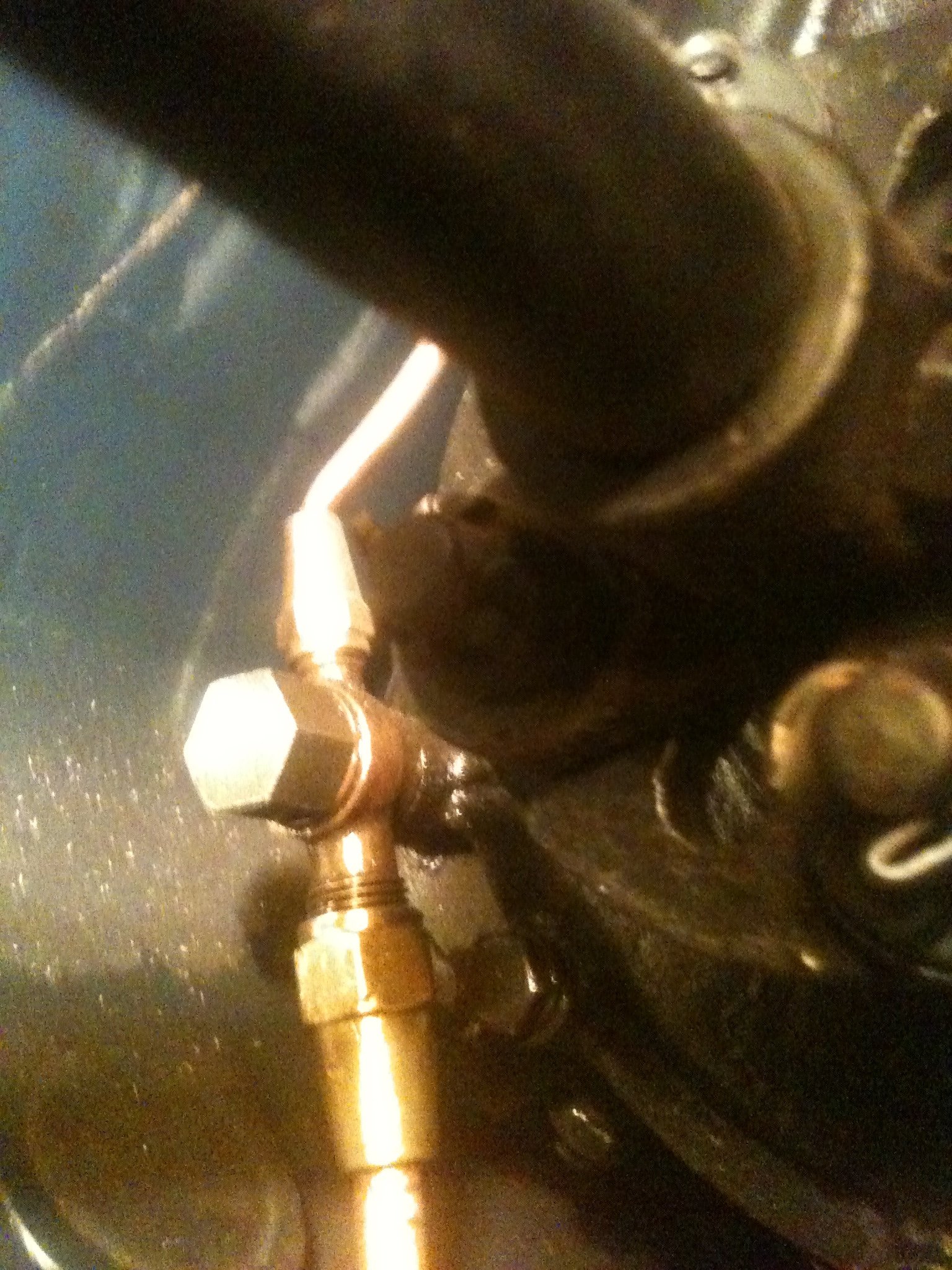

    Clark
    Grahamsc....cool!! Could you take a pic of the lower side of the blower. I could use some help with the plumbing of the oil.

  28. Grahamsc
    Posts: 466
    Grahamsc
    from Colorado
    Let me know if you need more
