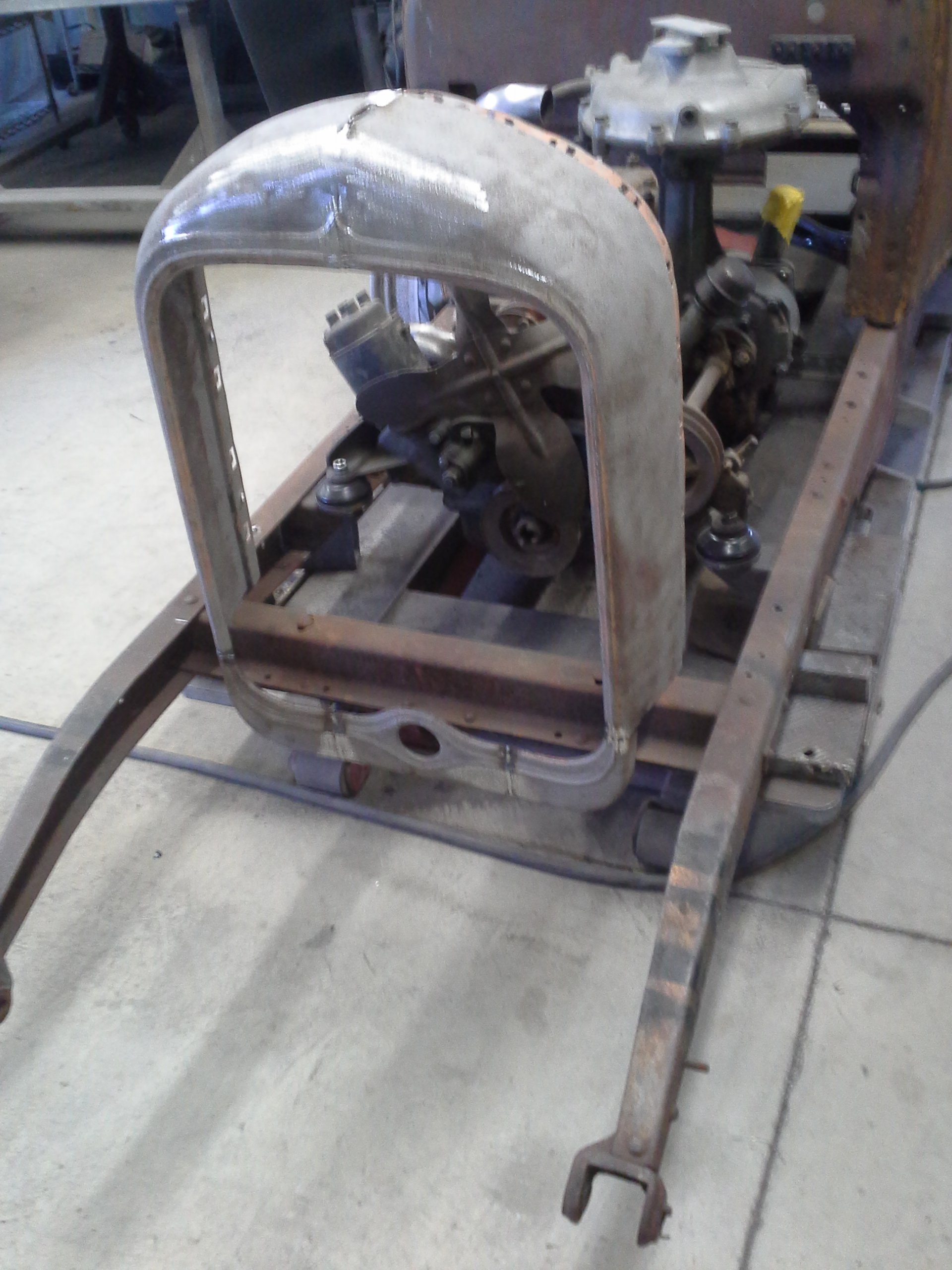

    Grahamsc...thanks again....right now im a little under driven at 5.5
    Mac... Here's the grill. I cut 2.5 out of the middle and 4 out of height. The emblem emboss was round with a bump out on the right
  3. Looks like '28 Studebaker (either Commander or Dictator), but the crank hole doesn't match- did you graft that in something else, or is the crank hole the original?

    Crankhole is original.....I cut either side of it so I could keep it. I found a couple that looked right but the crank hole didn't match I searched a lot of late twenties cars. It was chrome, so I doubt it was truck.
