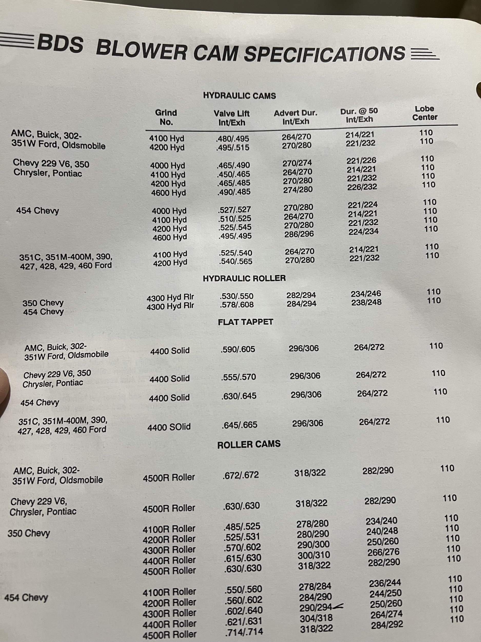

  22. Fifty5C-Gas
    Joined: Sep 1, 2003
    Posts: 1,445
    Fifty5C-Gas
  23. squirrel
    Joined: Sep 23, 2004
    Posts: 60,331
    squirrel
    that cam looks like it's what you want...
    Fifty5C-Gas likes this.

    That cam You looking @ looks good also to me , & If I had to buy New Rockers
    I would Experiment probably add 1:6 s
    I have 1:5 & 1:6 .
    I have use this under 400 cid ,
    Seems To For me worked well.
    H-Roller
    Thoe ,
    With out seeing on engine Dyno to see Results ,,
    I prefer over 400 cid sb .
