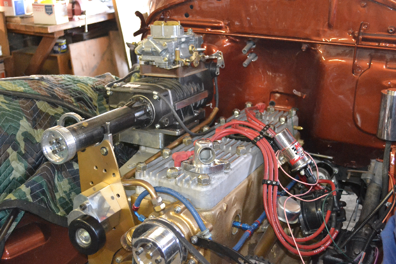

  12. Frankie47
    Joined: Dec 20, 2008
    Posts: 1,877
    Frankie47
    from omaha ne.

  14. RichFox
    Joined: Dec 3, 2006
    Posts: 10,020
    RichFox
    Jack; Have you ever seen Doug Robertson's Blown GMC powered 32 Coup? Doug did just that and sold them to anybody with money. Doug's car was fast as are all of his cars. Horsepower Engineering.

    Check out post #12 above. Decide how much boost you expect to get at WOT. calculate CFM in conventional way and ad in percentage increase you expect. I wouldn't worry much about exhaust unless you are going to add headers. Maybe go up 1/4 inch if you want to.

    Fuel pressure depends on your carburetor. Larger main jets would be called for, no doubt. On post 12 there are two roots type blowers on Hudson engines. One on either side. If you can't do fabrication, I don't know what to tell you. Any blower is going to require fab work.
