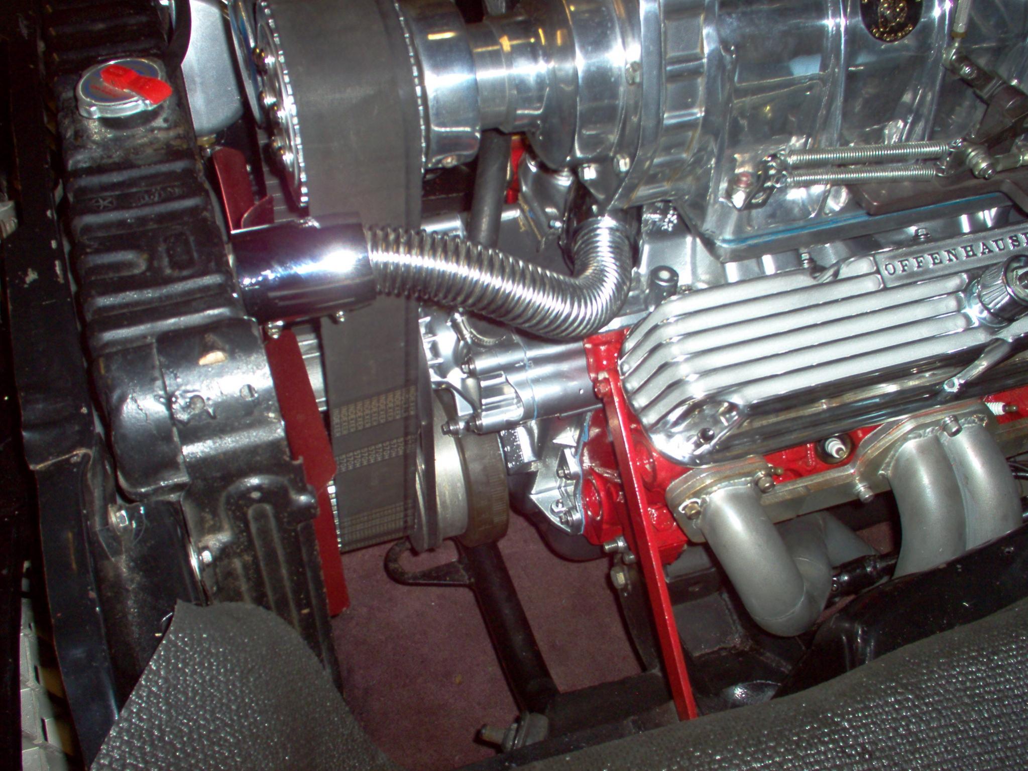

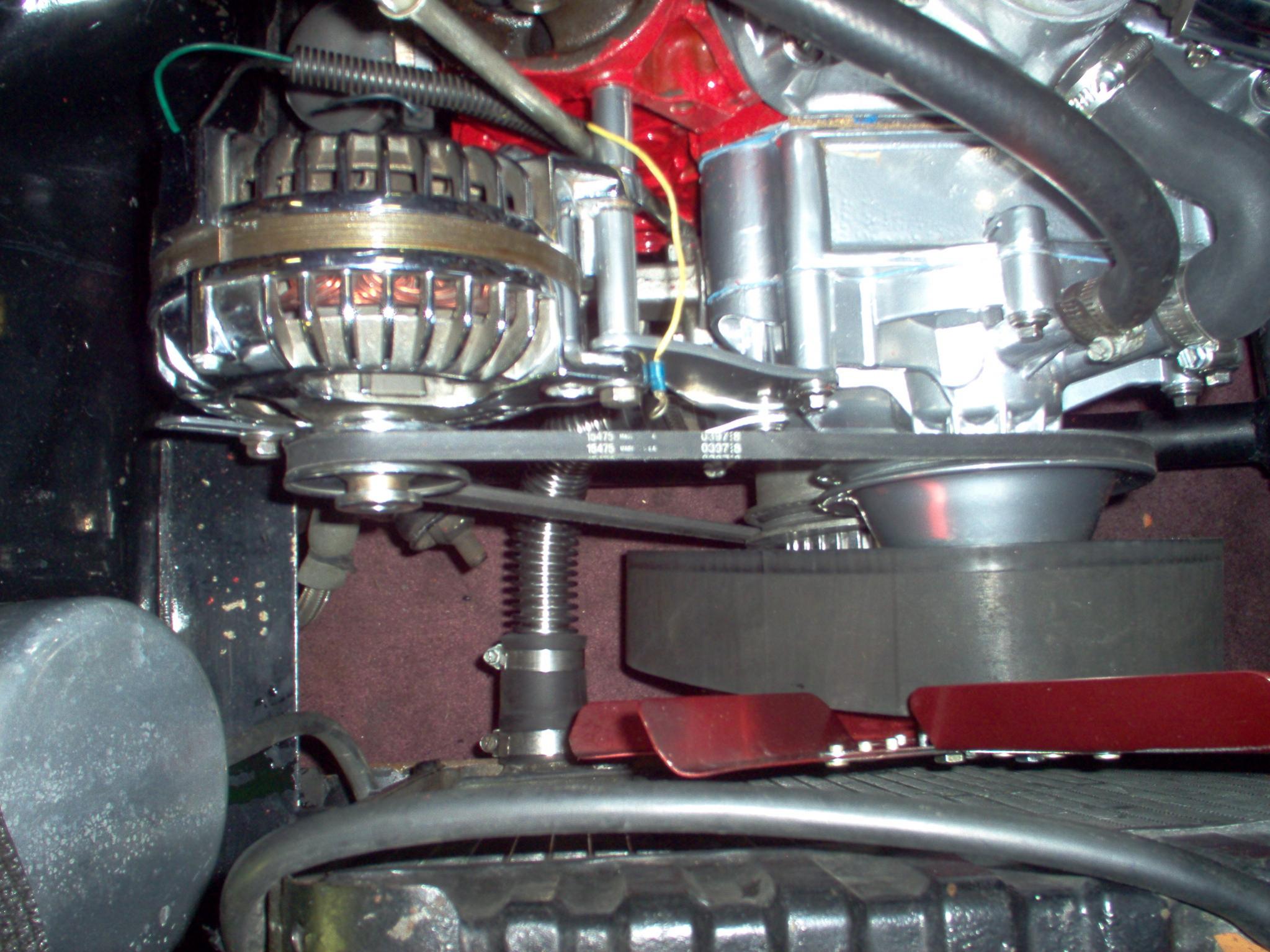

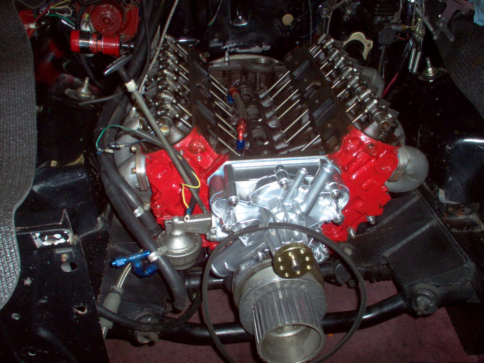

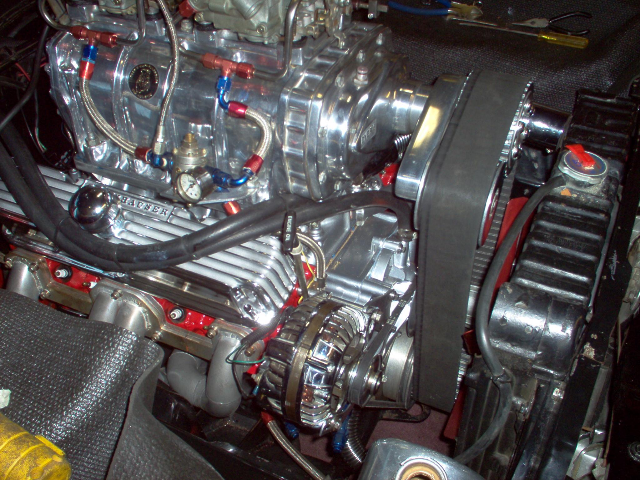

    maybe u can see here on my motor how mine line up,,, get all your normal belts and pullys in place,,then choose your balancer,,and lower blower drive pully,,,then figure out if you need to space out the top blower pully with a spacer from big als or dyers,,or bds,, or the lower pully,,if you dont have the blower dive pulleys yet,,,figure out if you will need to run a 2 inch blower drive or if you have the room for a 3 inch,,along with a fan set up heres a pic if it posts,,,
