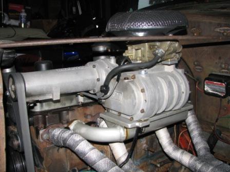

    Not supercharged but injection.
  3. haney
    Joined: Jul 14, 2008
    Posts: 150
    haney
    from Knoxville
    That's a cool setup. Any more info on it?

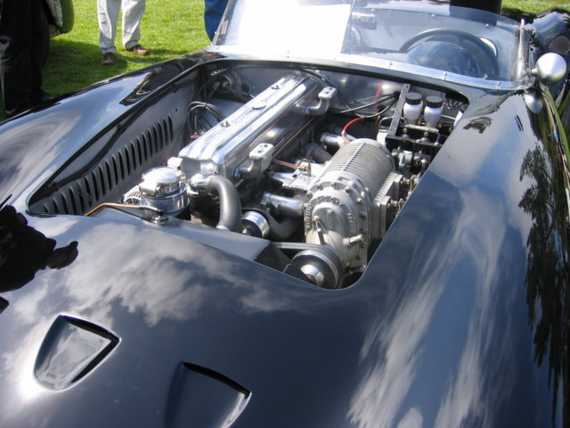

  5. RichFox
    Joined: Dec 3, 2006
    Posts: 10,020
    RichFox
    Thats some strange looking 235. Are you sure? What's the deal?
  6. Crestliner
    Joined: Dec 31, 2002
    Posts: 3,038
    Crestliner
    If its a 235 its sitting in there backwards with the bellhousing cut off.
  7. RichFox
    Joined: Dec 3, 2006
    Posts: 10,020
    RichFox
    Could it be one of those rare 235 Chevys that came with a Blue oval on them?
  8. boldventure
    Joined: Mar 7, 2008
    Posts: 1,766
    boldventure
    This as far as I know is the only Kurtis built with a Chevy 6 and a supercharger.

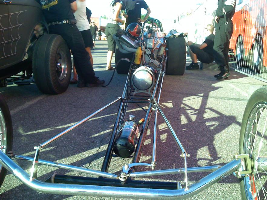

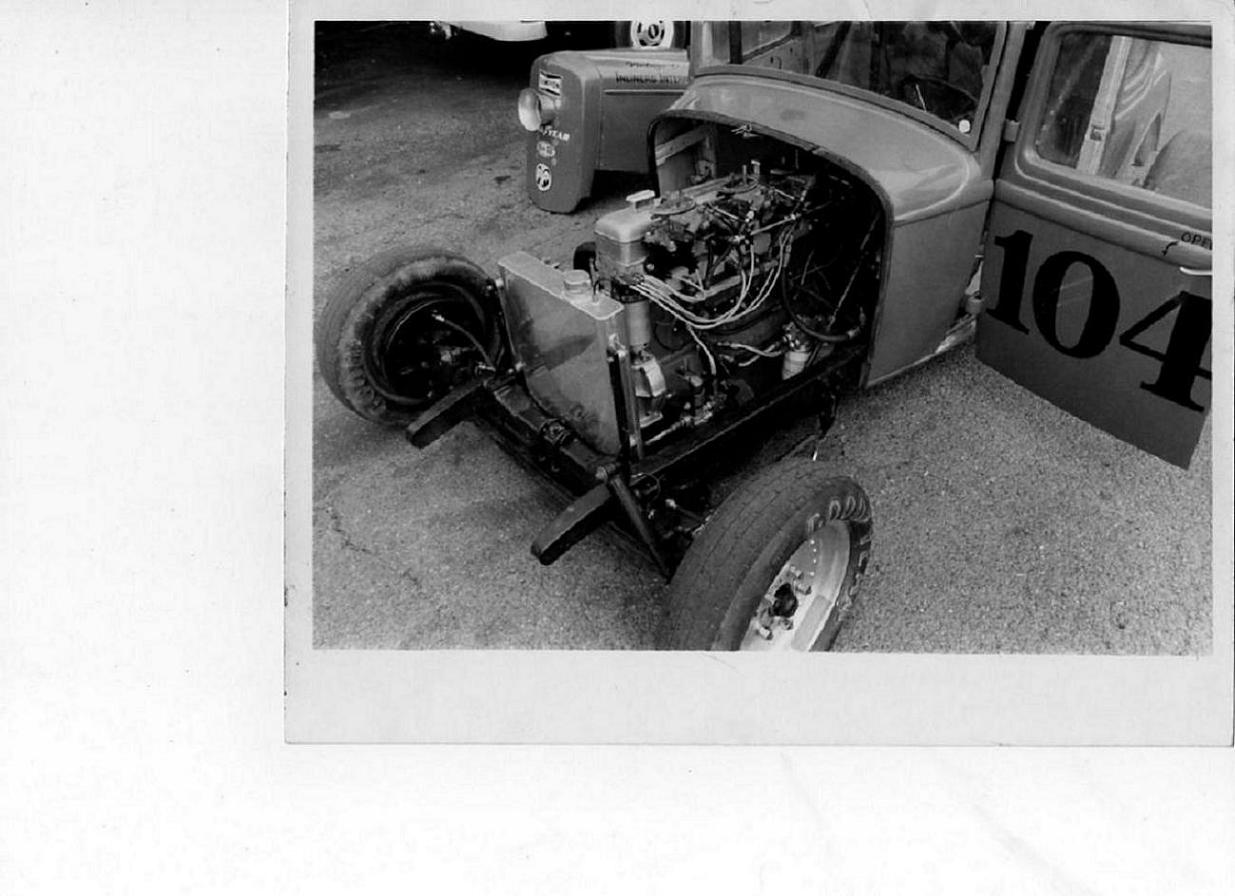

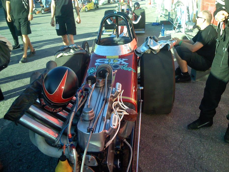

  12. RichFox
    Joined: Dec 3, 2006
    Posts: 10,020
    RichFox
    Close to a 235. missed by 35 inches
  13. draggin37
    Joined: Jul 14, 2005
    Posts: 189
    draggin37
    wtf...270? with single or twin turbo? front mount mag? more info please.....
  14. haney
    Posts: 150
    haney
    from Knoxville
    Wow those are cool
  15. RichFox
    Joined: Dec 3, 2006
    Posts: 10,020
    RichFox
    270, twin Corvair turbos (TRW) 302 head Moon cam (Potvin) The Black and white one has a Howard 12 port head, Horning front drive. Three 500cfm Holley two bbls.

  22. panic
    Joined: Jan 3, 2004
    Posts: 1,450
    panic
  23. haney
    Posts: 150
    haney
    from Knoxville
    So, judging from the article you can retain a moderately stock setup and run forced induction?
