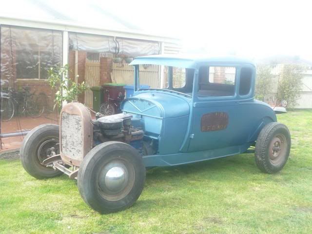

    there is a local one here in Adelaide/Australia that has a wade supercharger on the side of a 235 real nice looking setup. its in the current issue of chopped magazine(#2) www.chopped.com.au tells you who stocks it in the states, dont have a scanner, sorry.
