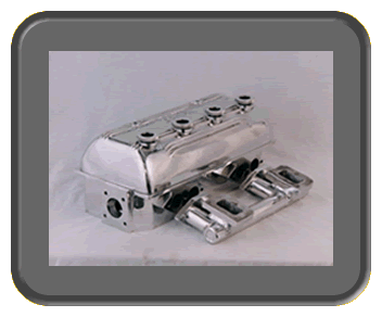

    Getting ready to build a model B (4) with a Ardun head. Anyone with information on supercharging (5 to 7 lbs) a model B, or sugestions for sources of such information. For example should I be overly worried about the strength of bottom end?? Thanks for your time and consideration. Tom

    I didn't know Ardun made a head for a fourbanger; tell me more and post pics.

    See flatheads forever, h&h antique ford, It is a billet, comes complete for around $3500. They make them on order, currently it takes several months. If it works as well as it looks I will be really happy. A ardun for a flathead v8 sells for over 13k new today, so I thought this was a good price for one head. I am hoping for 170+hp. But don't know if possible. What the hell life is but a challenge, but some are more fun than others. Help is always appreciated.

    Second Image:rolleyes:

    Yep, I think so. Everything I have always read ...and people I have spoke with tell me that Hemi chamber design like high(er) RPM (ie: Tuner Cars, etc.). An A/B bottom end can take alot of compression but I ain't so sure they are gonna want much 4K-5K "spinnin' on the reciprocatin' stuff".:eek: Maybe a Hercules 5-main crank installed will do the trick, or maybe a Model D block will help you gain the performance that Norm Frick has engineered into that head. Just my thoughts ...your mileage may vary!!
