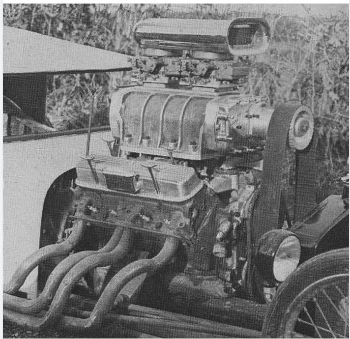

    Skärmavbild 2025-03-10 kl. 22.25.29.png I'd prefer to run a 2" drive also. Haven't seen any new stuff made so maybe have to search em out.the pic looks like 3" and stock intake made to work.ive got other pics saved
