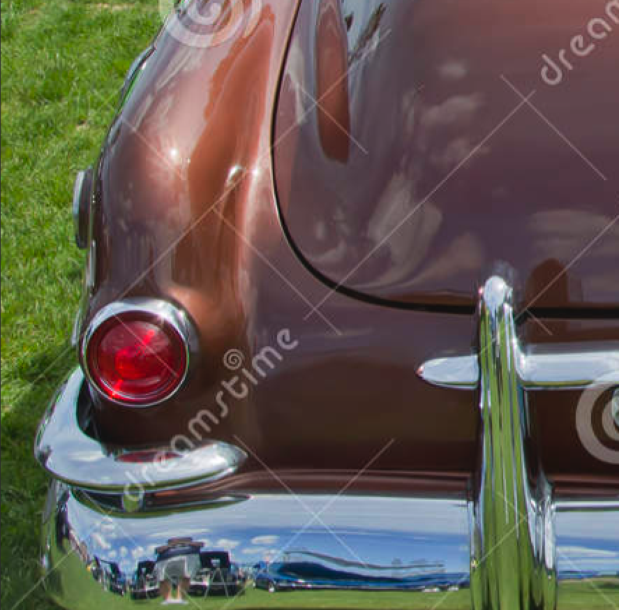

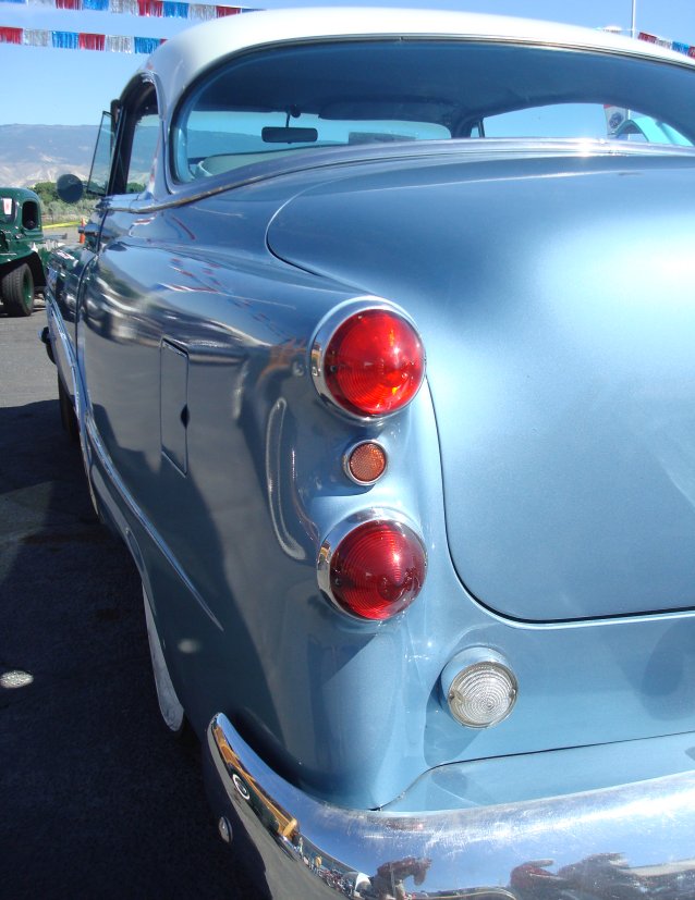

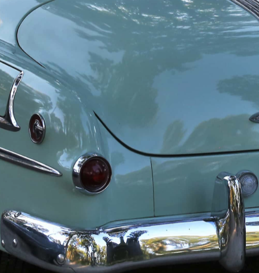

    53 Buick had a similar light as well, were there 4 lights on the car
  6. I like that those are a little more pointed, I wouldn’t mind finding some with more of a bullet shape

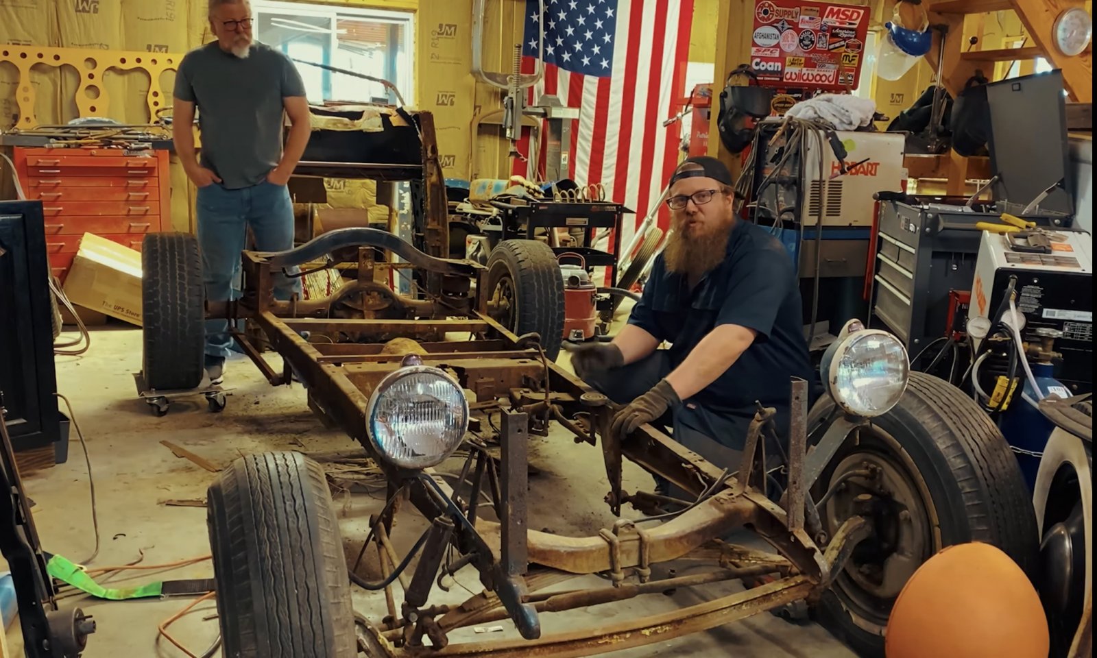

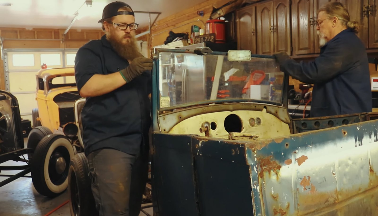

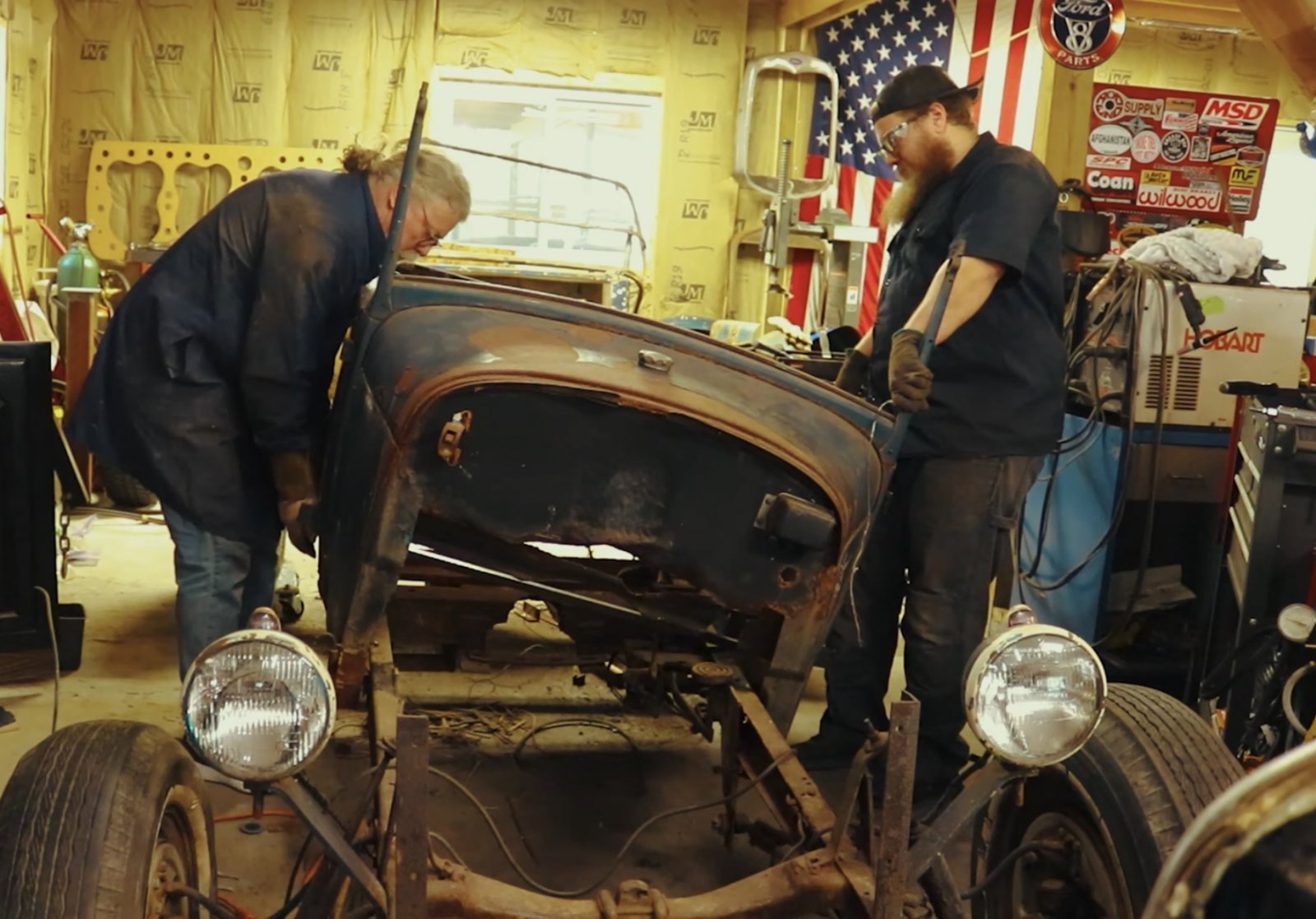

  10. Happy Father’s Day everyone! Here is my dad and I taking the Blue Martian apart! Full video will be up tomorrow night! 5A144140-814D-4EBA-81F4-82ADCADFC9A3.jpeg 7D1A7555-7DD5-4B7C-9643-24E71FC9EBE1.jpeg

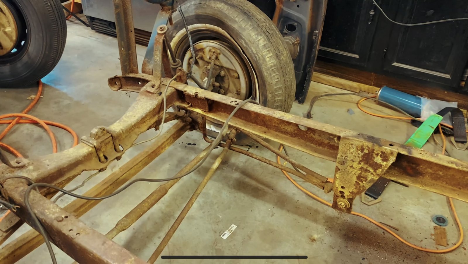

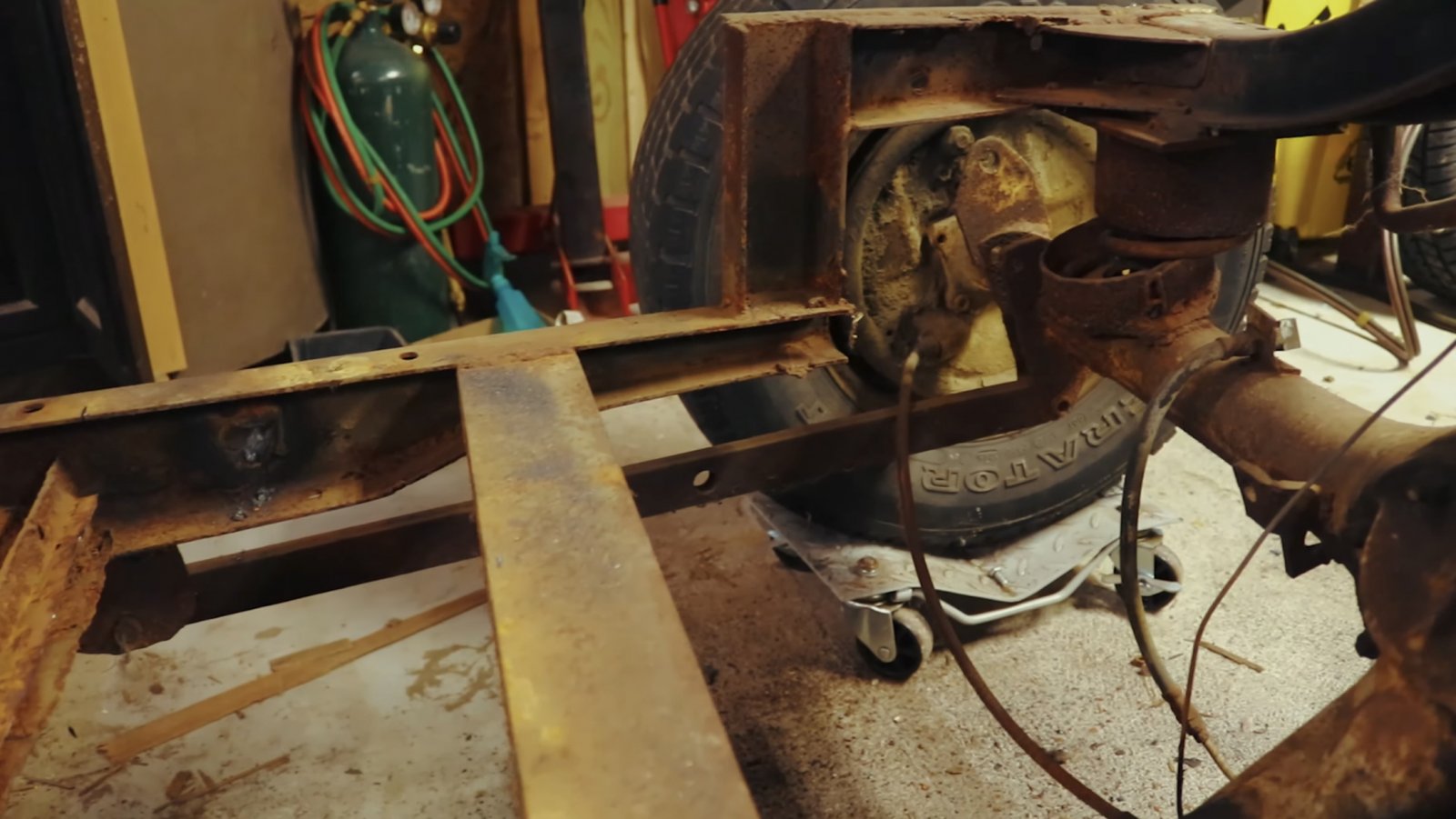

  14. The body was completely welded to the frame! Completely front to back! So we had to cut it all out DEB0651A-306C-4F8A-86C8-E5DEC21EB57E.jpeg 55C305AB-ADC1-4C4C-9991-EC32828D71C9.jpeg

    Not a survivor anymore.
  18. It definitely is. It’ll be driven and cared for again

    Still not a survivor when frames get replaced.
    chessterd5 and kevinrevin like this.
  20. I’m literally using every single part except the frame and putting it back to how it was built, the frame isn’t worth the time it would take to make it nice and usable to today standards

    Have to admit I was disappointed about the frame too. I understand the decision but I’d rather see the work to save it.

    But it originally wasn’t built to today’s standards. I do agree with making it safe and boxing plates around where the rear frame is z’d would do that. To me a survivor is a car that just needs the brakes and fuel systems and maybe the engine or trans gone through to be a driver. Anything more and it becomes a more of a restoration. When you blow the whole thing apart and have to take a torch to it to do it, it’s no longer a survivor. Replacing the hairpins with new ones. It’s a modified restoration to your vision not the original builders. Just my opinion.
