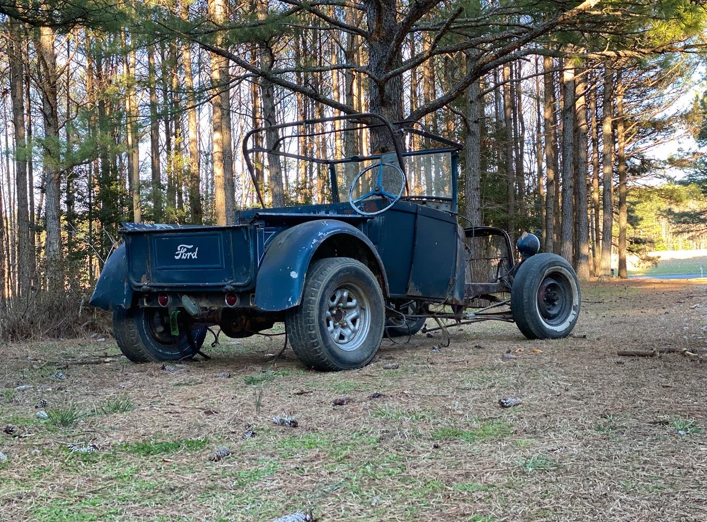

    I am nobody here, but it is pretty clear from the pictures that the frame wasn't up to snuff. If you can make a real driver out of it and keep the patina, you have saved the best part of that car. Sometimes you don't want to save the old as much as you want to build it in a way that the original owner would have done it if they had had the ability and resources. Look at that frame and some of the suspension pieces and tell me it isn't a little shaky.

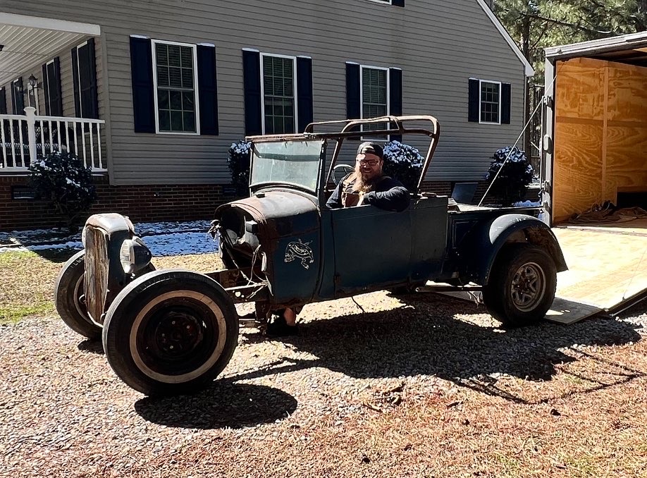

  3. I talked to the original builder and he is super happy that I am redoing the frame, he even said the car would twist while driving even with the body welded to the frame

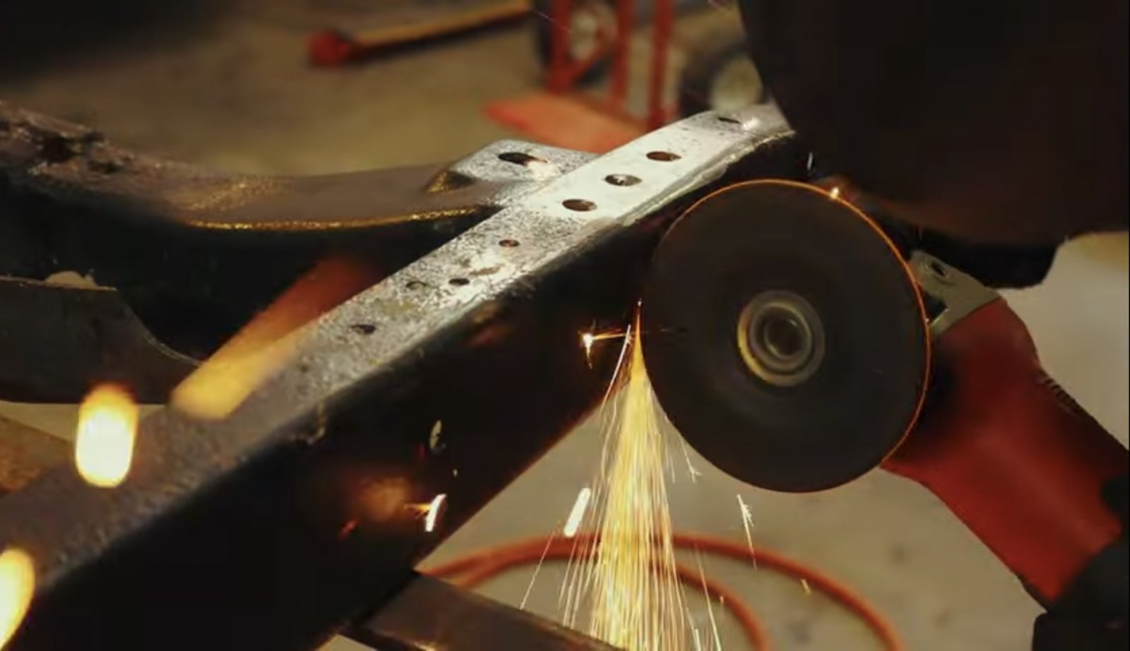

  8. We are getting the frame stripped and keeping all usable parts!

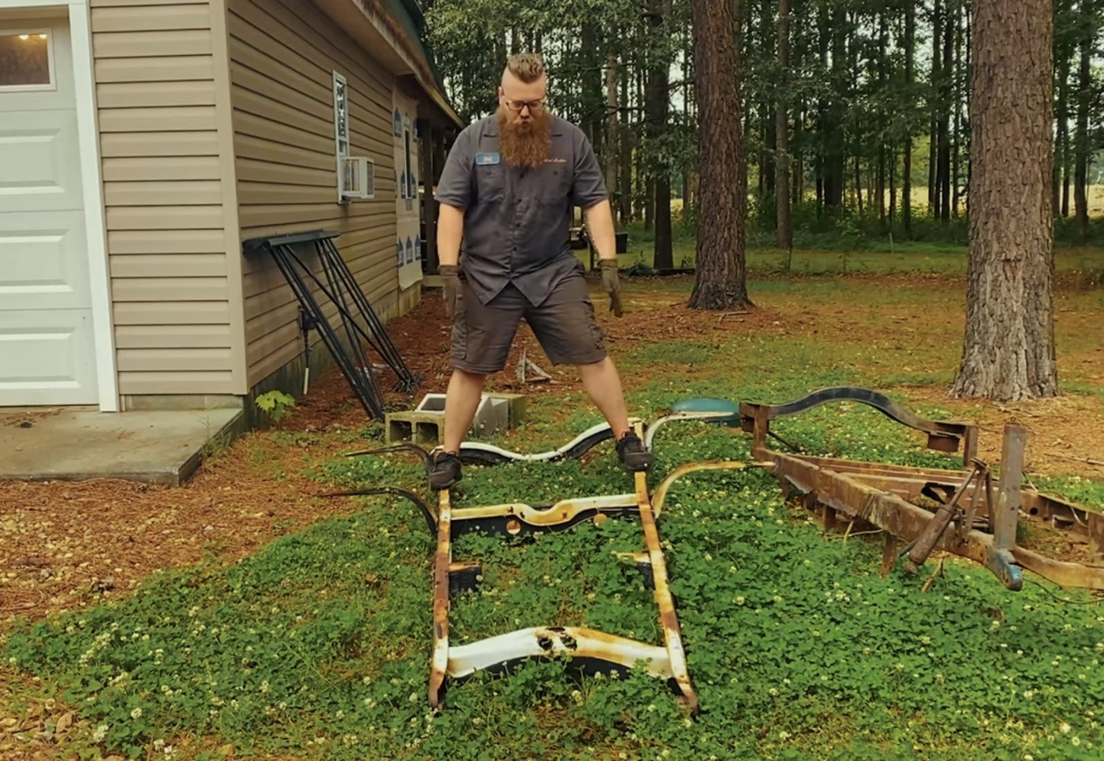

  11. I demonstrate why boxing a frame is important and show you why you need a frame table to get a straight frame when boxing! A lot of flex! B6238A49-836F-49E9-B77F-1DE7B4595422.jpeg

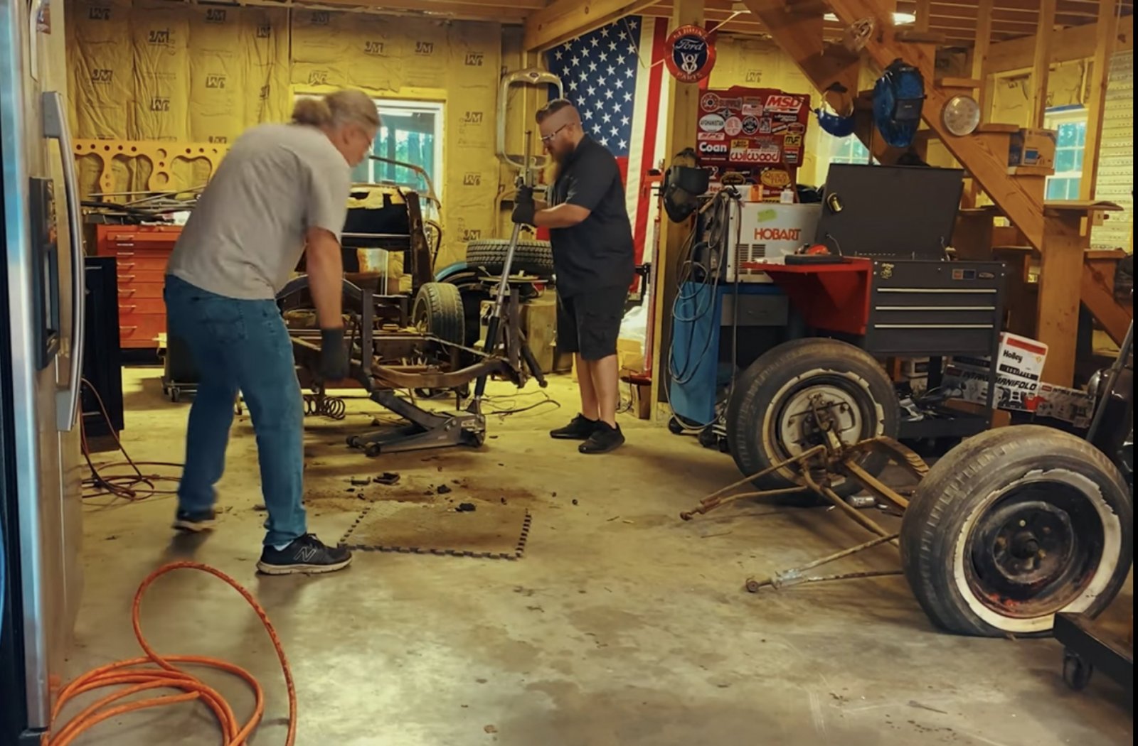

  12. We made a jig on our homemade frame table! It will be removable in the jig so I can flip the frame upside down and do my finish welding on the bottom! 1AA8F9A6-4CFE-49EC-BAAA-20230B7A2563.jpeg

    I don’t think that much flex is normal in an A frame! I had a very nice one that we couldn’t get to twist at all even with two grown men standing on opposite corners.

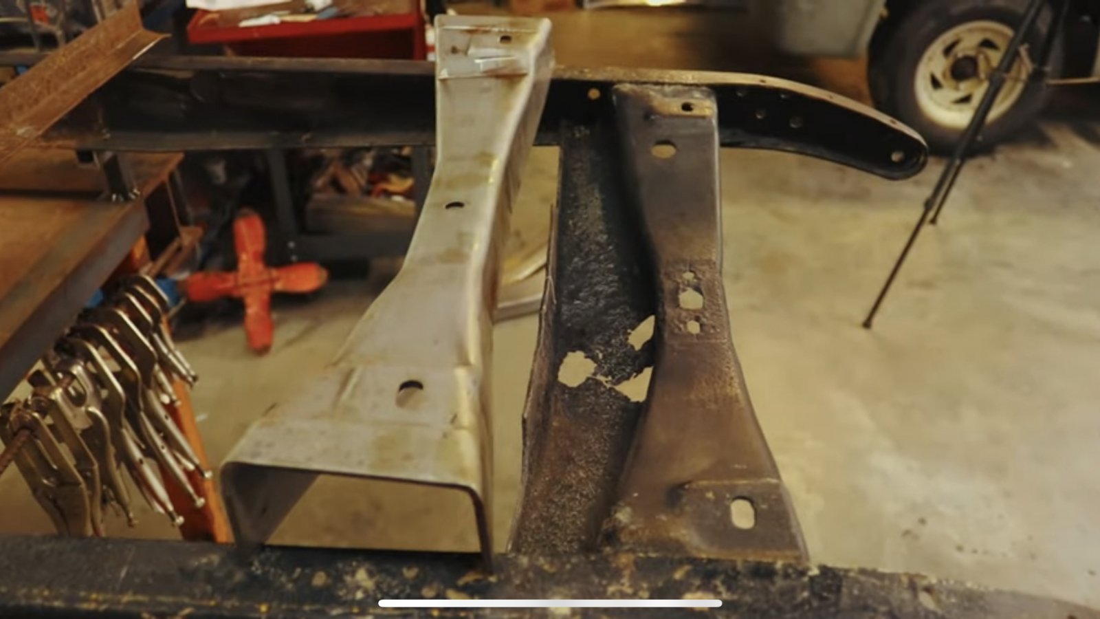

    Was the front x member in the 'new' frame unservicable?

  20. My frame was upside down and rocking on the rear crossmember, but they all flex, from what I remember Ford bragged about the frame flexing saying something like Flex not bend

  23. If you mean the crossmember then it was in okay shape and I saved it incase another A frame needs one, the front crossmember was unusable though, cracked and pitted really bad, couple big rust holes

  26. Happy 4th of July everyone! Here is a picture of my old and new crossmember!
