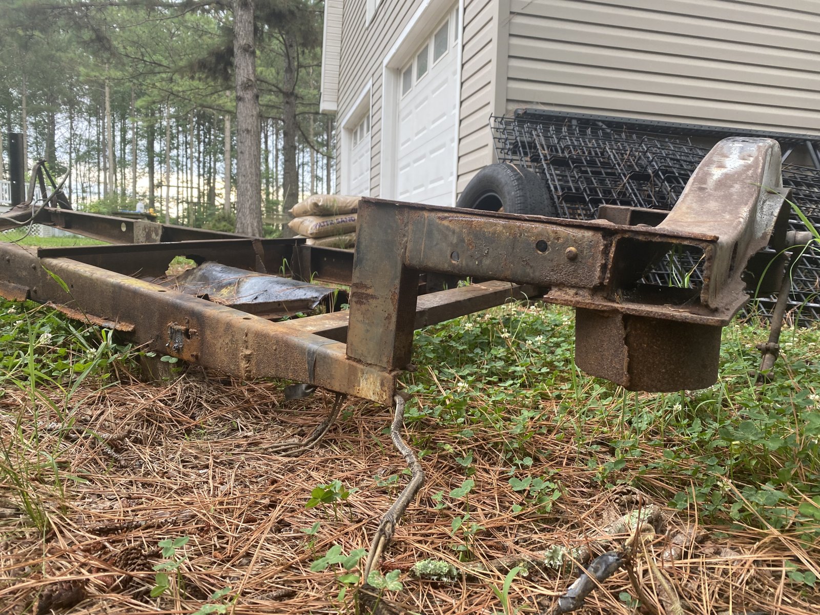

    Question,
    Are the frame boxing plates fully welded in all the way around?
    Or are they s***ch welded in various places?
    It looks like it in the photos.
    Will they be fully welded later after the frame design is finished and all the mounting is worked out?
  4. At the moment they are only s***ched welded all the way around, I still have a transmission crossmember and the k member to weld in, once everything is welded on the frame it’ll probably take me a full day of fully welding the whole frame

    I understand. I have done it too.
    It is all the frame flipping and the jumping back and forth from rail to rail keeping the heat down so you don't warp it that takes all the time.
    I'll be watching. I want to see it's rebirth.
  6. Labor of love that’s for sure haha, thank you!

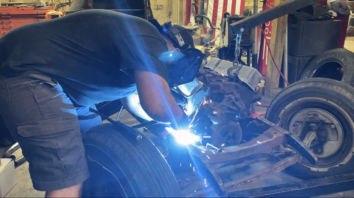

  15. Back on track! Finally got some parts in that I have been waiting for! Got the motor mounts in and the transmission mount, picked up a 700 transmission too so should be a good highway driver, axle is from a 1954 F100 with 3.92 gears, the original Blue Martian axle was blown and will need a new 3rd member, I plan to use the F1 rear axle and eventually rebuild the original Blue Martian rear axle and swap them out!

  16. Welded on some spring perches from Millworks Hotrod, pinion angle set to 3 degrees and perches welded at 0 degrees, I do the 3 up 3 down rule

  19. Welded in the motor mounts and all transmission and rear axle angles are good to go!
    Squablow, deadbeat, guitarguy and 3 others like this.
  20. The K member is done! 4 link is ready for an alignment!
