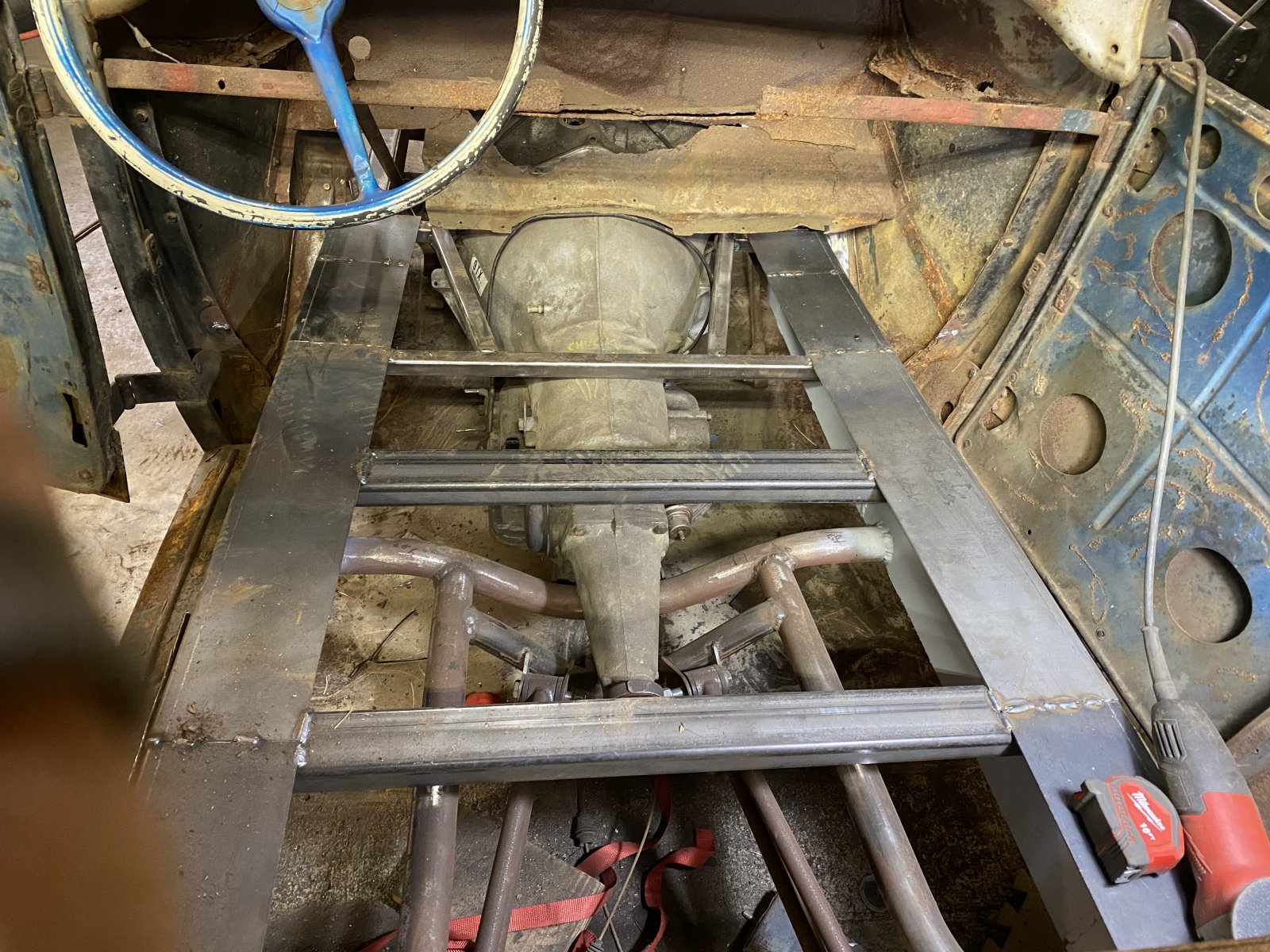

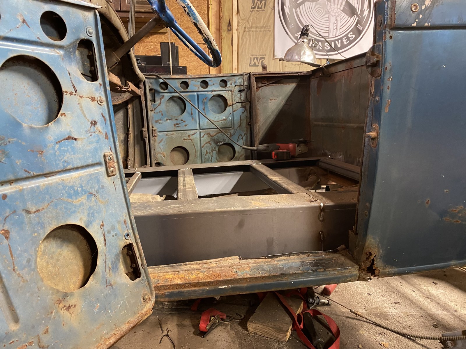

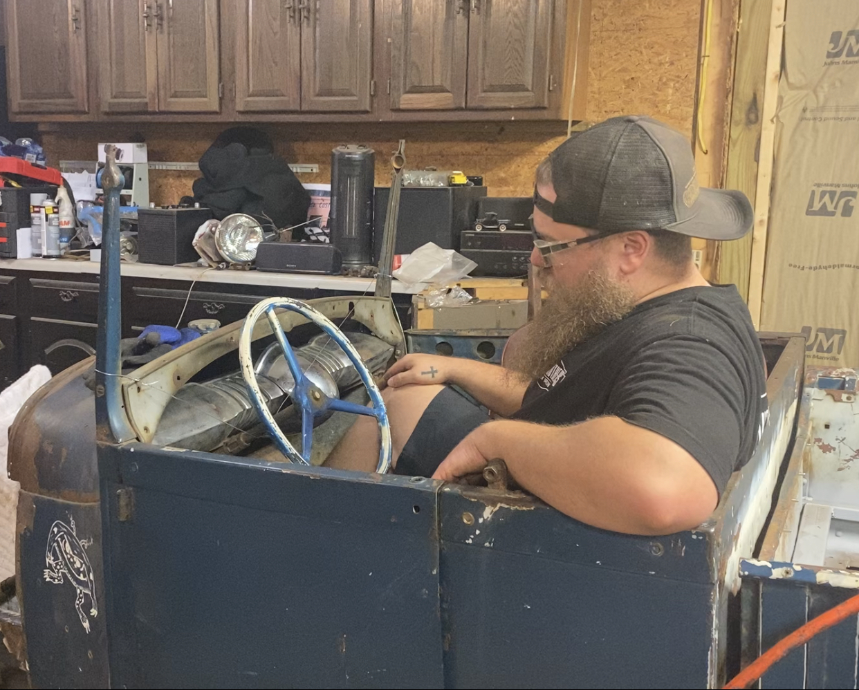

  1. A51163D5-E0E0-4316-A9A6-6867777AAFC5.jpeg 982C5AED-4E4E-4DF8-9180-9FF57A3E39CA.jpeg 03F5BBDD-5492-4773-8670-9C22E06DAD68.jpeg Hi guys! Still working here! Channeled the floor 7 inches! I think it turned out well.
  2. That’s deep man.

    Yeah, real deep.

  4. Yes sir! The truck was originally 7 1/2 channeled, I thought 7 looked better
  5. Hey thank you for watching!

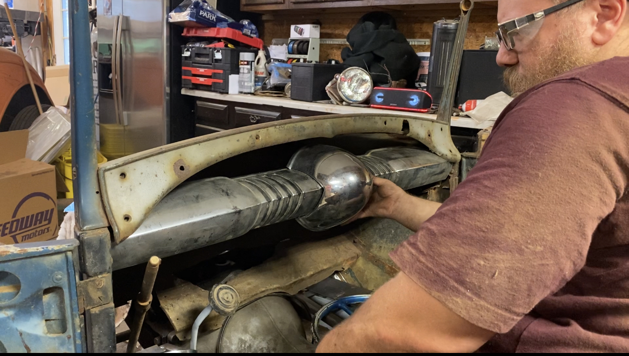

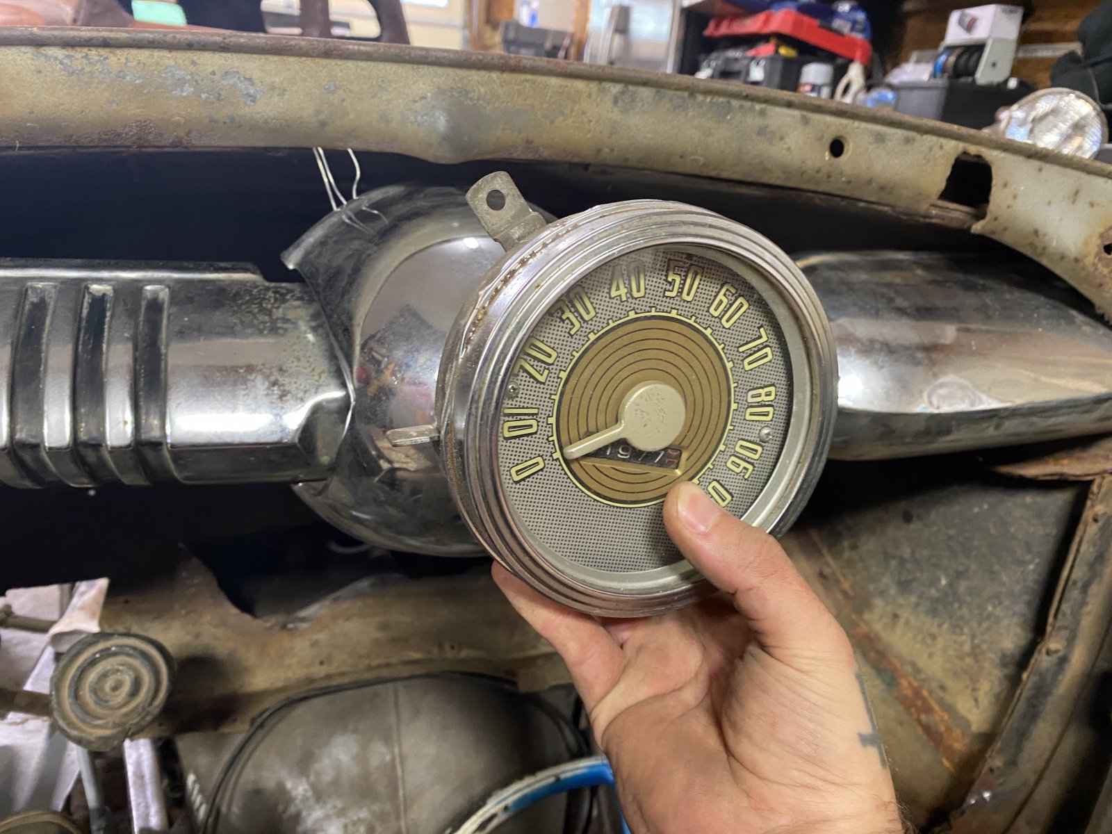

  6. I was looking around the garage for some kind of dash, came up with this! Kind of bulky, but after cleaning it up and adding some gauges I think it’ll look good and not like a ratrod! Going to cut the tip of the bullet out and put in my 1947 speedo, then hide some smaller gauges just above the grill bar

    Props to that, pretty beefy structure to securely pull things together AND it's shiny...the fun of stepping back...

    Feel like it needs a filler for that gap between the 53 grill and the top... unless im missing something
    Wired Customs LLC and Stogy like this.

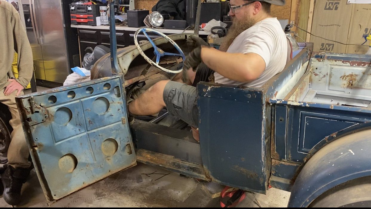

    In my 29 myself I am 5'11", it's unchanneled and have considered moving my s**** pedal over more towards the center...having something there would take away in that small space...
    LLC is going to have to get crafty with the interior as he's fills that cabin up his knee is inches from the proposed chrome dash...this has been mentioned regarding pickups which I suspect RPs are in the same family as
    @Wired Customs LLC are you able to sink the seat into the floor between the frame...you actually still sit pretty low in it now considering it is channeled...which is nice...I see it had a bench seat and your Artwork shows one so I suspect it will be pretty minimal...challenging really...

  16. I actually plan to have a filler above the grill, it’ll be white pleated leather and that is where I am going to put the rest of my gauges

  17. I’m going to use the top of the transmission tunnel to put my let and the gas pedal, the only thing that can give me leg room at this point would be to extend the whole cab

  18. Yes sir! That gap is where the gauges are going, maybe a couple switches for lights and coil b+ power

  19. I’ve tried a couple different seating positions, I have my brake pedal all figured out and have my column placement finalized, so far being 2 1/2 inches up off the floor has been most comfortable, or at least as comfortable as a 7 inch channelled RPU can be considered

    I've been following this thread and I appreciate what you're going for. Safety. Reliability. Legacy. Maybe it's just personal taste, but I feel like the dash doesn't fit with the rest of what's going on. The car is already an attention-grabber, and it doesn't need a full-size car grille in the interior for people to take notice. A flat panel with a couple of original, era correct gauges would do just fine. Just my two cents.
  22. I really wanted a 55 T bird dash, but this is the only shape I had that I liked, it had a flat dash in it when I got it and I did not like it, I always like a really pretty dash in all my rods, I’m going to run with this for now, hopefully I can find a 55 bird dash eventually

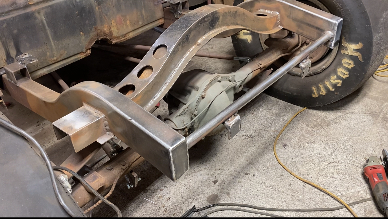

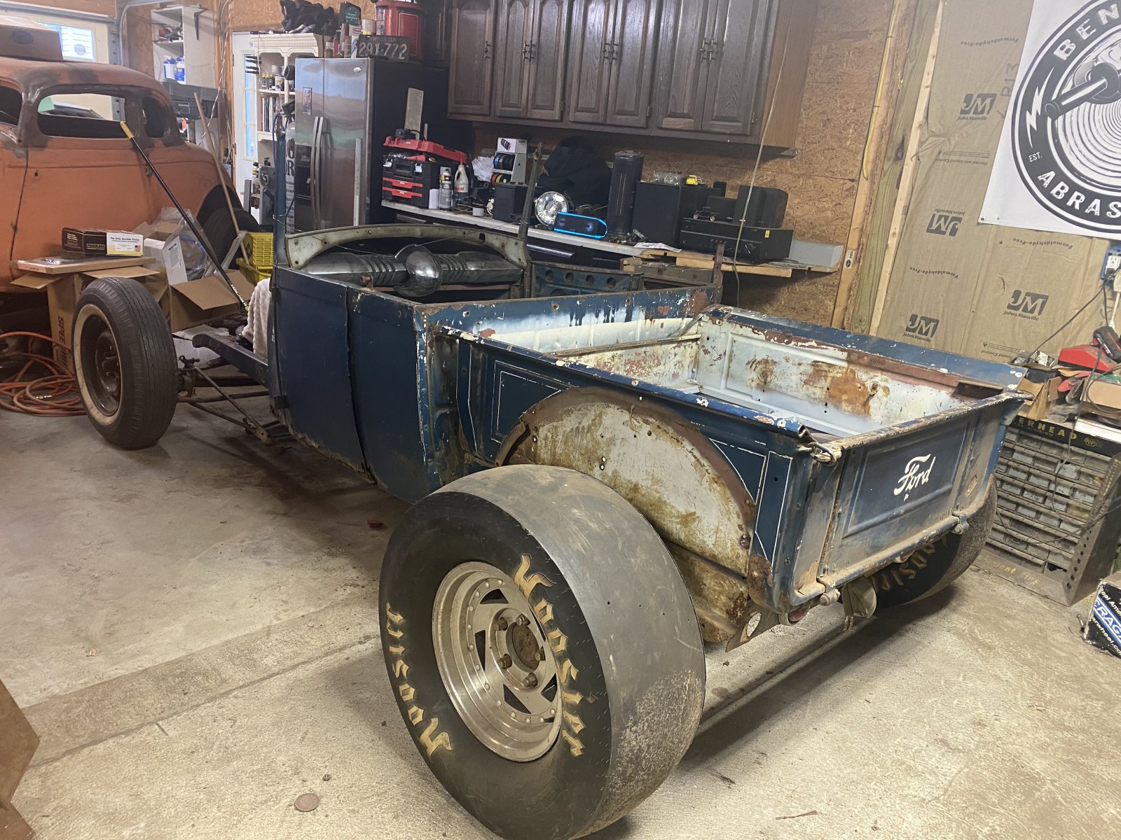

  26. I’m pulling the truck apart to paint the frame, and I have to say it does look pretty cool without the fenders too! C707BF0F-EE15-47DC-9362-0A6847AFE102.jpeg

    I like the truck.
    I don't like the dashboard.
    IMHO you are going to have to do a lot of work to make it look like it is meant to be there.
    When I originally started following this thread I thought that you were going to rebuild a survivor. But enough things have changed now that I don't think that is true anymore.
    Will you be replacing the front hairpins as well?
    ralphson, J.Ukrop and Dick Stevens like this.
  28. When I first saw the truck I wanted to bring it back as a survivor, and when I got all the back story of the truck the plan was to build it back to exactly how they built it and put it back on the road the way it last was in 1972. When I finally had the time to work on it and take it apart then I realized it was too rough to leave it as is, as in it is pretty rusty, no floor boards lower door and lower cowl are all pretty rough. Also after dis***embling it down to bare frame I realized the frame was also unsafe. I could’ve spent hour and hours trying to bring that frame up to being safe, but I build 4-5 cars a year, and spending that much time on a frame just wasn’t realistic for me, so I made a frame from a stock A frame in respect to the original build instead of buying new or the easiest option of building a frame from scratch (which is the fastest option) after that the rest of the truck is pretty close to how it was in the mid 1960s, which is confirmed by the original builder Mark Hose as we talk regularly and I keep him updated on the build, he says I’ve really done the truck justice and that to me is a huge accomplishment. As far as the dash I can understand, it’s a little odd, but since it’s a 1960s rod and not a 50s rod that really opens up the custom aspect, the dash is from a 1953 car, so that keeps it in the timeframe, they were really doing some cool custom stuff to roadsters in the 60s. I didn’t have any dashes laying around and I’ve been investing financially in the truck pretty hard with all the new mechanical parts, so buying a complete dash was out of the question, so I was digging through my stuff to see what I have, this is what I found and came up with, it was free and looked “spacey” since this is the “Blue Martian” also I’m not done with it yet, it will get a 1947 ford speedo where the bullet is, and I want to get some Stuart Warner gauges for the rest. For the front hair pins I have to replace them, if you could see these ones up close you wouldn’t trust them to drive 60mph down the highway and I plan to drive this truck a lot, I got new hairpins from Millworks Hotrod that still fit the time period. This comment isn’t me arguing with anyone, I respect your opinions, this is me just explaining my train of thought and to let you guys know I can’t waste time with a project sitting in the corner at my shop, everything has to keep moving, also since the truck is so rusty I do plan to eventually fix all the rust and paint the truck, it’ll be the same shade blue but metal flake and have a white frame to keep with the 1960s white wall tire roadster look.
