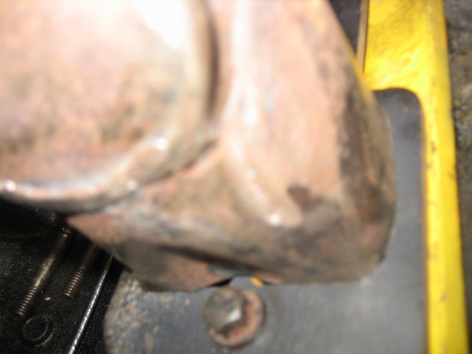

  6. dana barlow
    Joined: May 30, 2006
    Posts: 5,429
    dana barlow
    from Miami Fla.
    034.JPG 035.JPG Fitting the log I pre fabbed,were the log runner comes too close to a bolt,I made a indent for spacing,one of these in up front,the other in rear,before tack welding things in place. The plane is to tack every thing and mock up the carbs and linage before total welding. That way I'll besure it all works together.

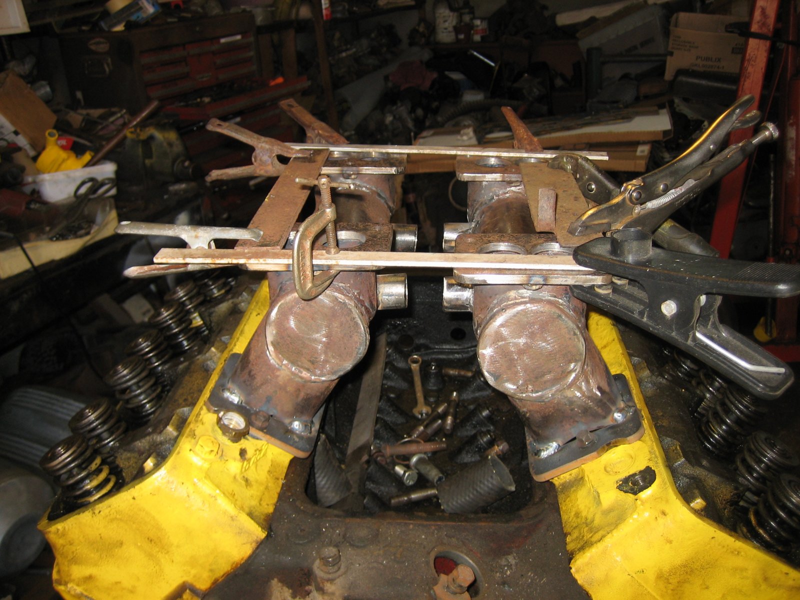

  7. dana barlow
    Posts: 5,429
    dana barlow
    from Miami Fla.
    All set up on old Y-block on stand as a test jig. With logs tacked in place,next was to add carb plates an be sure these were level an strait with each other. Don't want carbs all williy nilley looking. So did this to keep them good as I tack weld. 039.JPG

  8. dana barlow
    Posts: 5,429
    dana barlow
    from Miami Fla.

  11. dana barlow
    Posts: 5,429
    dana barlow
    from Miami Fla.
    Tacked together some linkage,still going to need a few more do dads and springs ect. before desiding if I can fully weld all this stuff together.

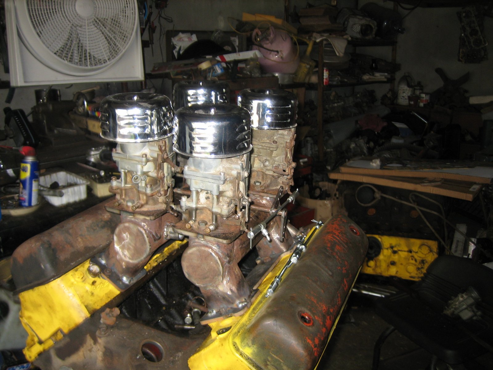

  13. dana barlow
    Posts: 5,429
    dana barlow
    from Miami Fla.
    For now was thinking gloss black on log intake an carb bases yellow,just clean up rest of crab best I can. Maybe much later polish carbs to shine

  15. dana barlow
    Posts: 5,429
    dana barlow
    from Miami Fla.
    Need to make a run to hardwear store for stainless steel bolts I'll polish an some springs.Weld on some spring brackets and all the rest of were its only tacked together. Then rebuild the carbs too along with paint,aways to go yet.. If I did this again,I think I may try for even shorter runners to lower it some more. I think it's going to look pretty good when done 048.JPG

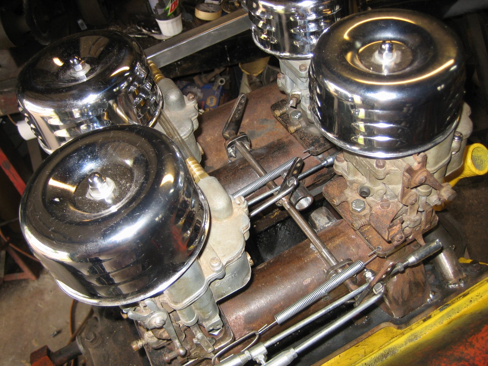

  19. dana barlow
    Posts: 5,429
    dana barlow
    from Miami Fla.
    Did a little more messing around with 4x2 carb linkage,so here is update. Will make some fancyer adjustible adtachmints for springs vs the bent wire "C"on it now,these 2 spring feel like they should work good. 005.JPG

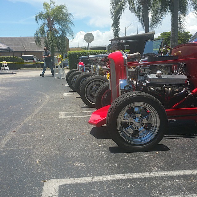

  28. dana barlow
    Posts: 5,429
    dana barlow
    from Miami Fla.
    At the 3rd july show late yesterday ,my buddy Mark was there too with his very cool 32,he did get a GOOD photo of my 28A bobtail, all dolled up for the 4th in stars an strips! My hotrod never looked better! 2015july3show.jpg
  29. Hankster32
    Joined: Feb 28, 2009
    Posts: 33
    Hankster32
    One gas tank is a beer keg the other one looks like a speedway . The one in the middle is a moon?
