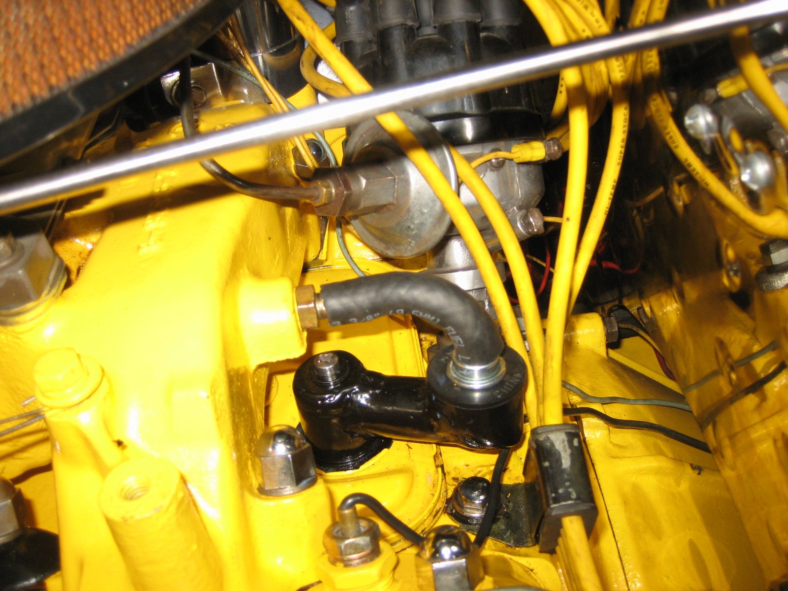

    Added a PCV to my old Y-v8,did it so I can move it around a little when I add the 4x2 log set up an run the tube to center cross overs of log. For now it's hook up to the 4bbl intake and seems to work . The old road draft tube just got cut and angled to fit the PCV. Should keep any oil leaks away.

    Dana, that will need to go to the carb base, as is will make those two cylinders run lean. JW

    This PCV is temp tell I put the new 4x2 log on ,and then PCV hose will go to center cross over balance tube between logs,that will even out draw. But even now in 4bbl intake dose not show any lean on the back plugs,my guess is oil vaper makes up any def in mix. But I'm watching it,I don't have a plate for base of 4bbl carb with a hookup an nether dose carb so did it this way for now.Thanks

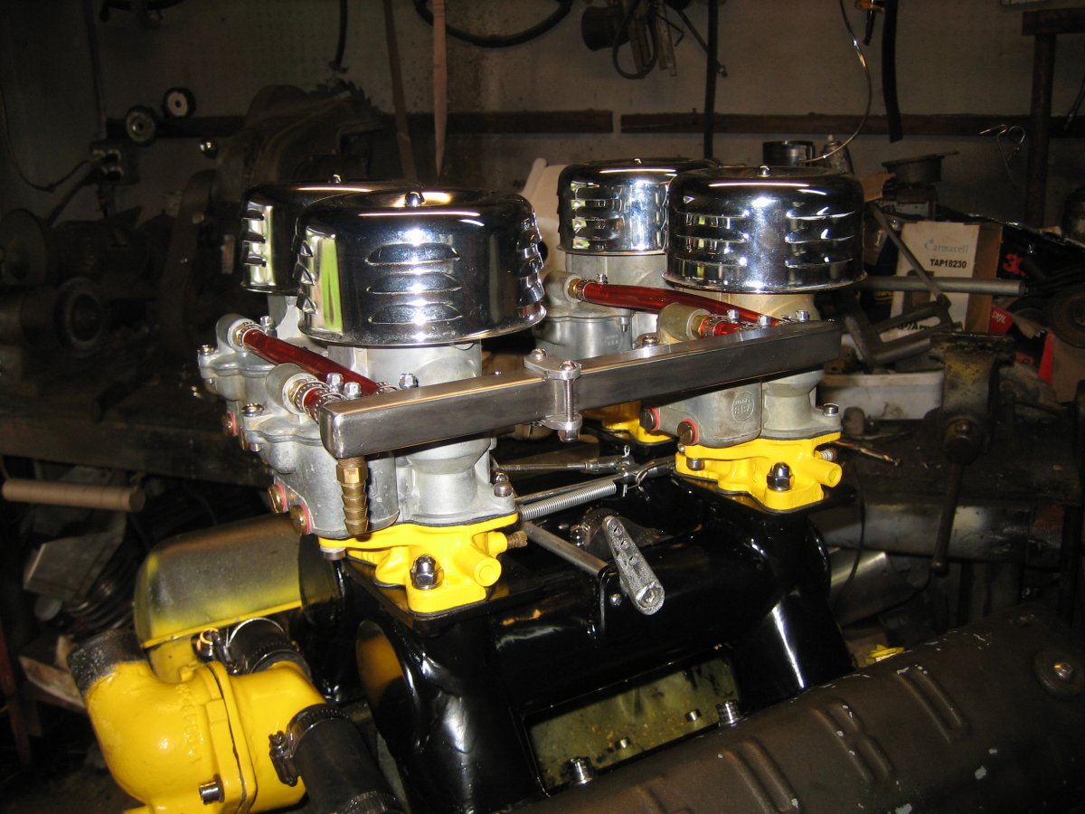

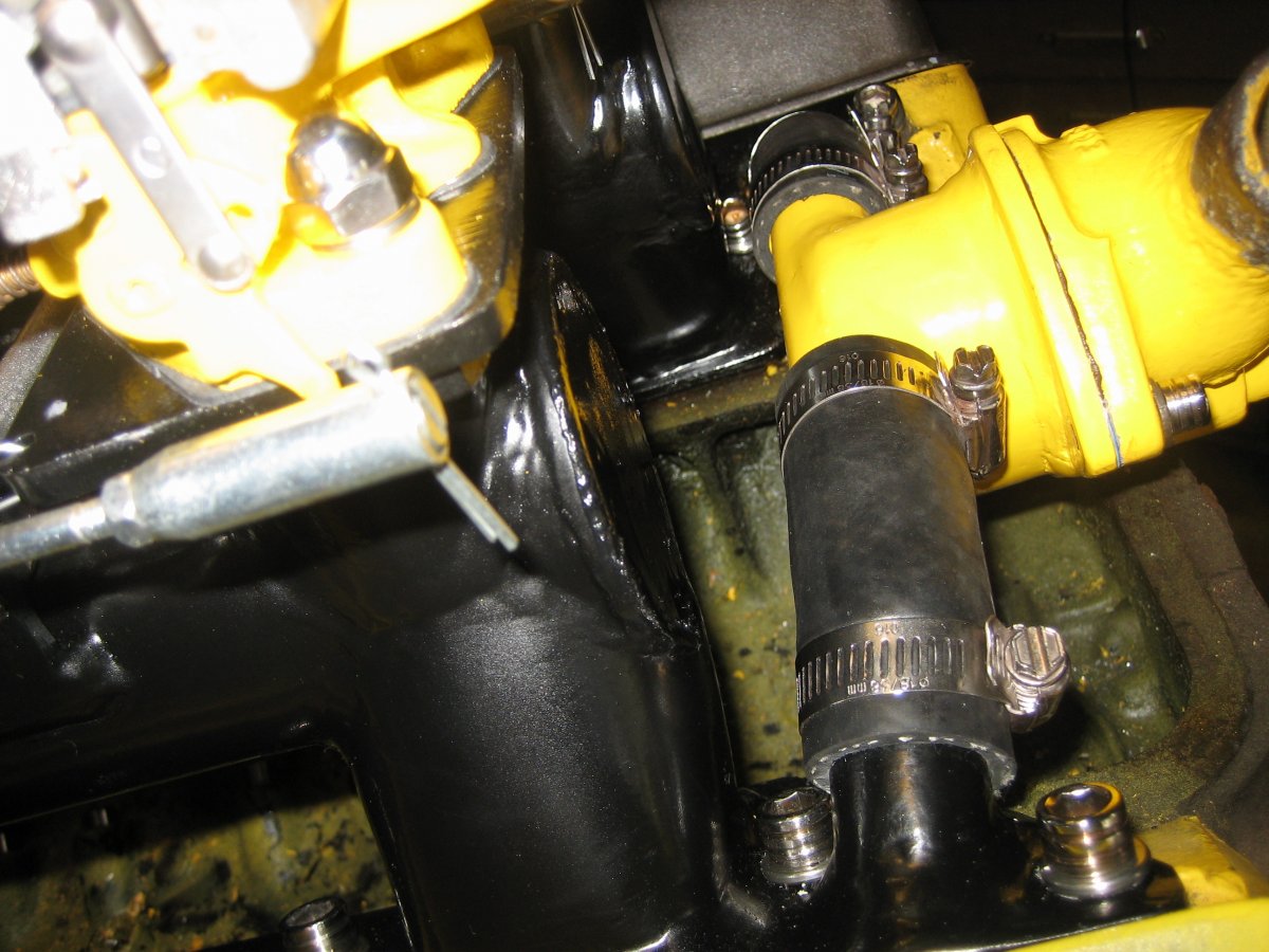

    For homemade 4x2 intake fun. Got things cleaned up an logs blasted, beltsanded ,plus painted.
    So did ***m. on old motor on enginestand,so it will be EZer to hook up when I change it to my hotrod,here's how its looking now as a completed set up with all the right bolts,clamp,springs I hope. This should mean I will not have to be running around to find stuff when getting in on the car,an cut back on my old back bending over so much. Did some extra details,polished all the clamps and screws,got some Stainless allins and cut the nerling off n added two groves for fun on the intake hold to head bolts,polished acorns hold carbs. 013.JPG 011.JPG 015.JPG
