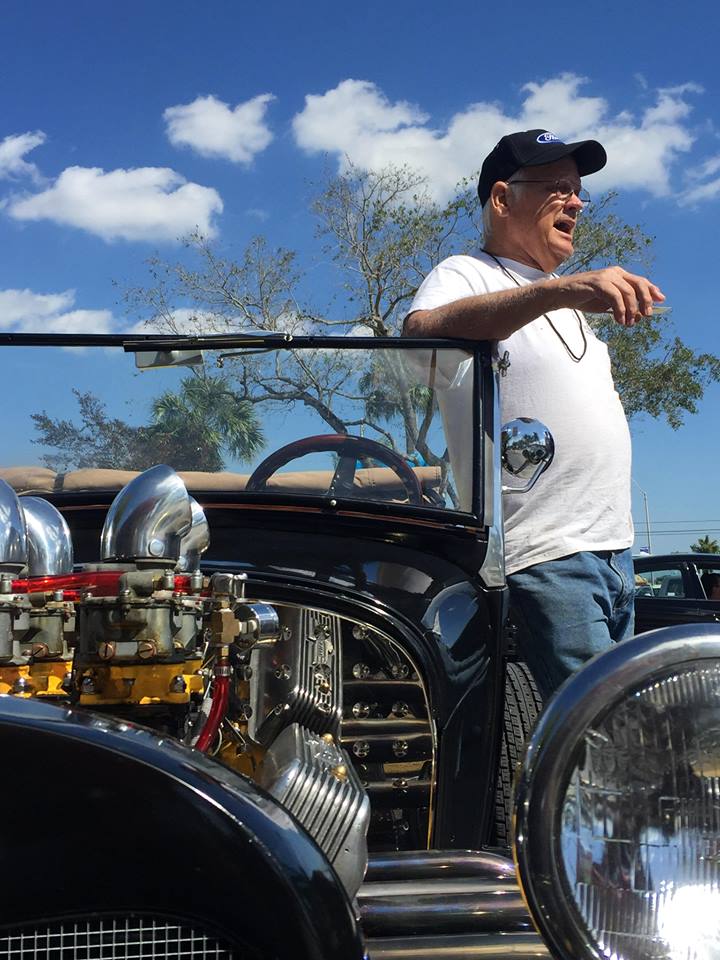

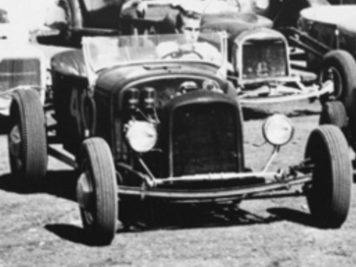

    Well kind of hard to tell in a photo,28 A roadster,its a "bob tail" as when I got it in the late 1950s the rear trunk an Qs were crushed bad,so as a teen,I just cut off what I could not fix at the time,an built what I could.
    Sure could of redone it by now manytimes,but I really liked it in highschool ,early 1960s just the way it was,so yes, I do just keep it as built. This is best bob tailed rear shot I've got,LOL :rolleyes:
