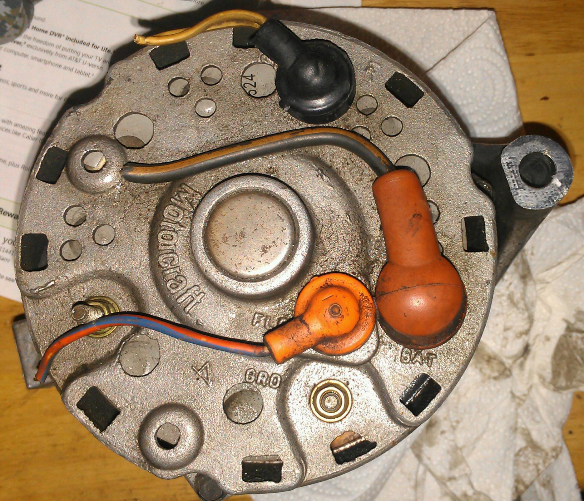

    Alternator are not my thing at all,but don't wish to use my Gen. anymore=lost reg. and brushs bad, Alt is better for needs now,so I just didn't know about these Alt.. I was thinking I'd get Bobby D. to rewire the Ford one I have into a one-wire[I understand one wire,thats simple],any way I take it over to him and he tells me I'd be better off just buying a one wire aftermarket Ford type. Well that would be great if hotrod piggy bank had over $50 in it"NOT"just bluw the bank on a carb kit. So who's got ideas? I don't even know what year or Ford the two I have came off of,but both are just like each other and got them from a few years ago,another bud that is now gone,thanks RIP Ed.
    I was looking at finding a outside reg,but turns out not knowing what my alt. is kills that:confused:seems to be pre 1979 Mustang? So need a simple wiring drawing and extunelregulator for the hotrod. Open to ideas? I'll be posting how I do this thing up in anycase. Looks like the alum casing is fairly EZ to polish up to make it shiny,noy chrome like a new one-wire but hay it's free.

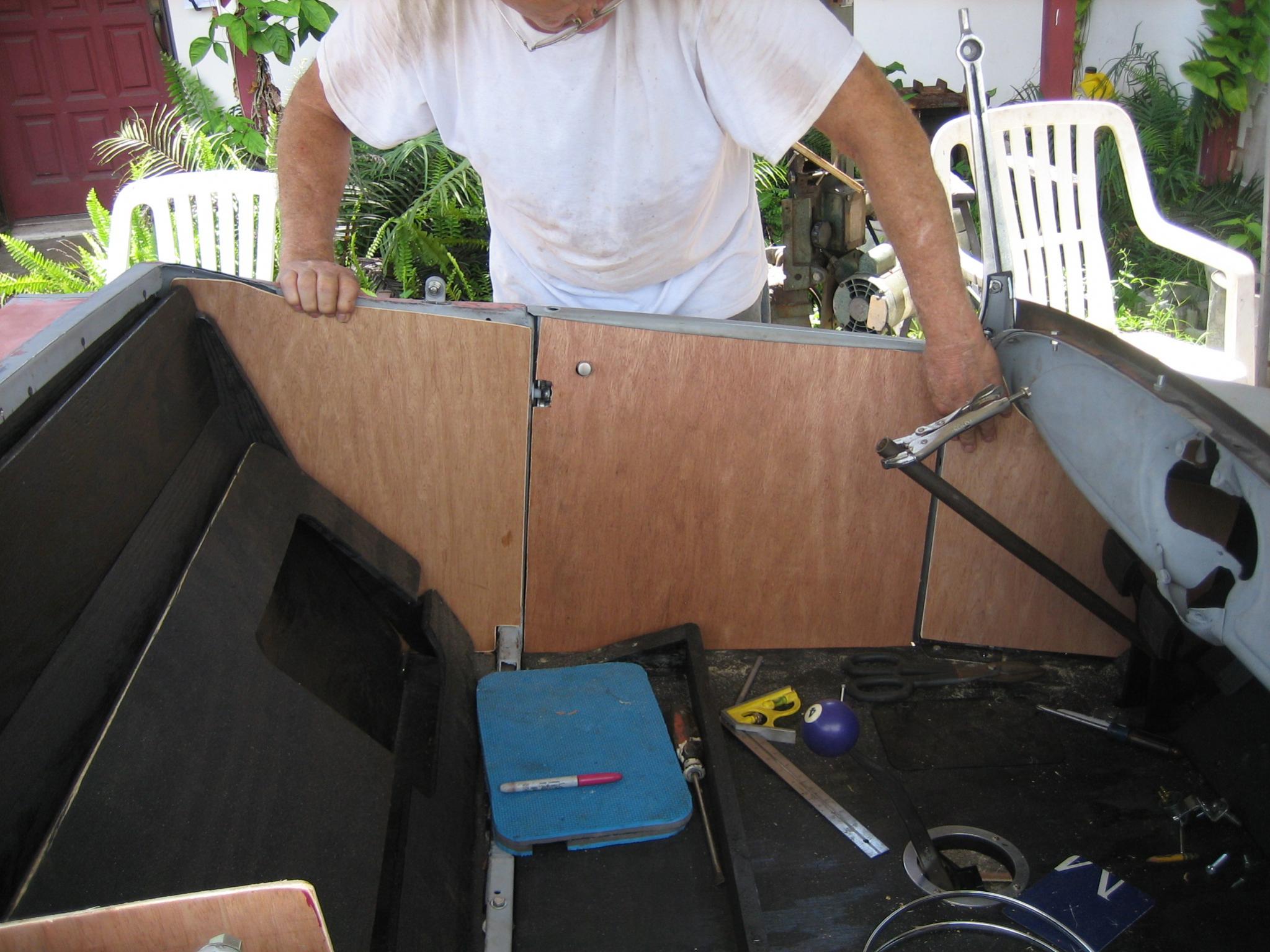

    This week been working on the inside panels for doors, kick and seat sides. Made some cardboard patterns to work out the right sizes before cutting up the door skin wood I had for other house work. They will be held in after upholstery n padding is added by some Stainless steel screws and SS cone washers. Still got to deside the color but later.
