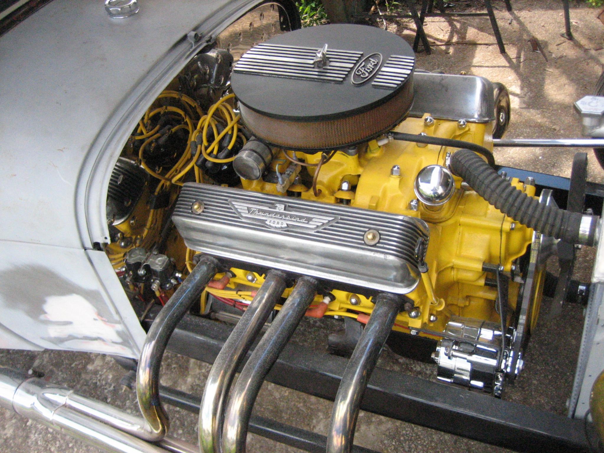

    For my 71st B-day,my son got me a chrome one wire GM alt.:D:cool:,so I took off the 6wire not chrome Ford alt and remot reg.,I did a small mod to the bracket for fitting GM and looks good now,lots less wiring.

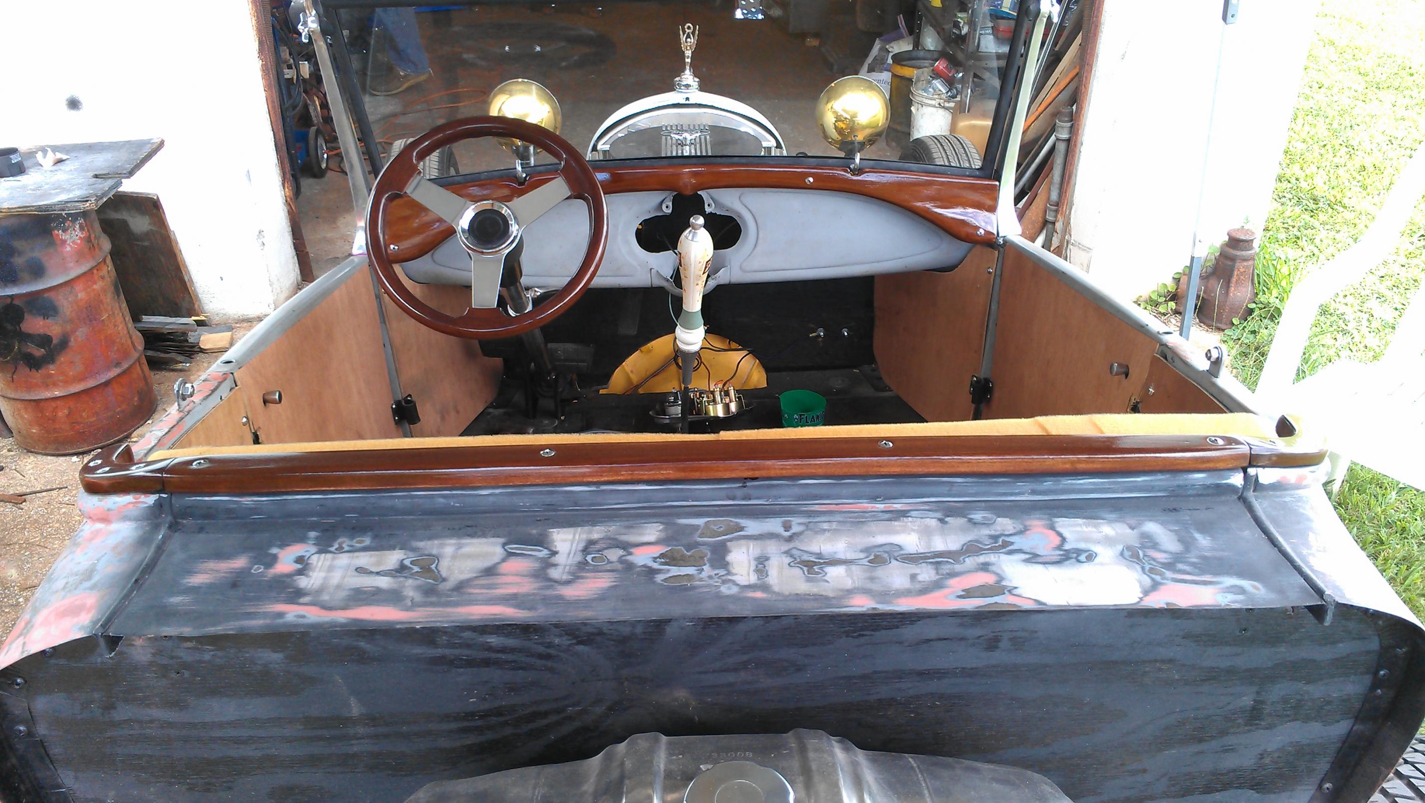

    Started trying to do the wood lip around the rear of cockpit,so it will both hold snaps for top and the upholstery under it. I looked at some Oak to do it with,but cost was 3x what popluer was,,going to stain it anyway to kind of match steeringwheel ,dash and rear rack.;)

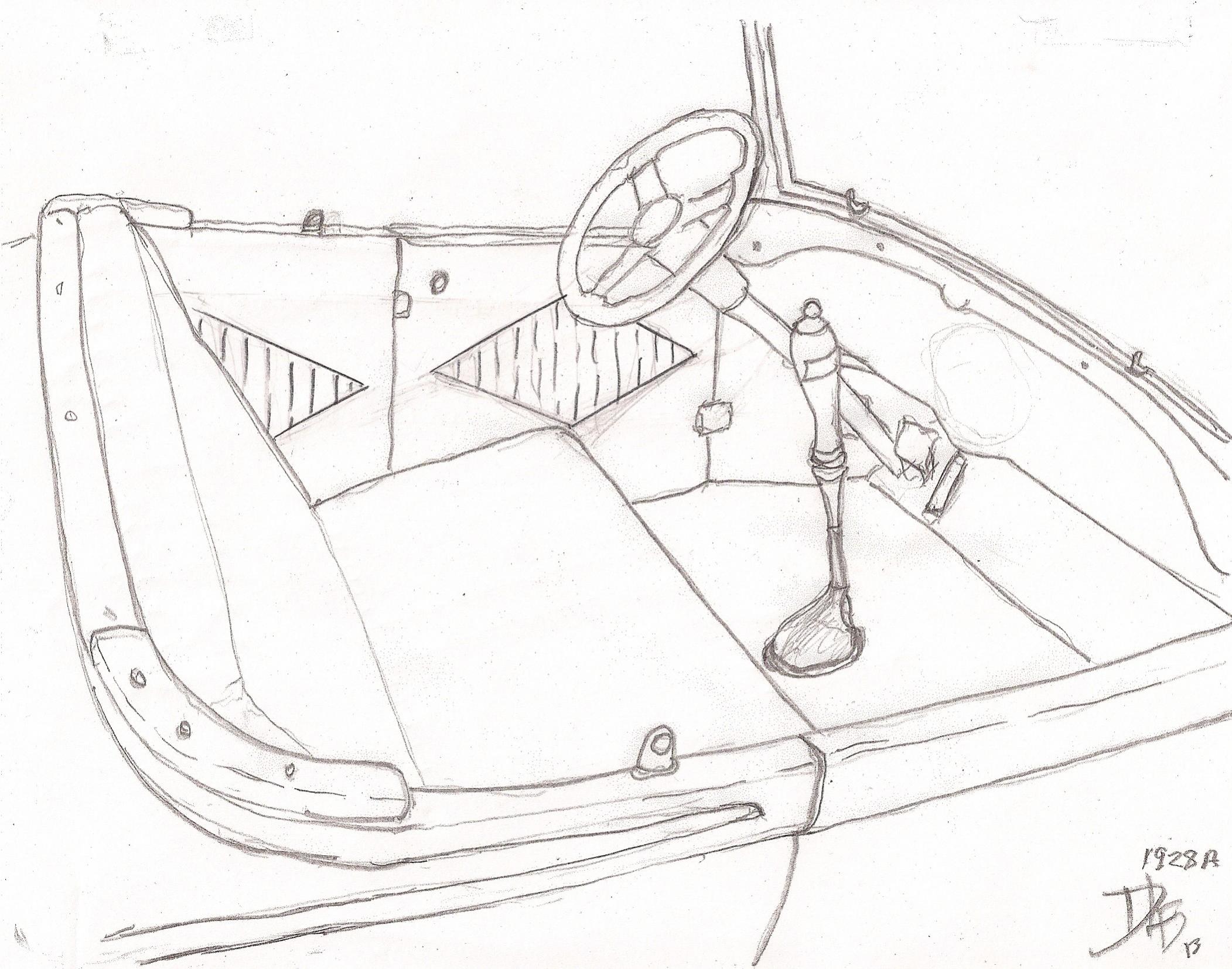

    Thinking about what to do for upholstery?Kind of stuff I do when I'm out of parts for a time!

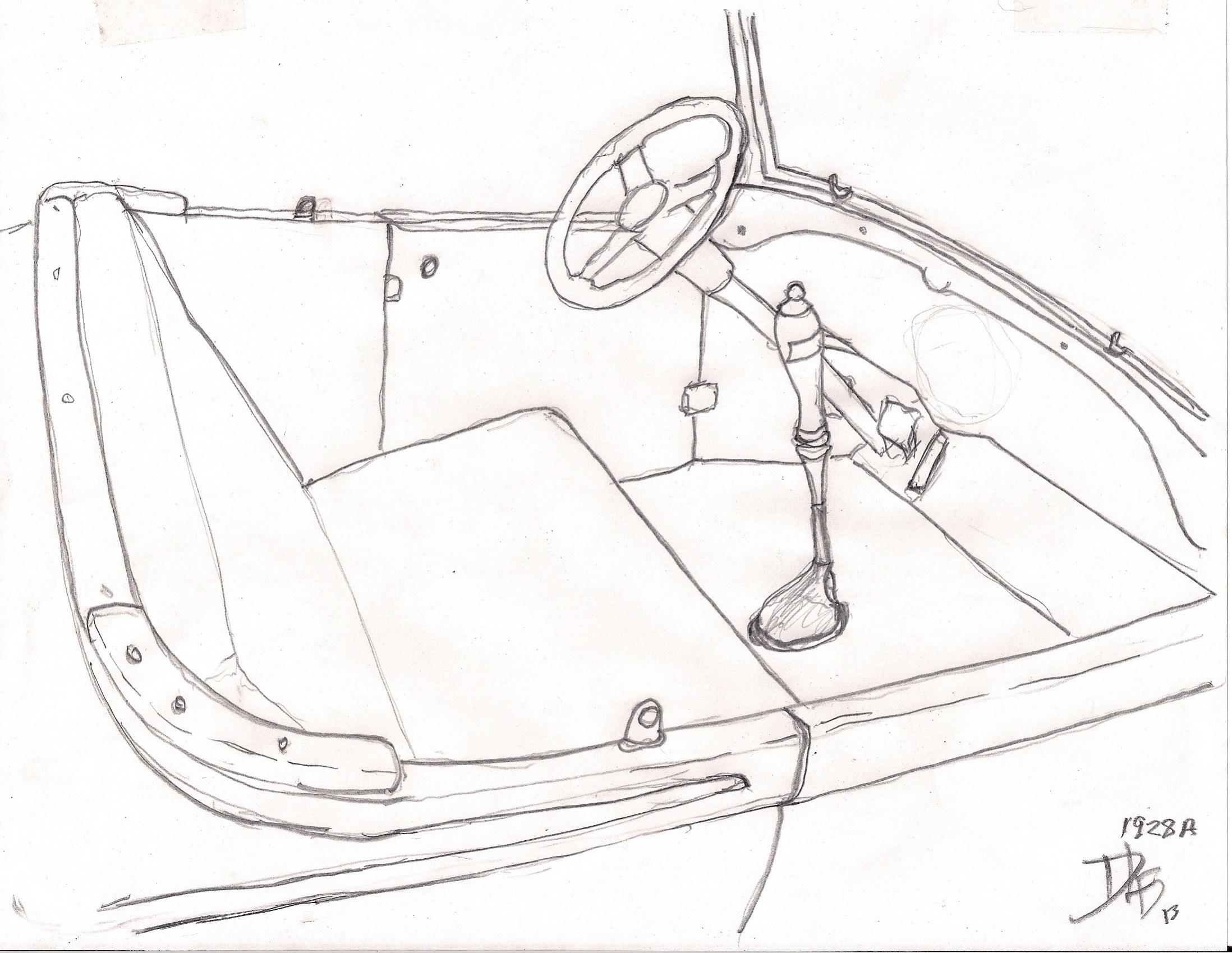

    If you can make your self a drawing.
    Trying to think ahead some on what to do helps on my old rod. This time,I know I will not put it back all black like it was=too hot to set on in Florida sun,but back then the black vinyl was a free-B from Nuwt.:D
    Anyway I'm painting rod the same way :cool:,all hi gloss black,with the yellow motor.
    Thinking black and yellow upholstery to match. But this time, were we're sitting mostly yellow with black outer framing.

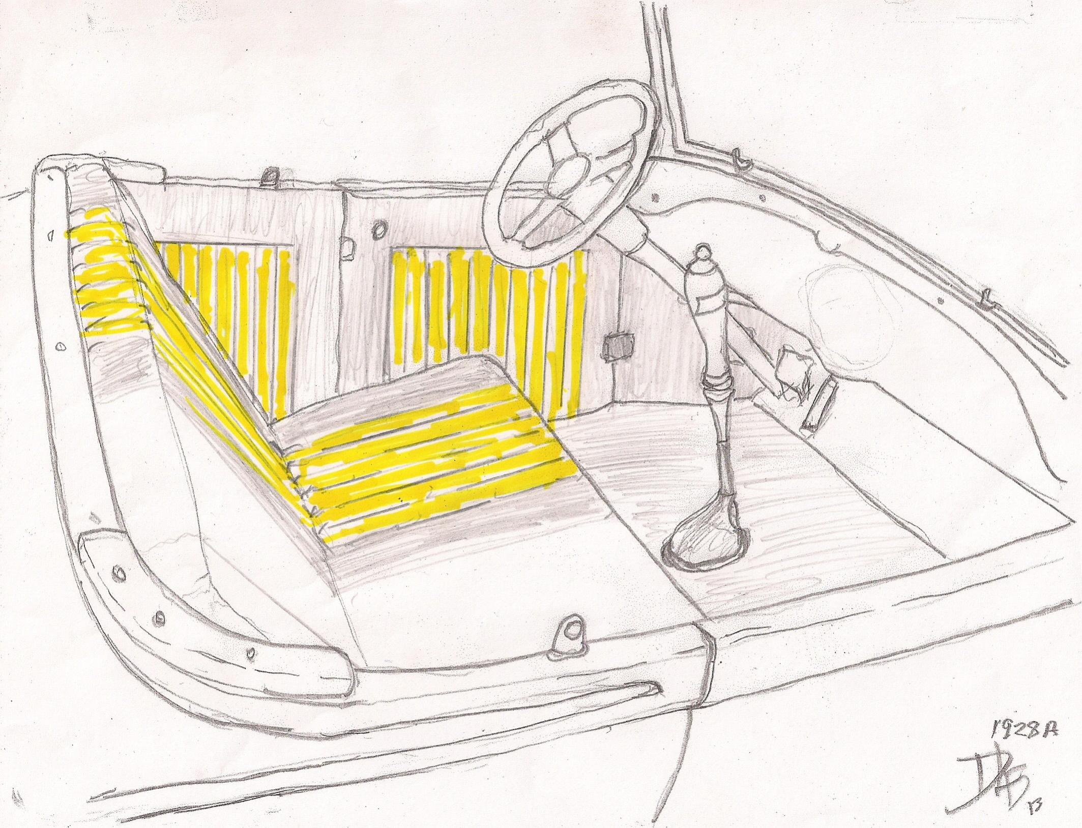

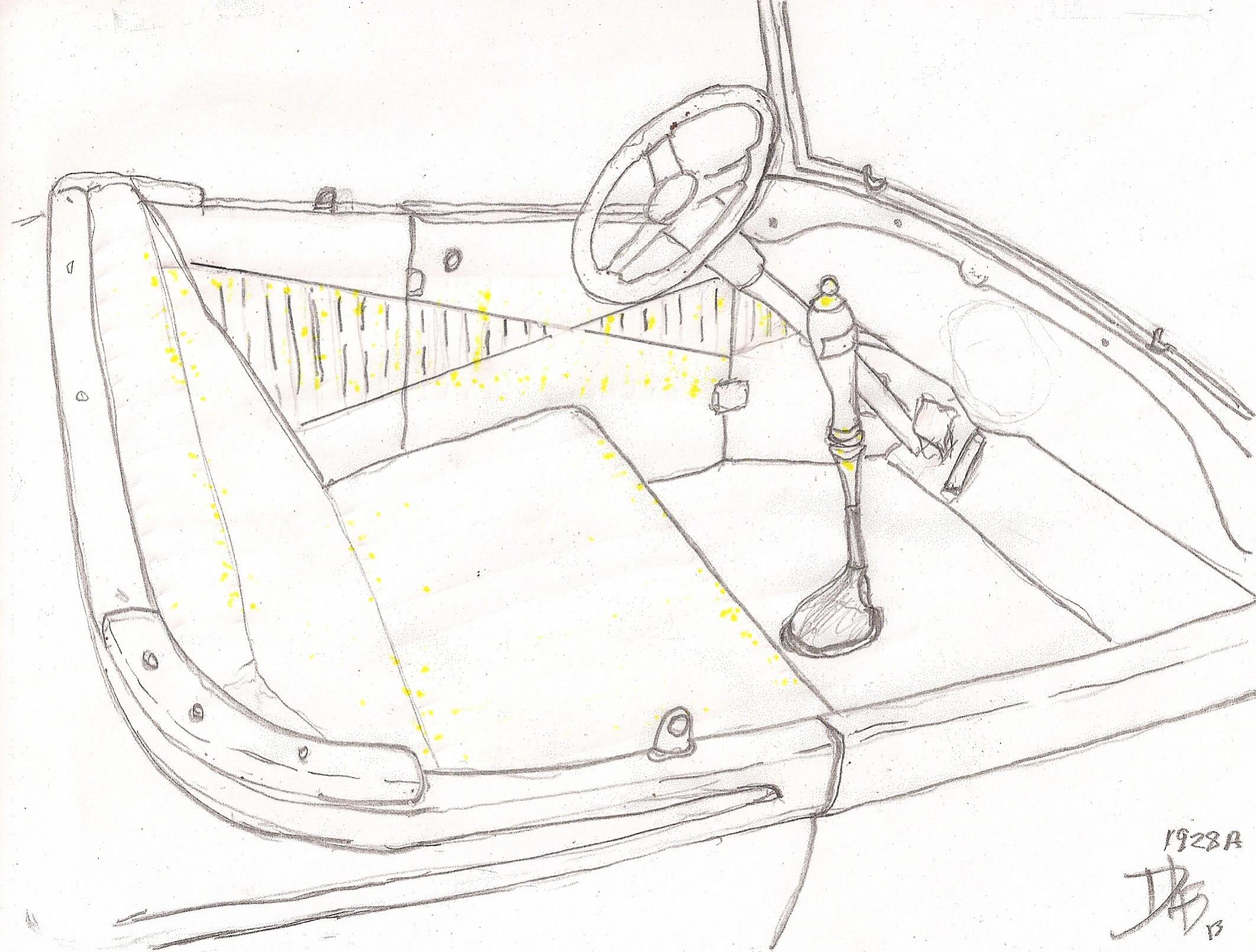

    Here's how I'm working out my ideas. I first make my self a drawing with just out lines shown in fairly plan photo,no detail and copy that a few times so I can then add detail a few other ways.
    I only did 1/2 the detail here cuz I got lazy after trying to do too much on the first drawing in next post.,but same design both sides with black sbout 5 or 6in. panel down center
    I'm liking #2 drawing cuz door an side panel match seat best,both have two yellow roll-n-plates panels. Rug all black.

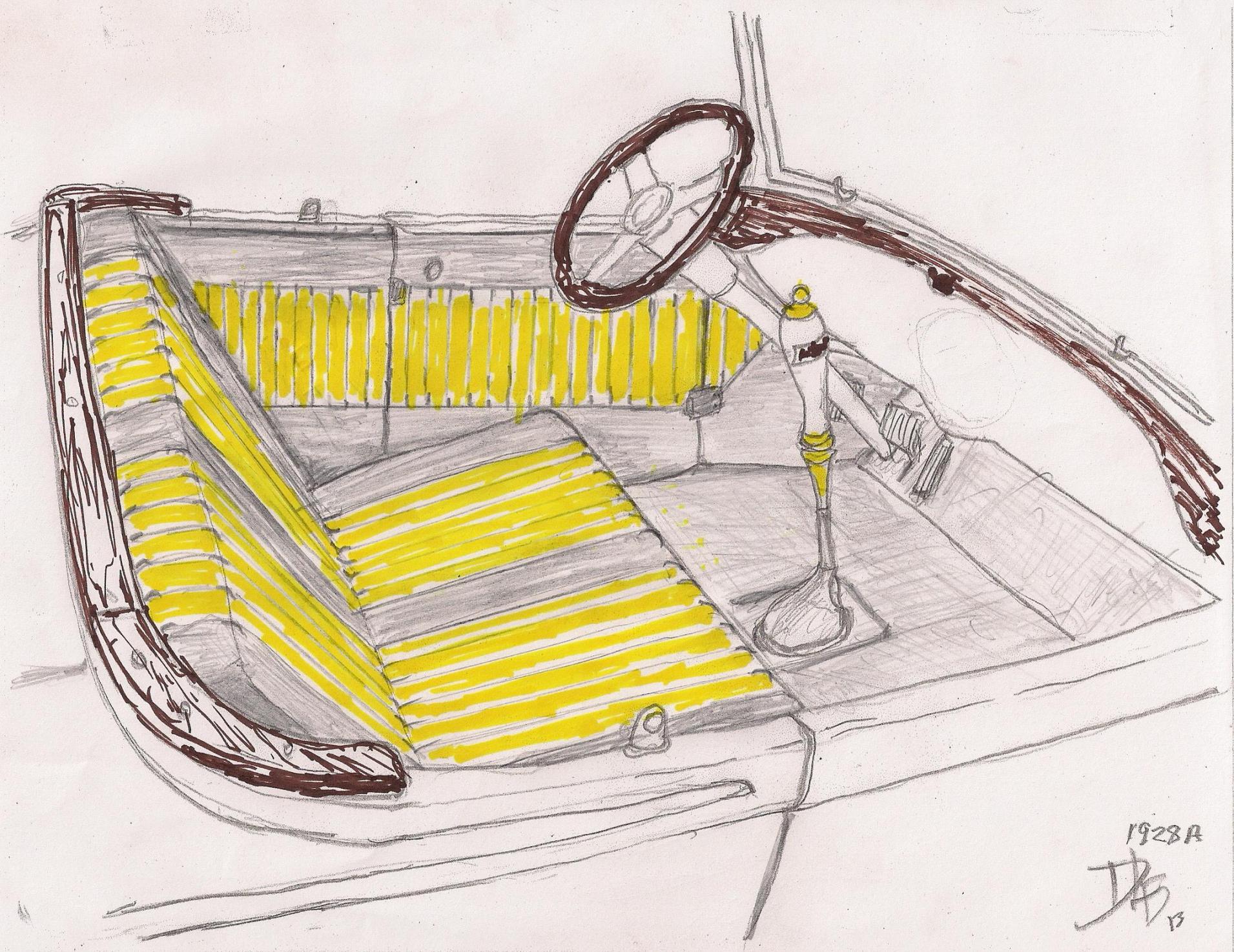

    Here is the first drawing with detail idea and two others I didn't like of door panel types ,was not right some how on door panels for me,so did the one above in that post. The seat did look good to me,so kept that design.
    Sure saves time playing by drawing vs doing.

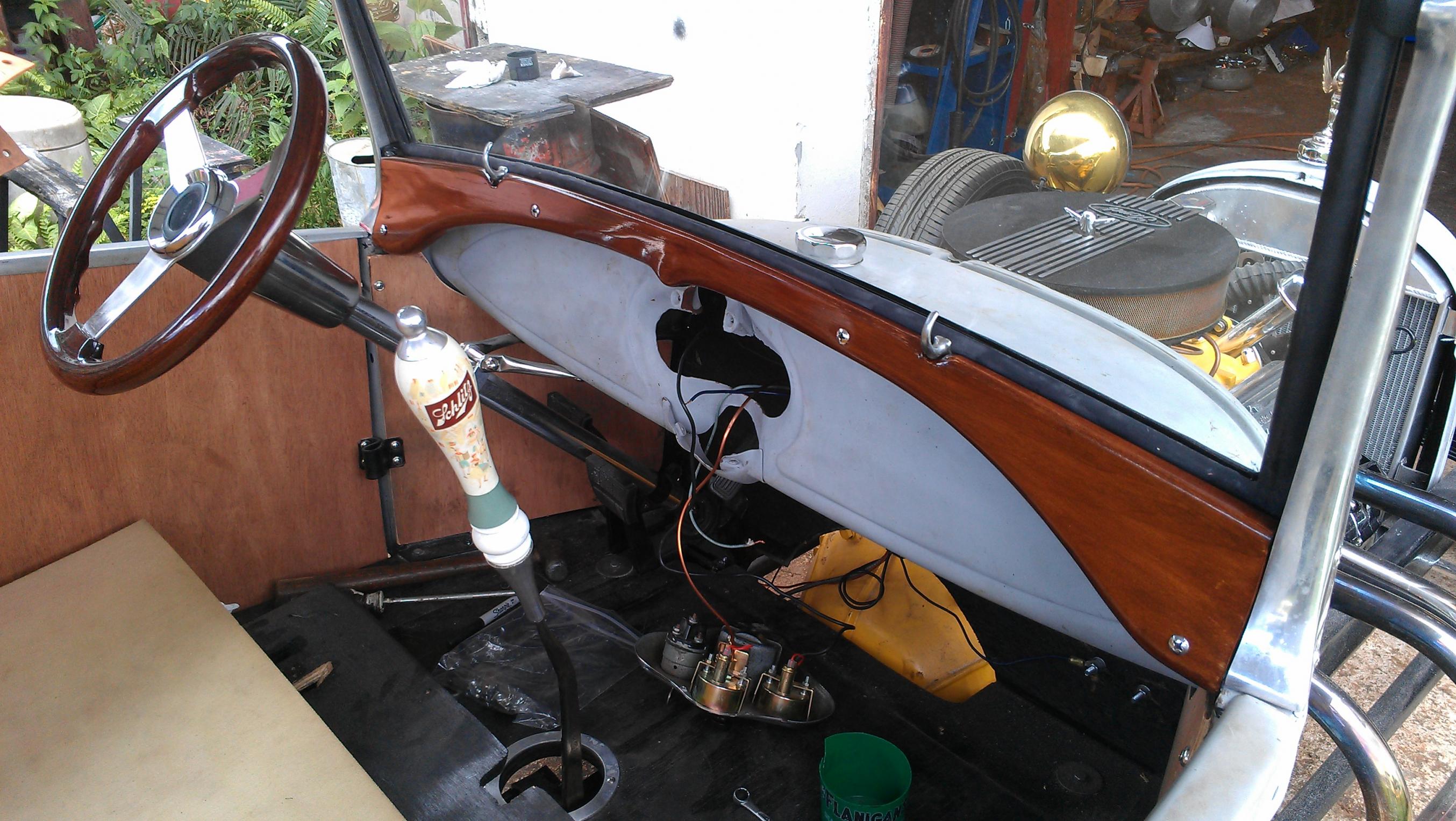

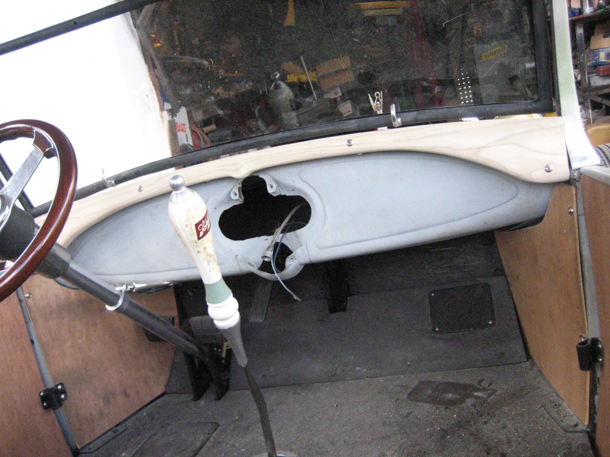

    Did some work on dash top rail,it's wood insted of metal to both make it custom and hopefully a better fit plus I'm to cheep to get one,I no longer have the old metal one ,seems now days the're all made of gold anyway:p if trying to buy one.:eek:
    I still have a lip I need to add along the top to make windshield fit close. It should look nice after I stain and varinsh it to kind of match steering wheel and rear cockpit lip.:D:cool: Been thinking about woodburning some dragon art on this,but haven't done art I like yet. Maybe not?;)

    Dana, man like wow! Is there no limit to your talent! great sketches, timber and metal worker:D your talent leaves me in awe:)

    Dana, The interior drawings look great !!! I vote for the first drawing in Post # 124. It will probably be the easiest to do and the theme carries itself well from seat to side panels.
    Do you ever stop and do Tee-Shirts anymore ??? Jeff

    Yup,I too like the first drawing best. At some point later on I'll also build a folding top for her this time,never got passed just building the top bows back in the day,when it was a new rod.

    Final fit an sanding on dash topper and rear cockpit rail done,added walnut stain a few min.s ago and let that dry tell tomorrow, then the shiny varnish,coming out good so far.
    Removed the plastic temp oil line 4 starting up with out a dash,now got the copper oil gauge line installed,plus added temp gauge in to dash. A bolt or more a day.;)

    OK got the stain and varnish on the wood parts,good enough for me. Will have to remove for shiny high gloss black body paint coming soon.:D:cool:
    The walnut stain came fairly close to matching the steering wheel that J.J. gave me. I also redid the wood slats on folding rack,so when I do have that on,it will all tie together well.

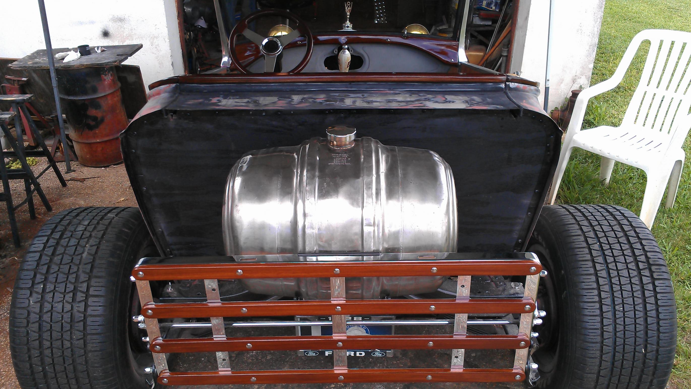

  18. gnichols
    Joined: Mar 6, 2008
    Posts: 11,402
    gnichols
    from Tampa, FL
    ^ Dana... you sure are enjoying your face time there! Was it a Hamm's beer keg then? Gary

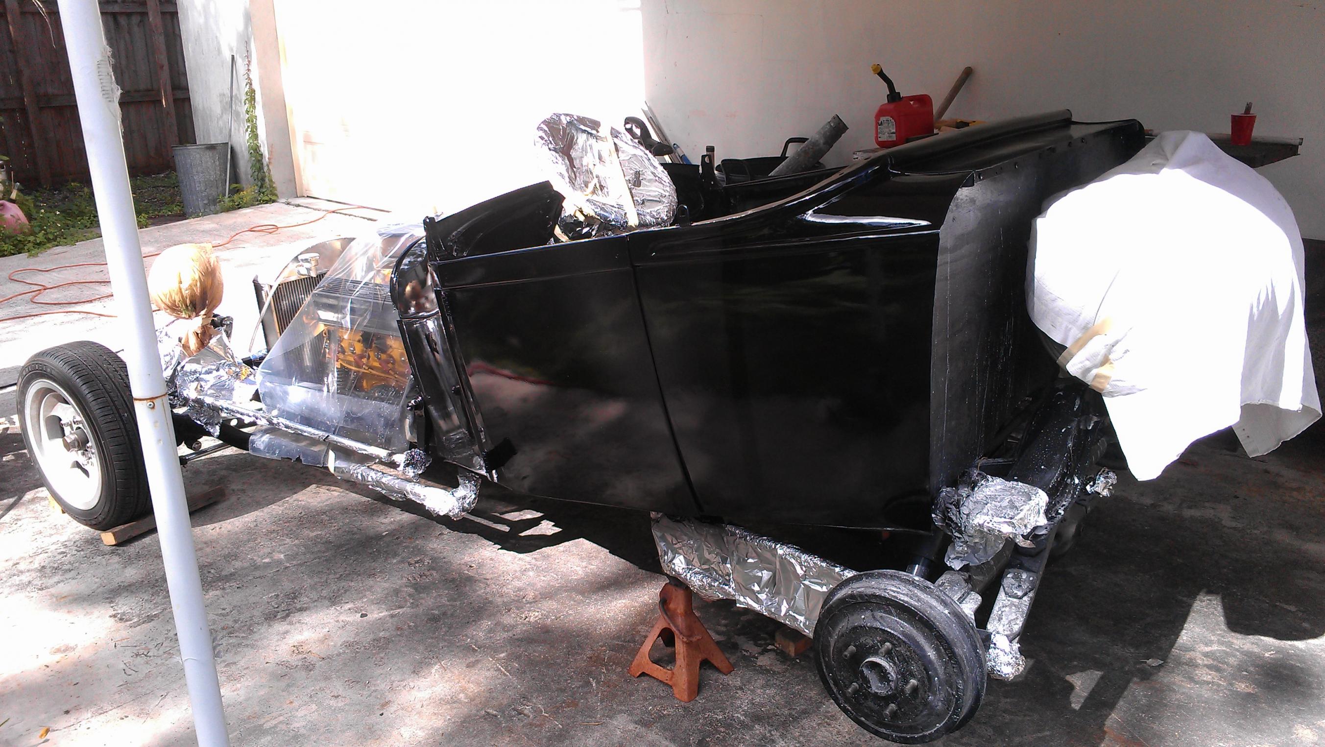

    Finely got the high gloss black back on my old gal :cool:,after a few weeks of sanding and filling,needs some buffing out yet,but pretty good anyway being painted in my back yard,even got a buddy hotrodder John Fenner to come over and help do some spraying,man its nice to have help:D
