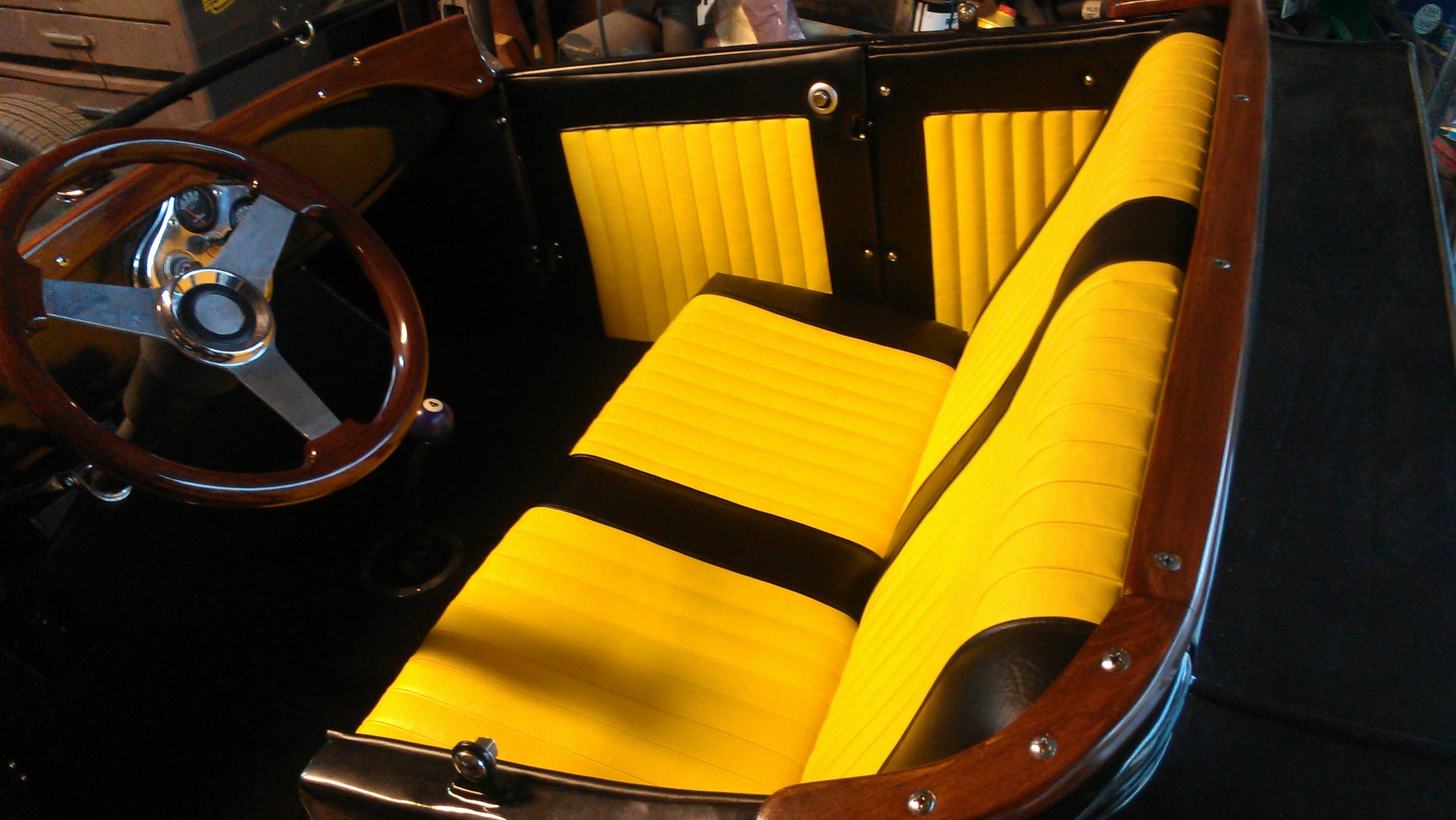

    At this time I'm doing my own 1928A insides now that the shiny paint is on,it will be black and yellow roll n pleats. Same wrong old cheepy $20 yardsale housewife sewing machine, cuz I'm still too low on $ to buy a real walking foot one=about $300 on ebay if I had that.:(
    I did my design posted earlyer, found some prepleated in yellow kind of like the white stuff I used for my son's 23T,but this seemed to be the only yellow any one makes} not made as well as the white I had,this yellow roll n pleat has a super thing backing sheet ,so thin it bunch up or even tares up trying to sew it.=must fix this. I came up with a way to get around this junky backing by putting 2in. wide masking tape on the thin stuff along the edeges I sew,works good and just leve it there,it don't hert anything and out of site anyway.

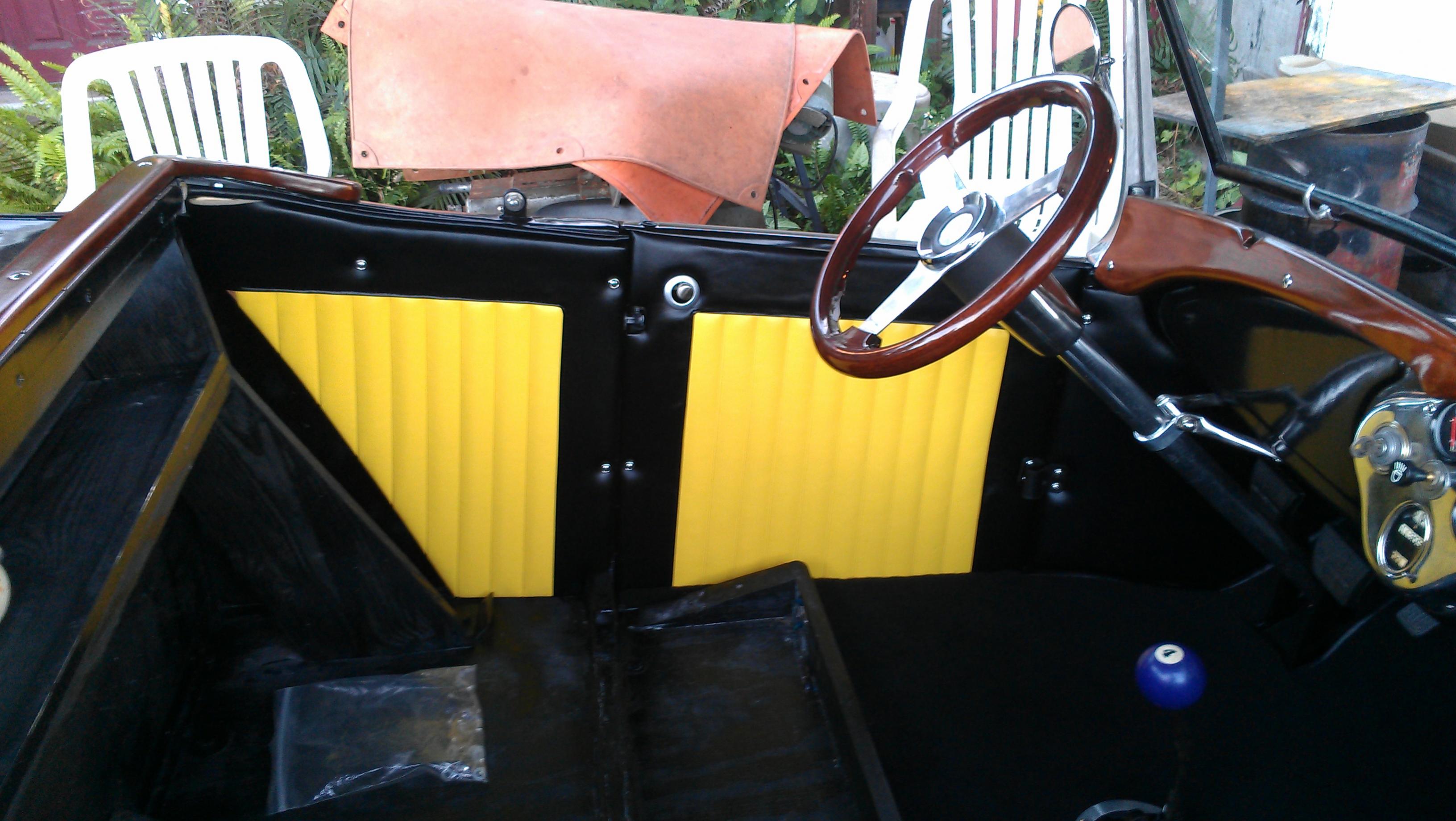

    Here is a first look at the panels and rug I just did..

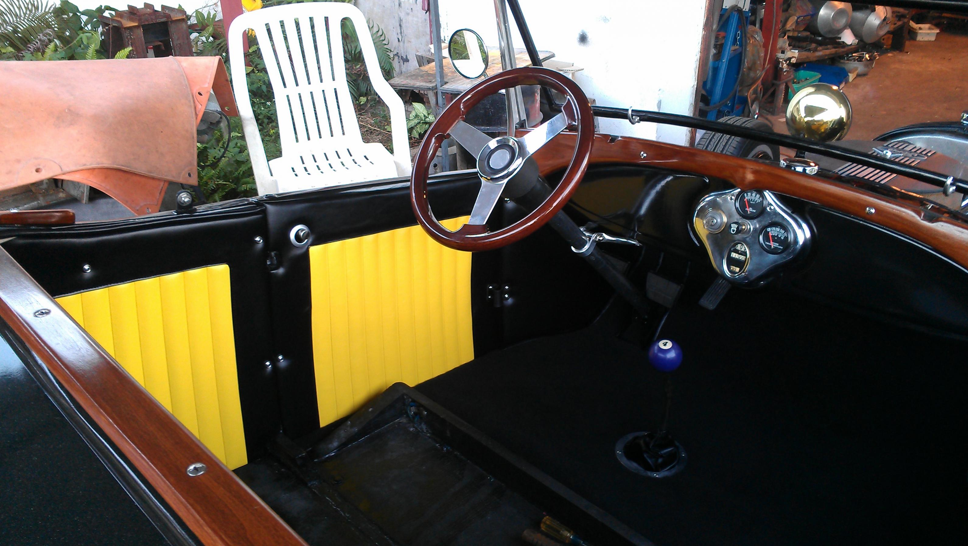

    A little extra trick I'll pass along is around my inside door nob,is just a 1in. ID Curtain Grommet,only seems to come it a 8ct. pack=have 6 left.:p Looks cleaner to me then just having a hole in the vinyl.
    The door latch is a Bearclaw with a drour nob added.;)

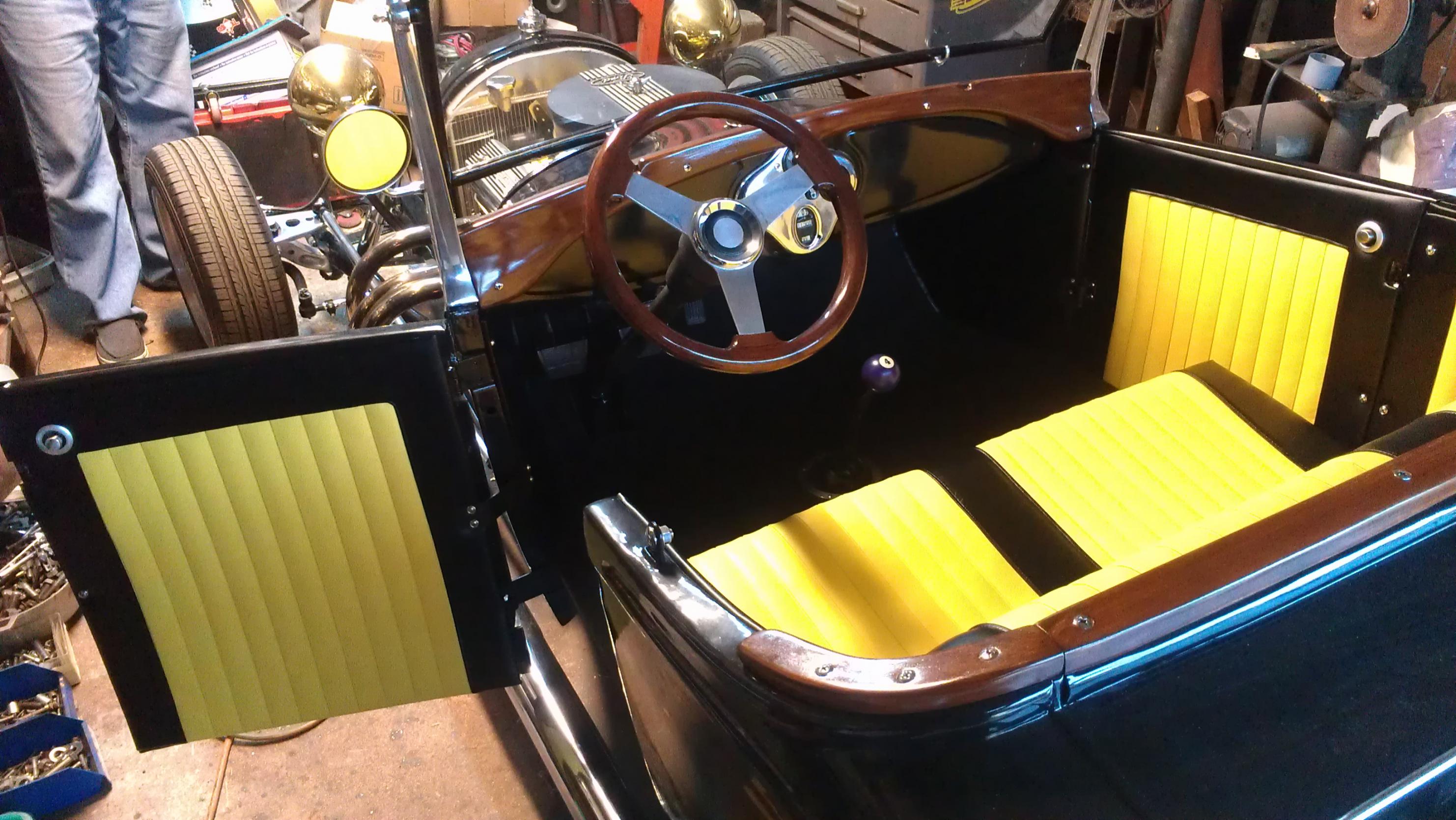

    The little trim for around the inside door nob is one of these things,I only used 1/2 and made it press in to the door panel with a small bit of glue.;):cool:

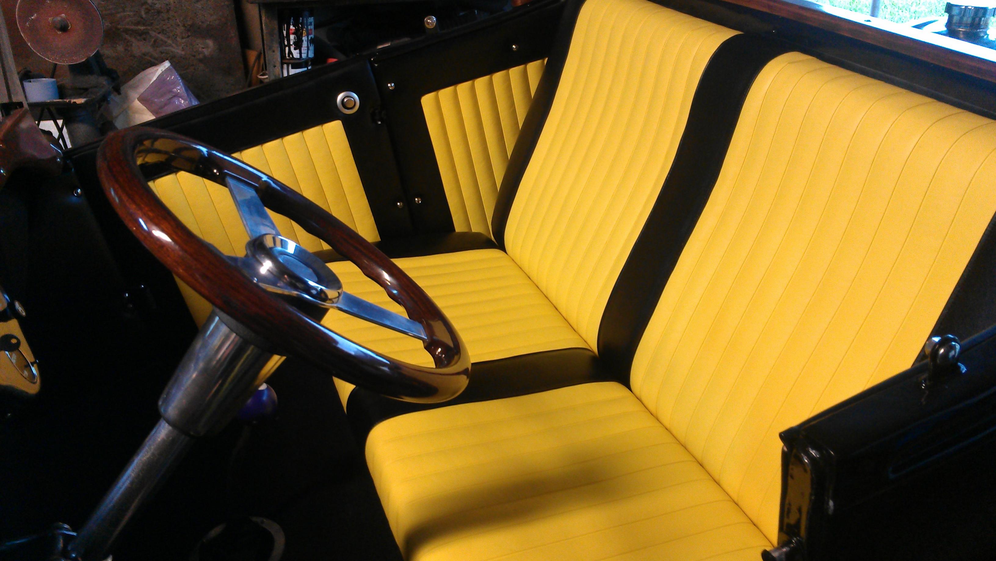

    With the masking tape work around for the poor thin backing of prepleated yellow,I felt good about it. So did the seats as well,they feel great sitting in too:D:cool:

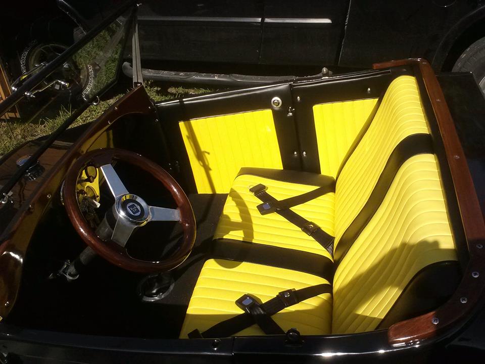

    Having some fun driving around,to work out any little stuff,definity need the taller 2in. or so tires all 4,but feels pretty good over all.:cool:
    next project is trying to build a folding top from scatch,I'll be doing a tech on this fun!:D

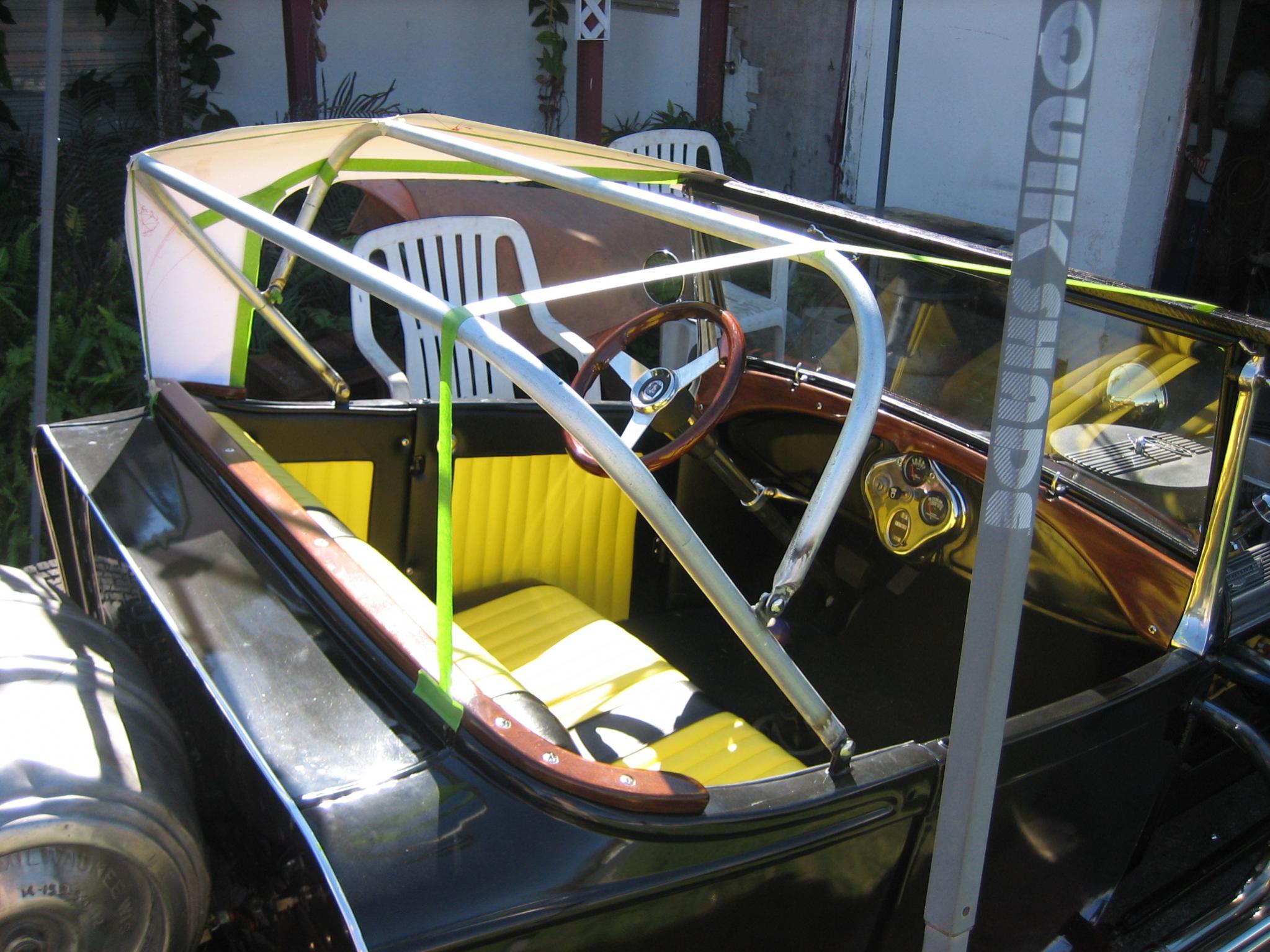

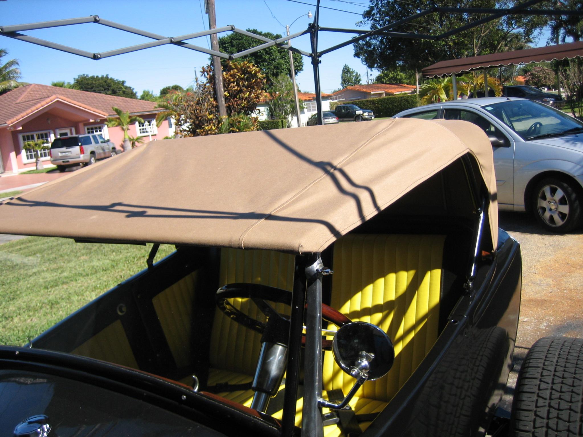

    My plan is not to run the top on the rod very much,but to have something to put on if weather looks kind of iffy about rain,but can then fold it down inplace if needed.. Franky I don't like a folded down tops much ether my self,so all of it can come off EZ or just fold down temp in this design.
    Here is some of the work I'm playing with now,doing a folding top,I'll be trying to do a tech of it all.;http://www.jalopyjournal.com/forum/showthread.php?p=9479688#post9479688

    Working out how to make a pattern for my fabic,looking like 3 panels to the sides with center running as one part from headerbow to rear wood cockpit lip,going to put a oval rear window in the back 8in.x22in. and think 9 snaps may work along that wood lip:cool:
  22. pitman
    Joined: May 14, 2006
    Posts: 5,148
    pitman
    Dana,
    The fellow who made the top for my A, put three snap ID bases, on the upper bow 'area' inside, so the rear window panel would hinge up and snap to them. They may locate easily on mid-bow to rear-bow straps, just beneath the top. This gave sun protection and added ventilation, like a 'bimini' top. The side view opening-curvature you select, will make a big difference, in how the top looks!
    dana barlow likes this.
