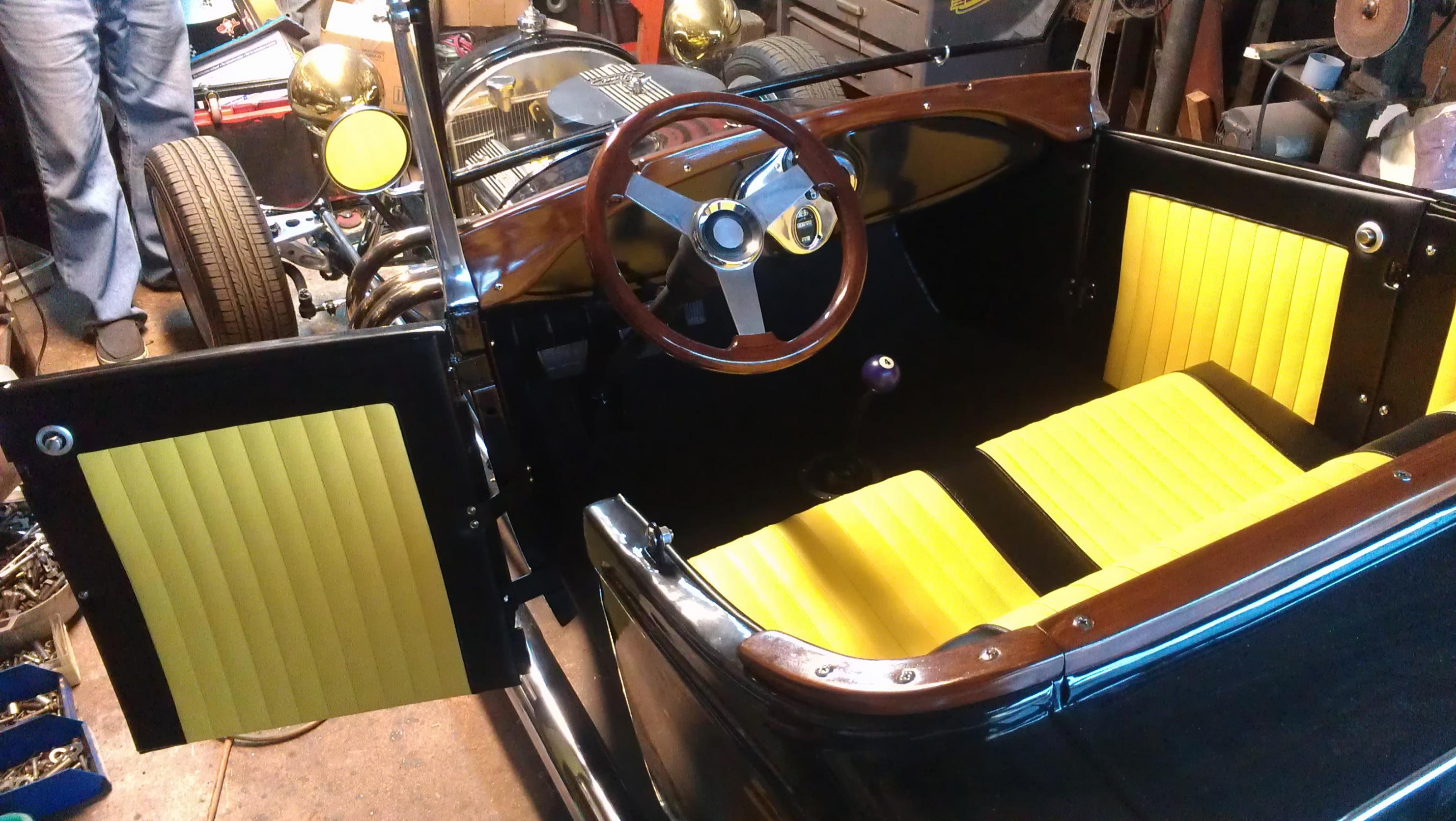

    1604679_723260631017868_463377671_n.jpg One of my old neighborhood buddys Rob Bean from the 1950/60s stop by,he was in town from up north an had to see for himself. So we got to run around the block an lay some rubber, just like we did together in the old days in the same hotrod :D:cool:
    As ya see Rob is a smiling big time! Me too! A jump back in time of 55 years bang!!!

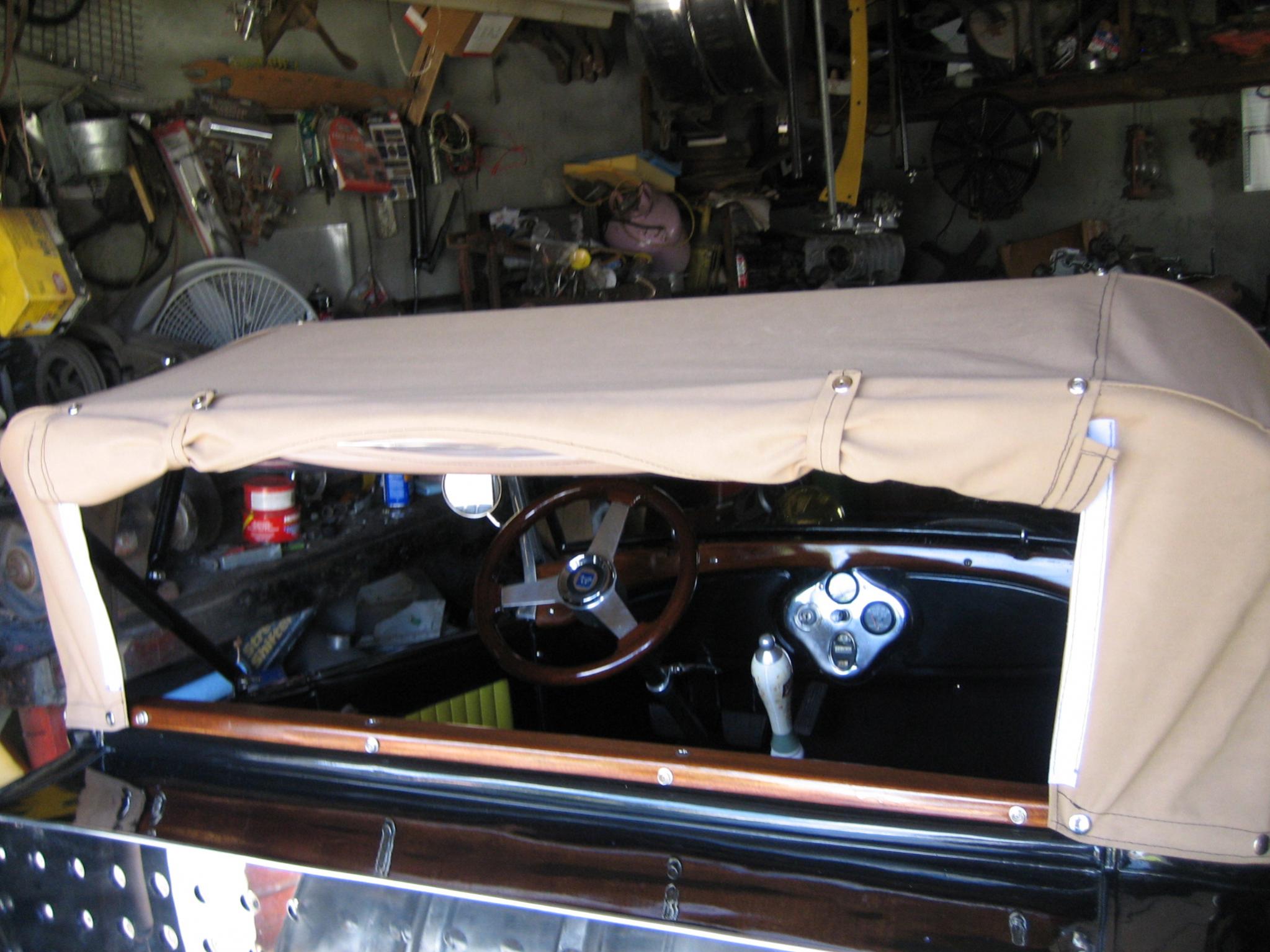

    After playing with the top on a little,I desided to make the rear window roll up and snap inplace with two little straps. I held the straps inplace on the inside with the same screw that hold the snap on the out side for them to snap too.
    By doing the open window this way its not hanging above your head. I just didn't like the idea after thinking about having it over my head were wind may make it fludder on my head if there,so rolled on back bow seems to be a good trick.:cool:

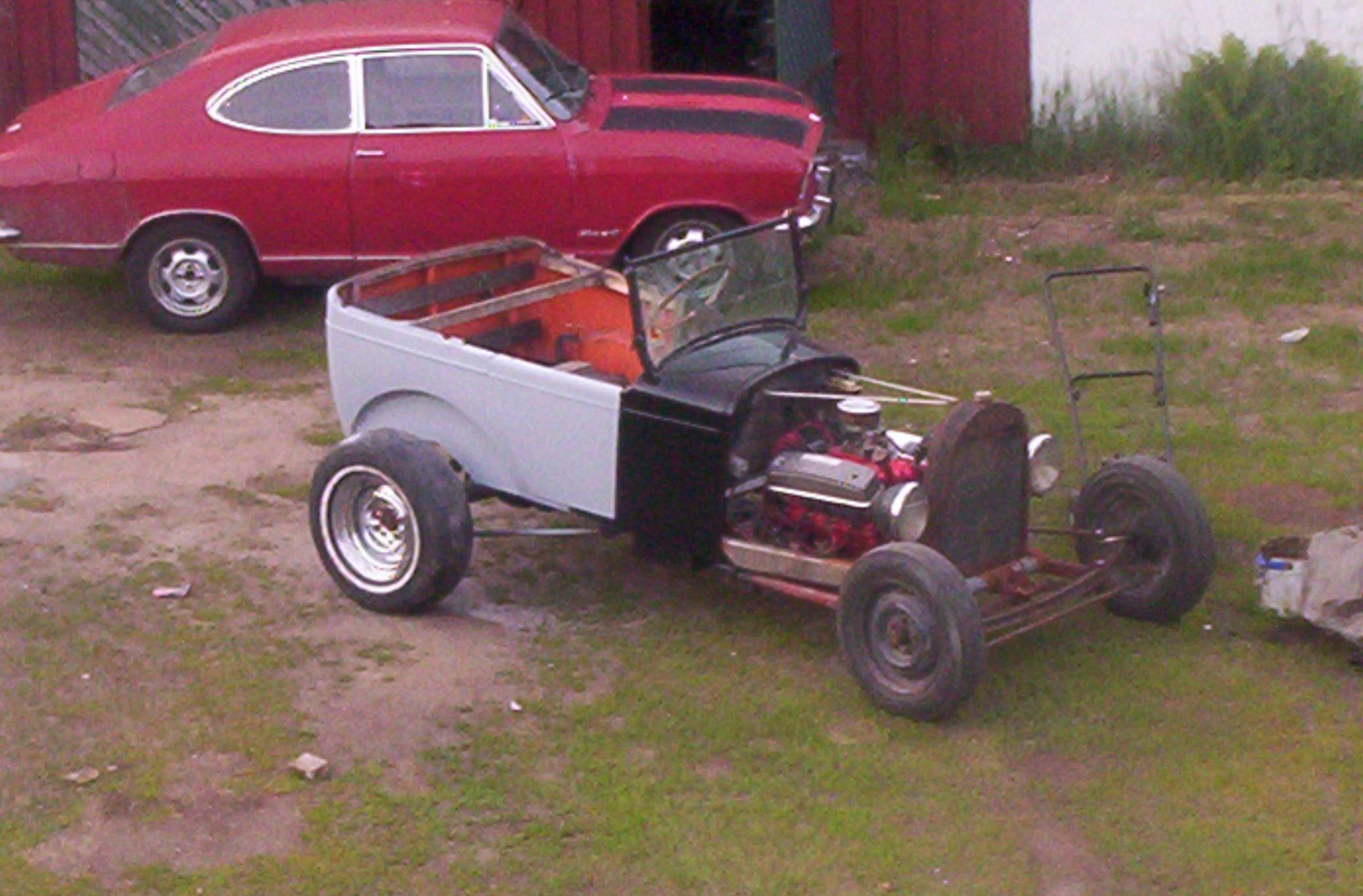

    In the #2 photo;The snaps for straps to hold window rolled up,use a nylon washer under them so they also hold top to bow with out ripping the top,same way I also did other screws with there Finishing Washers[#8 size] with the same nylon washers under those too.:cool:

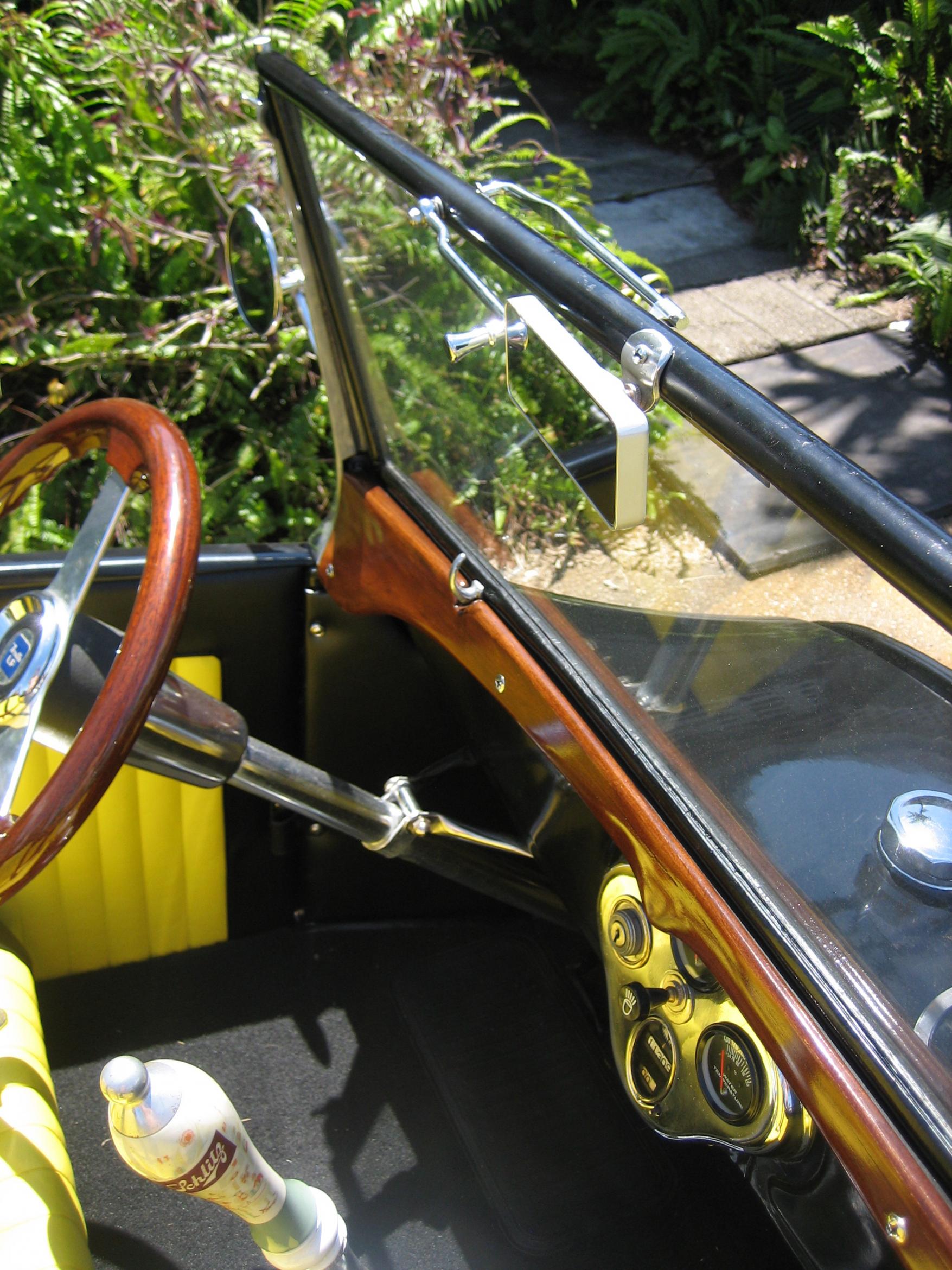

    After driving around for a little,desided a centered rear view would be good to have this time. The side one is handy but dose have a blind spot to the right I wanted to fill in. Found one I liked the size of,if there too big on a roadster they look wrong to me. Made my self a small stainless steel bracket to hold it,that just screws to center top of windsheild frame,had to be sure it could adjust with windsheild closed and a little open like I run it most of the time,so bracket needed to be just right ;):D
