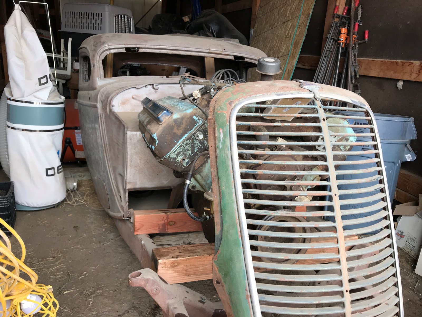

    Howdy, I would greatly appreciate getting some guidance on selecting suspension parts/pieces for my 34 coupe project. I really have no idea how to determine if an old I-beam axle can be salvaged or if its better to purchase something new. Here's what I'd like to do:
    Front: split bones, heavy dropped I beam, leaf spring with shocks - not friction shocks
    Rear: I'd love a quick change but will probably need to go with a 9" and a triangulated 4 bar
    Steering: I'm lucky and found a 392 hemi so I'm leaning towards cowl steering because I'd ***ume a frame mounted box + headers on the hemi won't leave too much room...??..
    Brakes: hidden disc like the Kinmont or something and drum on the back. Kind of thinking this would be the splurge $$$ and get them fancy brakes!!! This purchase will happen sometime down the road and I would like to start with spindles and drums up front until I save the money....
    I really admire the look and what would seem like drivability of the cars Rolling Bones puts out but didn't want to fan-boy call them and pester them!!
    Here's my parts:

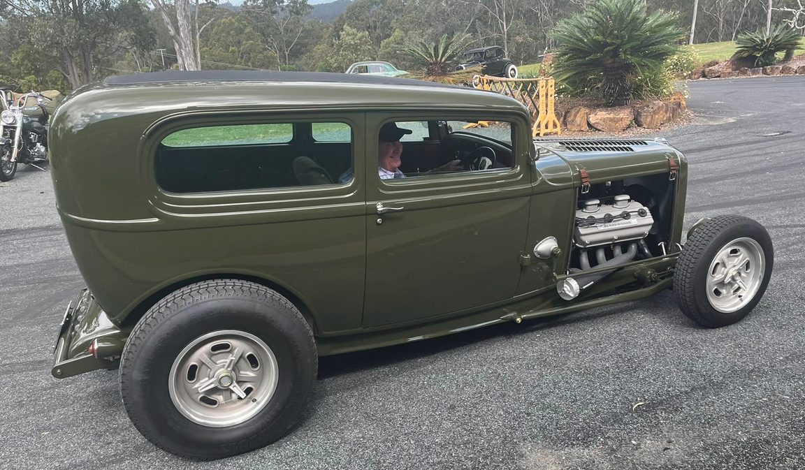

    Just for a little perspective, This is my pal Ben's 32, also know as the Pale Rider. Yes it is chopped hard, but i can see just fine out of it at 6 Ft 2 inches. That's me sitting on the tire in the first pic. Its a hot rod not a Honda civic, you are gonna have blind spots in an old car, Bens heavily hammered 32 is no worse than my 39 sedan for blind spots and visibility. Set up is the key, he used a vega box and i believe he built the column, and a modified but stock style bench seat, to get the view out the doors and windshield right.

    Your engine is setting too high off the frame in your mock up picture. Here's a shot of mine 325 dodge and 30 pick up. hemi along frame.jpg
