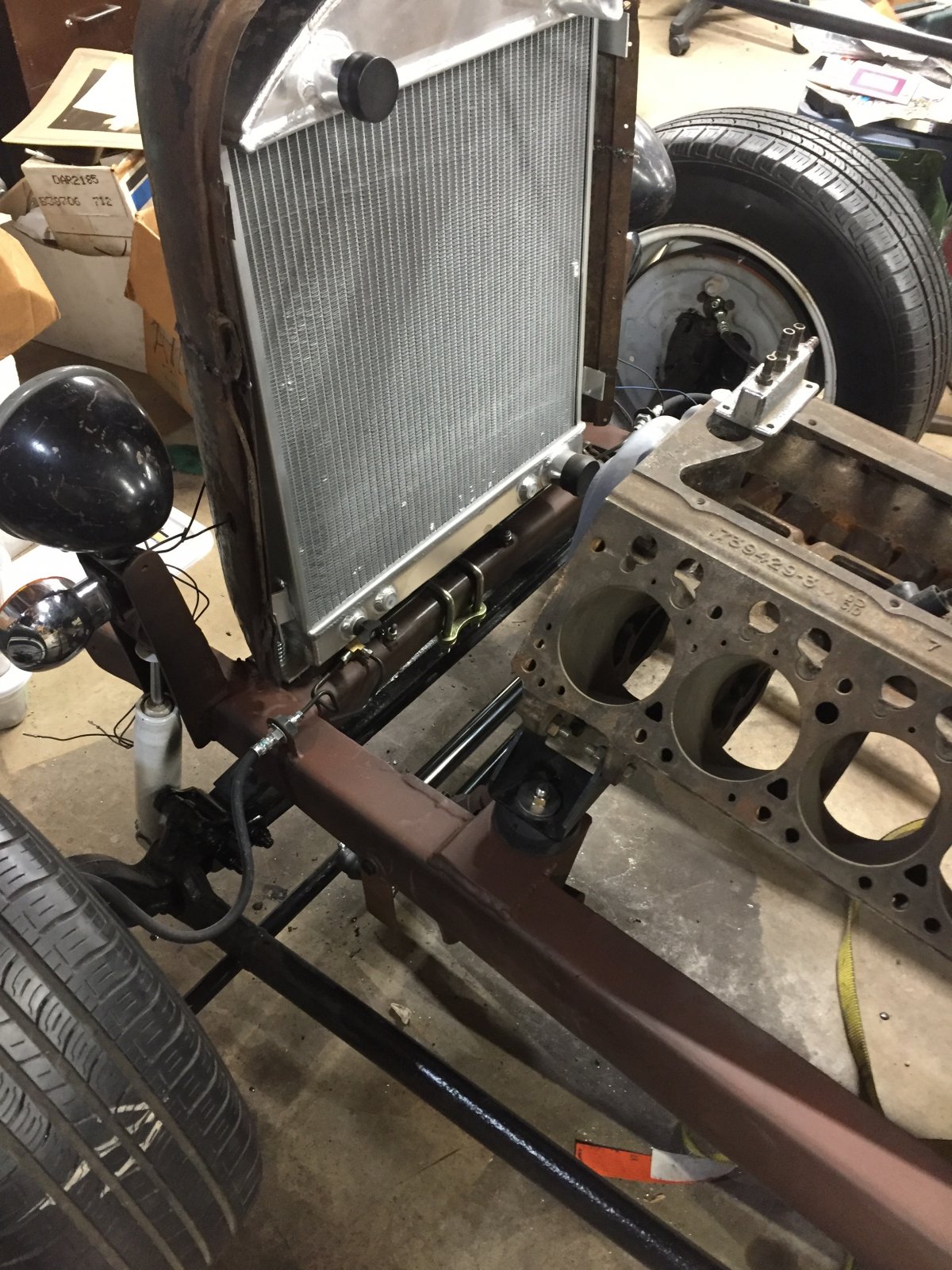

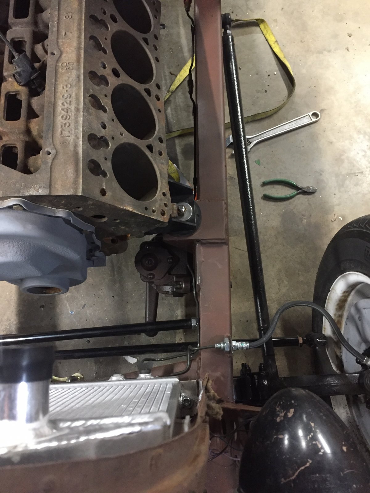

    My apologies for sure - the 4x4 chunks of wood are just a way of getting the engine out of the back of my truck and sitting somewhere.... out of the way! I do plan on dropping it 4-6" and setting back enough to cut into the firewall about 2-3".
    Mr. Strode, thank you for the up close picture showing the vega box sitting in line with the motor mount and my worries are unfounded - you can shoehorn all that into a tight space!!

    Having everything parallel with each other...???.....frame/suspension/steering link?
  13. gimpyshotrods
    Joined: May 20, 2009
    Posts: 24,630
    gimpyshotrods
    With cowl steering, yes, indeed.
    The theory of parallelism only is valid when you are using a 4-lnk front suspension setup.
    Even in that case, if the drag link is exactly the same length as the suspension links, bump steer can be induced at the first degree of steering away from perfectly straight.
    Parallelism is not at all valid when using a single-pivot suspension link on each side.
    In that case, the drag link should start at the steering arm on the spindle, and end directly over the top of the pivot for the split-bone, wishbone, etc.
    In both cases, if the drag link is exactly the same length as the suspension links, bump steer can be induced at the first degree of steering away from perfectly straight
    All cars, no matter the popularity of the builder, or how cool they look, that are built with cowl steering, and have a drag link that is parallel to the single-pivot suspension link have bump steer.
    Every single one.
    They are only made tolerable by building front suspension that just about does not work, or tolerating it.
    Don't believe me? Just ask:
    @Pete Eastwood (yes THAT Pete Eastwood)
    @Kerrynzl
    @Ned Ludd
    Each can confirm this.
  14. gimpyshotrods
    Posts: 24,630
    gimpyshotrods
    Now, for cross steering, don't weld the steering box mount in until all of the weight is on the suspension.
    Once it is, place the box so the drag link is as close to horizontal as it can be.
    As that cycles, that also will create minor bump-steer, so the link needs to be as close to the vertex of the arc that it swings in.
    littlemann and jimpopper like this.
