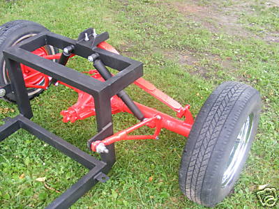

    I bought this Model A project from E-bay several months ago. I have since removed the motor, tran.'s and body. I have spent time researching old threads trying to find some insight to my suspension problems.
    The original rear set-up caused binding and has since been removed. I have included pictures of the current state of the frame/ suspension for your review. Please provide any input in regard to proper rear set-up options (4 link, shock location, etc) Pictures include frame verses suspension location (Distance between axle and frame is currently 14" in location that the suspension would attach to rear frame kick up.)
    Please provide any and all feedback / recommendations that would get me going in the right direction
    THANKS IN ADVANCE!
  2. fiftyv8
    Joined: Mar 11, 2007
    Posts: 5,401
    fiftyv8
    from CO & WA
    I would put the spring behind the diff and use a 4 bar and panhard rod set up.
    That would allow you to shorten the Zed which looks way to over done.
    The ride height lloks like it needs to be raised since it is not really the ride height as it does not seem to take into account any added body and engine weight etc.
    Take a tour of some earlier build threads posted by say "Stripper" for starters an see if you can take some inspiration and then post some more questions.
    I know there were some ch***is posts on T coupe projects so that would be another search point.
    Good luck and merry xmas.

    I would start over and build a new frame. From what I can see that frame dont look strong enough. Do you have pix of the car before you started to take it apart. Looks like the bottom of the body would be to close to the ground. I would rebuild it using a Pete&Jakes latter bar style rear with and different spring
    thats just my opinion

    That was the direction I was going, to use a 4 link and panhard bar setup but with only 14" from the frame to the axle I wasn't sure if the 4 link set up would work. Why would you put the spring behind the axle instead of over top as they currently are?
  5. To allow less kickup in the frame, as he said.
    But, that frame has some SERIOUS issues of strength. The right angles are ready to break, just add a small-ish bump, and it's flatbed time. Not to mention that 2 x 3 box is not really enough for a fibregl*** 'T', much less an 'A'.
    Get a real 'A' frame, or enough 2 x 4 box to make a good 'un.
    Cosmo

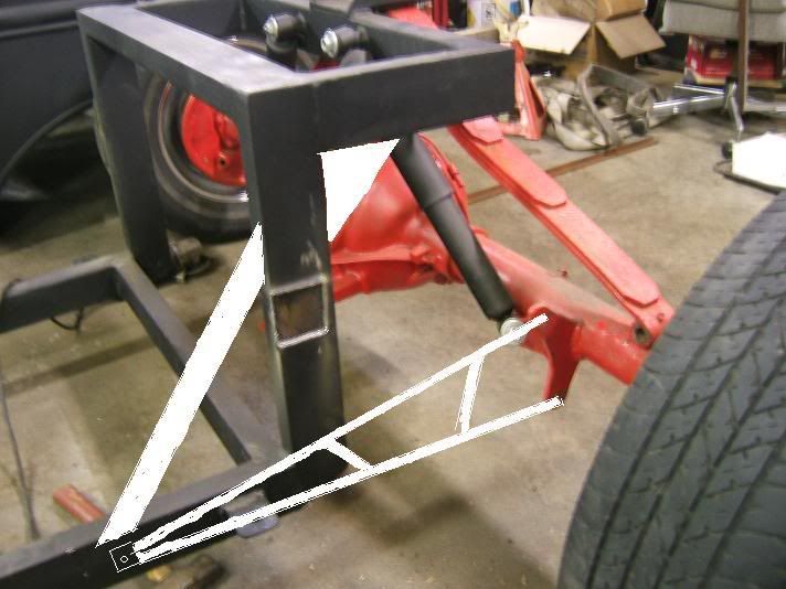

  16. QMOTOX
    Joined: Jun 8, 2008
    Posts: 89
    QMOTOX
    from STL, MO
    You said you bought a project!
    The ladder bars that were on it are way to short and as the rearend goes up and down it moves front to back a lot and binds everything up. The ladder bars need to be a lot longer with the front pivot mounted further forward on the frame. This minimizes the arc that the rearend swings through as it goes up and down.
    The right angle corners on the frame need to be braced. the botton corner on your frame looks only about 2" across at one point about ready to snap off. The way those ladder bars were mounted to the upright portion of your frame all the forces of the rearend were transfered to that very weak point at the bottom of the frame. Scary.
    The shocks also need to be mounted more upright. Layed over on a 45 degree angle like that they are only half as effective as they would be as if they were strait up and down.
    I took your pic and drew in some longer ladder bars and some braces to the frame so you can see what I'm talking about. I'd like to see some pics of the front suspension to see if it looks anything as bad as the rear. Boxed channel iron wouldn't have been my first choice for frame material either. Just judging by what you have posted here you may need to take a step back and look at this whole project you might need to think about a whole new frame.
  17. Docco
    Joined: Mar 23, 2007
    Posts: 286
    Docco
    from Ippy
    The **** end of the frame is all wrong, its no suprise it was binding up. I wrote a big long post on what you should do to fix it but without pictures it just sounded like a rant so i deleted it. Just do a hamb search and you'll find more than enough info on the right way to build a frame.
    which in your case may mean starting again.

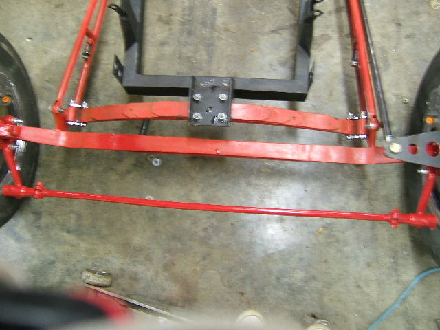

    Qmotox you ask to see the front suspension so here are some pictures. I do have some concerns here as well but I was focusing on one section at a time.
    Merry Christmas everyone.

  30. QMOTOX
    Joined: Jun 8, 2008
    Posts: 89
    QMOTOX
    from STL, MO
    I'll write a little more when I get home from xmas activitys. Do a search on ackerman angle and triangleated 4 link.
