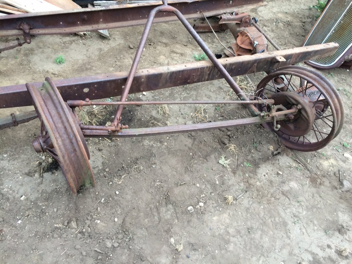

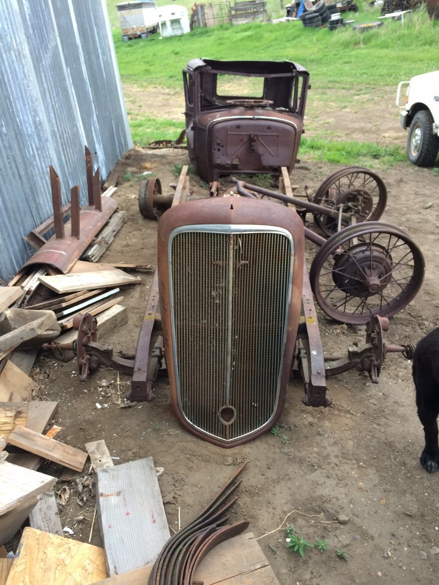

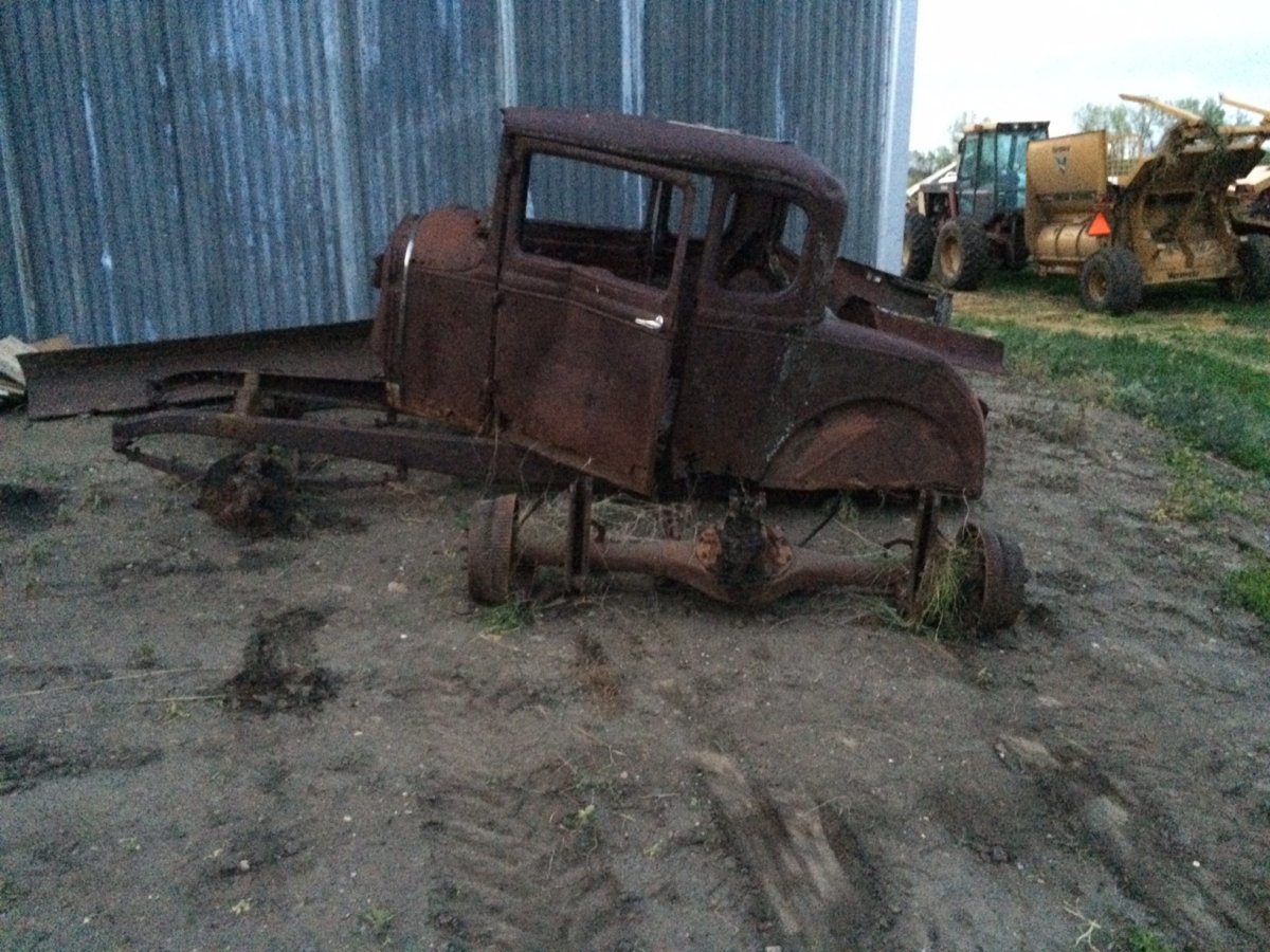

    Good morning! I'm looking to build a low budget model A but would like some advice for the best way to proceed. Pics below but I'll put the description up here.
    I have access to quite a bit of older parts. However they are almost exclusively truck parts. I have a chevy frame I planned to use for this build. the back part of the frame is chopped off which will be fine as i'll be using a modern rear end anyway. (If this turns out to be unacceptable I do have another chevy frame with an intact rear end, however it has been cut and rewelded together).
    I also found a ford front end from a Model A I planned to use with the chevy frame. My plans would be to cut the front suspension off and mount the ford suspension on the chevy crossmember. Would that be a good idea or should I entertain using the chevy suspension currently on it? I think it's from a truck so it would put the car up taller than the ford front end would. Basically, what should be my move here? Once I get it figured out I'll start a project thread.
    Also, while i have your attention, does anybody know if it'd be possible to reuse one of the chevy leaf packs for the ford suspension? And is it safe to use old leafs? Like, if I found an original leaf suspensiopn for less than a new one would that be safe? IMG_7529.JPG IMG_7520(1).JPG IMG_7529.JPG IMG_7533.JPG IMG_7535.JPG IMG_7544.JPG

    One low-buck approach would be to keep the leaf springs but use them to mount the rear end there. Then weld on a Ford style front crossmember and possibly frame horns to the other end and use the Ford front suspension there. Basically, reverse the frame layout front to rear.
    Probably will have to notch the frame and crossmember to clear the rear end or possibly replace the rear crossmember with something else.

  10. You have to consider the width of the frame before you begin to consider suspension. if it is the proper width then we have a starting place if not then we need to make it fit the body first.
    For the front suspension you have options given that the frame is the proper width, you can put the axle on top of the springs or get it dropped or both. If the frame is too wide which I suspect then your front suspension is out. You can make quarter elips for the front using the stock spring pacs but it is not likely that wither spring will be the proper width for a ford axle. With quarter elips you then have options Ford axle or truck axle.
    if you opt for a ford axle with a suicide mount then you can beef the truck cross member clip the frame horns and build your spring perch off the cross member, if you decide to go the Ford with a cross leaf then you really want a model A or model A type cross member.
    In the rear once you fit the frame to the body you have lots of options. I like a coil spring setup and that is what I am using on my A. Coil springs ( not coil overs) and ladder bars. But you also have the buggy spring setup available, I like a spring behind setup but many opt for the spring over on an A, and of course once again you could go quarter elips and build yourself a leaf link setup.

  13. Suicide front can allow you a lower stance but does not have to and gives you a longer wheel base.
    What you are probably going to do is use the side rails and form yourself up a proper width frame, you could even make it body width then taper it from the cowl forward to an A cross member. yes you can use an A cross member in place of the GM cross member and hang your suspension off of that. ;)

    Just an idea, narrow the chevy frame to fit the body and keep the parallel leaf front, remove some leaves, maybe z the front frame. Z, Depends if you channel the body over the frame or want an exposed frame rail.
